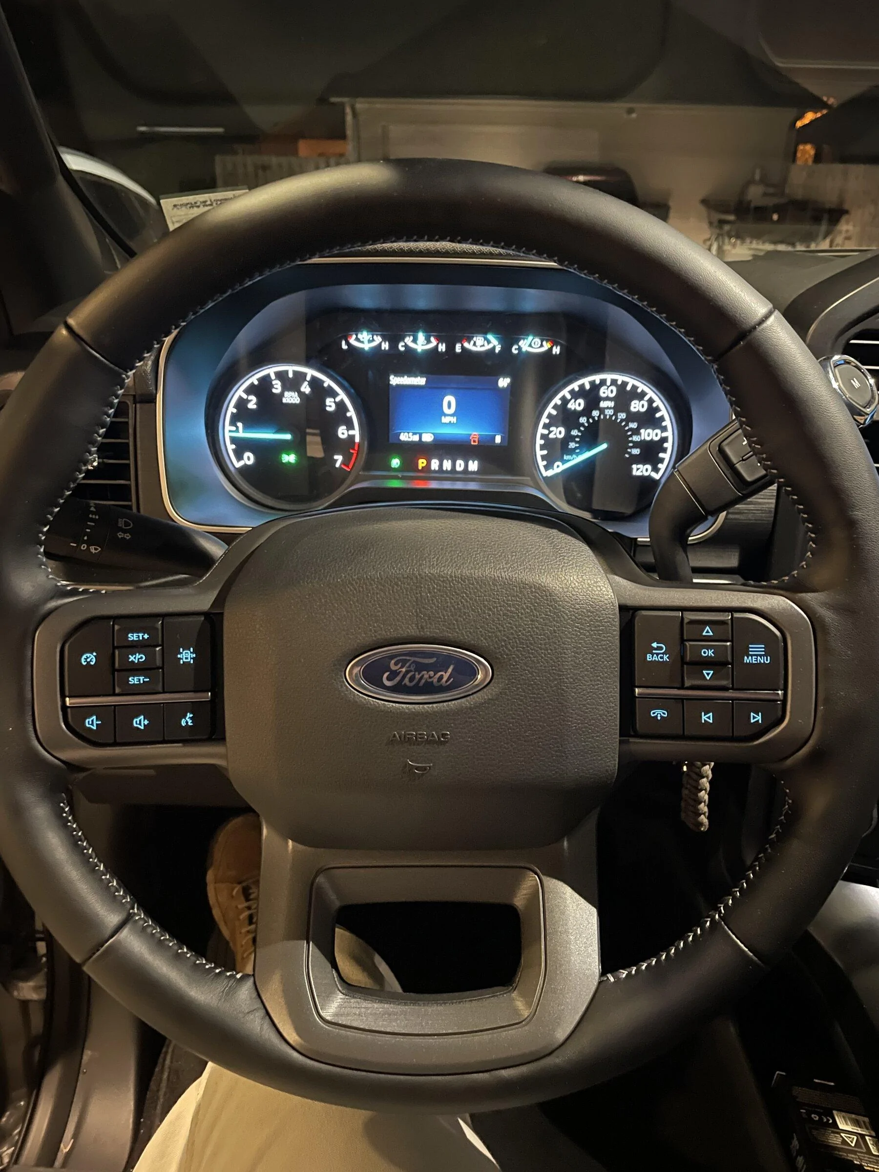

So it might just be me but I love a leather steering wheel and as we all know the STX does not come with one. So I purchased one from boosted grey goose and so with 30 miles on the odometer, the following magic took place!!!
Let me know if you have any questions!
Ps the clips to release the airbag suck

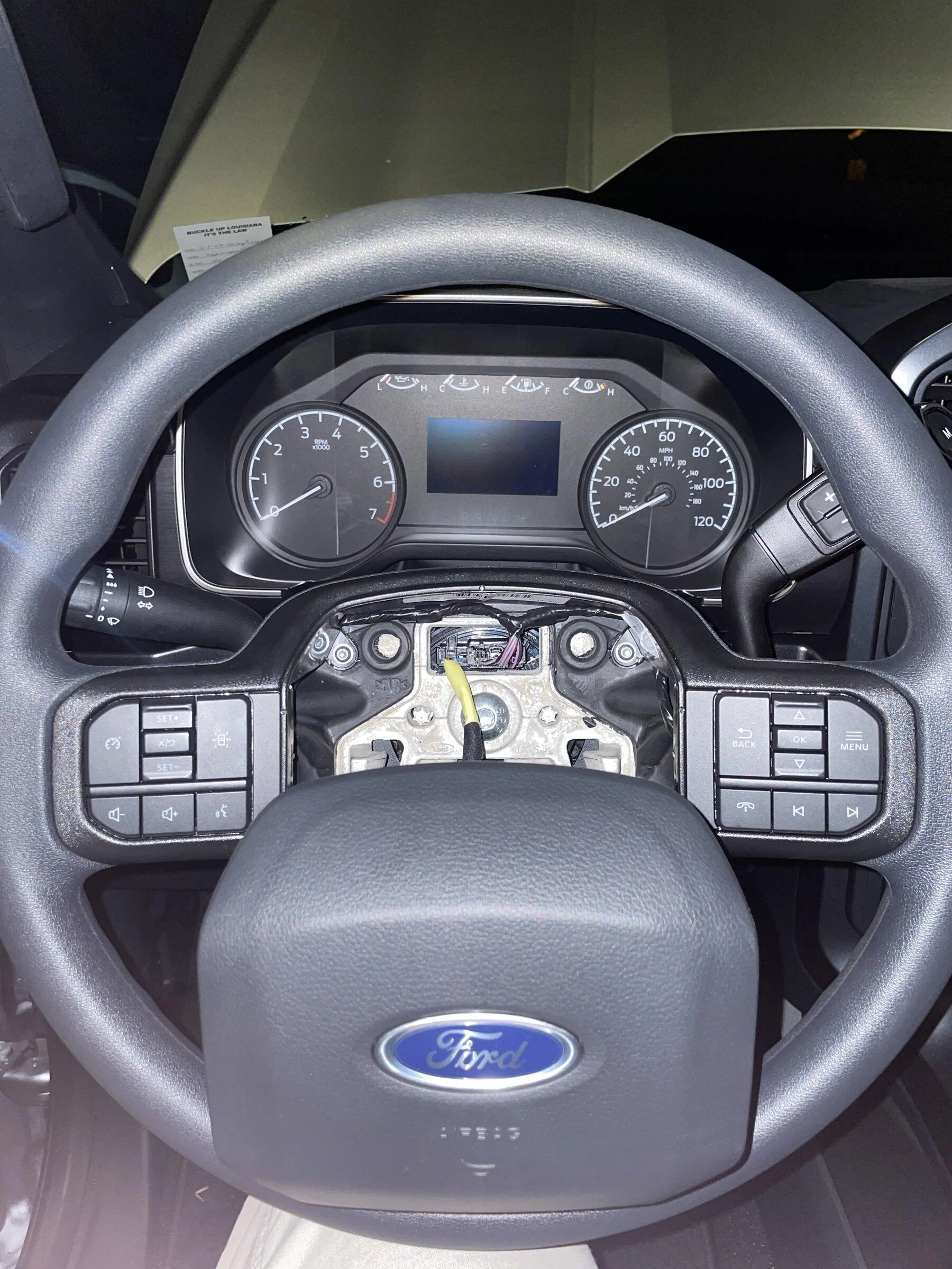

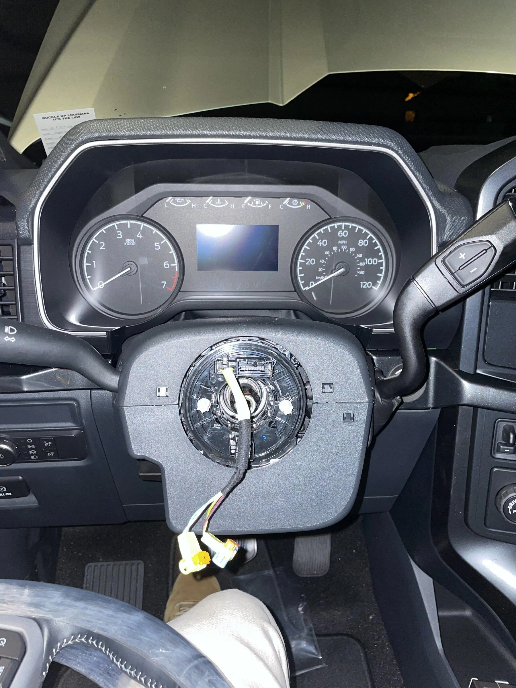

Sooo I should have taken pictures of the backside but essentially you have to take a flat head and with the battery still connected turn the wheel 90 degrees, then you find the hole on the backside of the steering wheel, you have to push down a little metal clip that will release the airbag. I found once the first one is release if you take a non marring plastic pry tool and apply pressure it will release the second one easier. Once its releases you can then disconnect the battery and finish removing the steering wheel. Just keep in mind the bolt holding the steering wheel on is a T50 and not a metric or standard bolt so be careful.

So I purchased it from cmo_5.0 on Instagram not sure where it came from but it was direct swap
