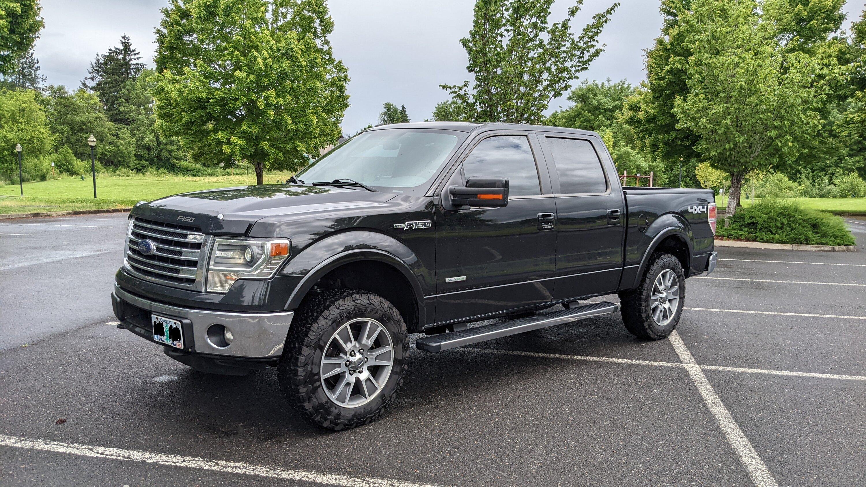

This is my 2014 with the same 2" front level pucks installed (and on new 33" KO2s)
