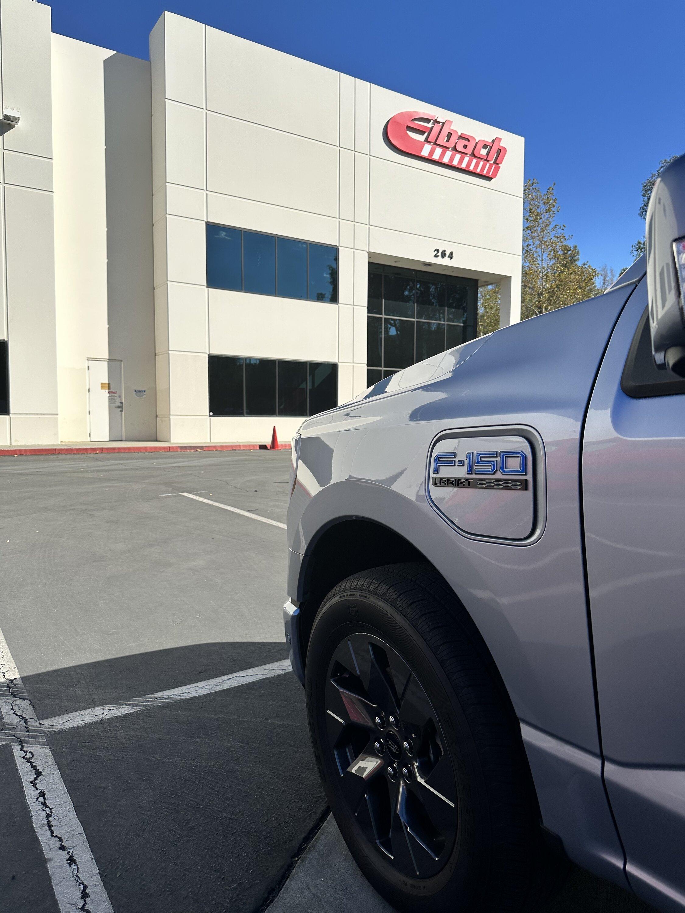

I was contacted by Eibach for R&D on the Lightning. As of now they will be working on a lowering kit, Stage 1 leveling kit and Stage 2 lift.
I will post updates here as they come. They will have the truck in their possession for about a week.
Let me know your thoughts on what needs to be addressed so I can pass it along. I know one the main ones is the BOUNCE after some dips at speed.
26 Sep Dropped Off for R&D

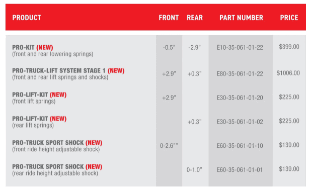

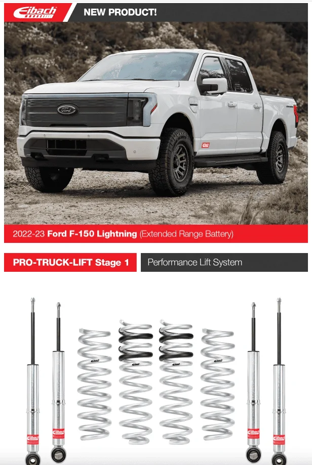

Eibach's latest announcement for Lightning - Stage 1 Performance Lift system:
Ford F-150 Lightning Eibach R&D for Lightning lowering kit, leveling kit and lift kit -- submit your input Screen Shot 2024-01-12 at 2.12.59 PM
In addition to lift, they have the lowering springs (Pro Kit).
Ford F-150 Lightning Eibach R&D for Lightning lowering kit, leveling kit and lift kit -- submit your input Screen Shot 2024-01-12 at 2.17.13 PM

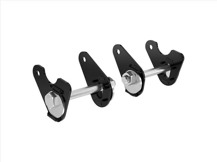

So is the verdict here still that you need the Icon camber kit if you go with one of these Eibach lift/level/lower products?
F150ROD
F150ROD
Apr 14, 2021
121
3,619
4,483
U.S. Navy Retired
Level and lift you should be able to align back to stock specs. Lowering not so much.

Haven’t seen this answered but is it possible to go back to stock ride after doing the icon camber mod? Of course the cutout will still be there but can the truck ‘effectively’ be returned to stock ride?
csukoh78
Nope
Jul 30, 2023
290
480
SE USA
2023 Ford Lightning Lariat ER
Of course. The camber kit range of operation completely includes the stock pin setting. Instead an unadjustable hole from the factory, the camber kit allows sliding up and down. The factory hole is about midway on the range of the sliding bolt. If you go back stock, just get it aligned. They bolt it tight, and it stays in place.
