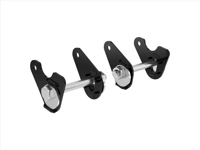

What do you have against the ICON rear camber kit? I get a good price on them.
brtnstrns
Jul 23, 2023
54
Seattle
2024 Lightning Platinum; 2022 Polestar 2 LRDM
May just be the fact that you have to permanently modify the truck's frame.
That's a turn-off for me, personally. I'm fine with permanent frame modifications for significant suspension changes on a high performance vehicle, but for just mildly lowering the rear of a $80,000 pickup truck, it feels extreme.

I have a few Icon rear camber kits if anyone wants one.
https://www.f150lightningforum.com/forum/threads/22-23-lightning-rear-camber-cam-kit-by-icon.17374/
Eibach is estimating another two weeks on the lowering kit availability. The first batch is going to be small. Send me a PM if you want a set and I'll see what I can do.
Want to get this for my lowering springs but really don’t want to modify any structural pieces, even if it is just a quick drill. This sucks.
It’s funny as you get older you less likely to do mods that require modification to anything OEM lol

I agree, if a simple bolt on solution was available it would be ideal.
A bolt on kit will almost certainly not happen because there isn't an existing camber kit on the truck already. It's modified for fixed camber, and to increase camber as there is more weight in the back of the truck to increase stability. It literally splays the wheels wider when carrying a load. Obviously to correct the camber permanent modification is going to be needed which is what that kit offers.
