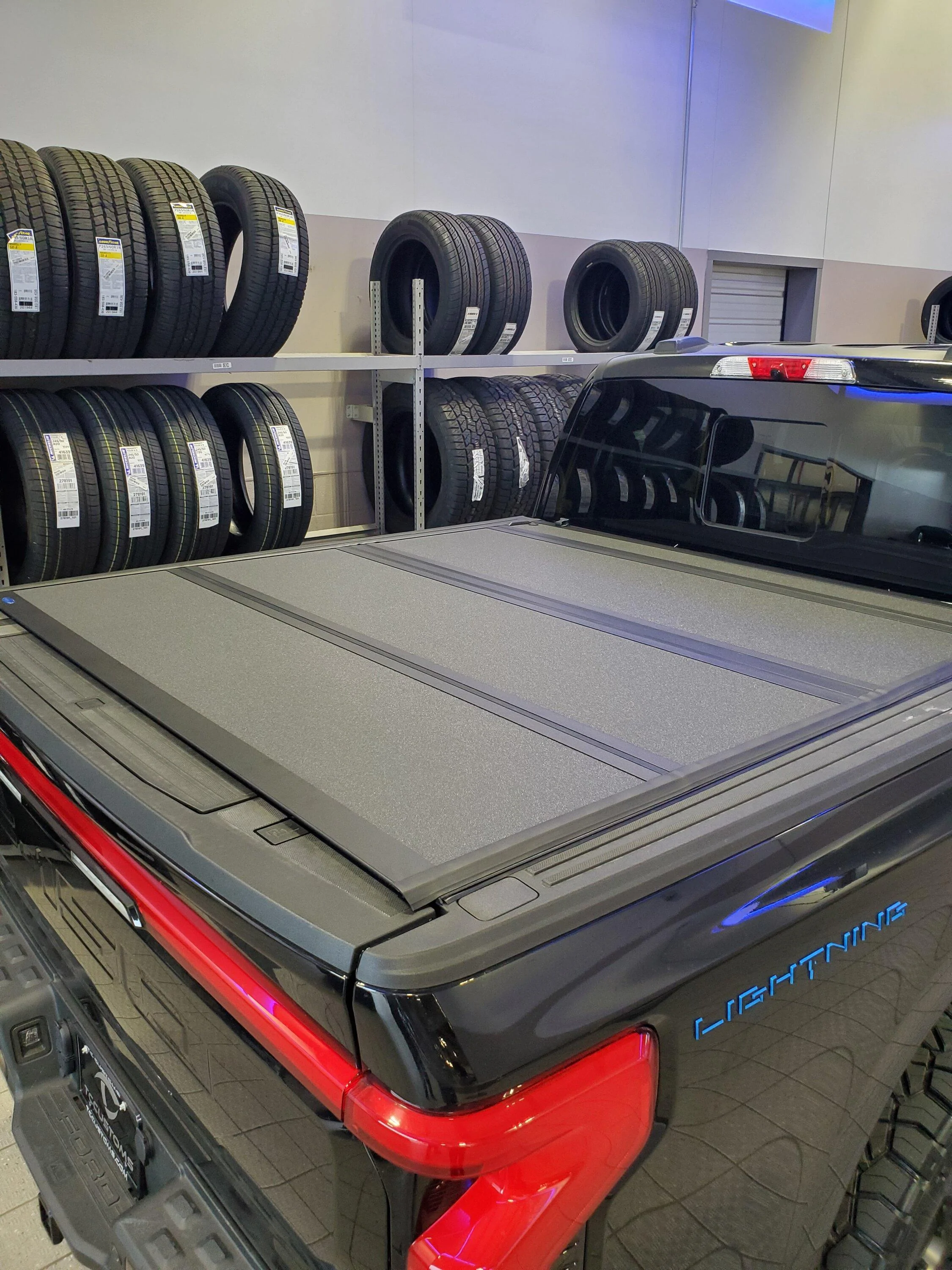

We just leveled one with 34" Nitto Ridge Grapplers on Black Rhino wheels using Readylift 2"standard kit with no preload spacers. I don't believe you can go any larger than stock without the level. With the level and no cutting or removing intrusion bars we were close but had no scrubbing when using our standard QC process. Driving feel and ride did not change.
An interesting note is the tire/wheel combo weights. Factory assy was 73 lbs. Our custom assy was a whopping 98 lbs. We basically added 100 lbs of non sprung weight.
Shock assy from the Lightning appeared exact same length as a stock assy when we compared them. As expected the coils did appear beefier but had the same number of twists.
We also accomplished speedometer calibration using a Hypertech in line calibrator. Installation was no different than any other previous ICE build and was verified accurate. We really like this calibrator because it causes absolutely zero issues with normal PCM programming. That is a big plus if you ever have to bring truck in for programming of any module. Stand alone programmers almost always cause problems with the IDS and FDRS software that Ford Technicians use.
Range test before build has already been posted to Town and Country TV on You Tube. Mitchell will be posting the complete build and range test post build as soon as video production is complete. We will also be installing a bed cover and performing a range test then as well.
