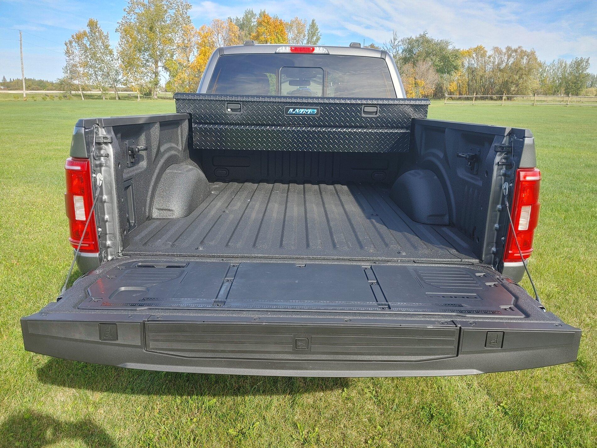

Dealer sent my truck to a local truck outfitter and they did the spray in bed liner and around the tailgate without removing the bolts.
