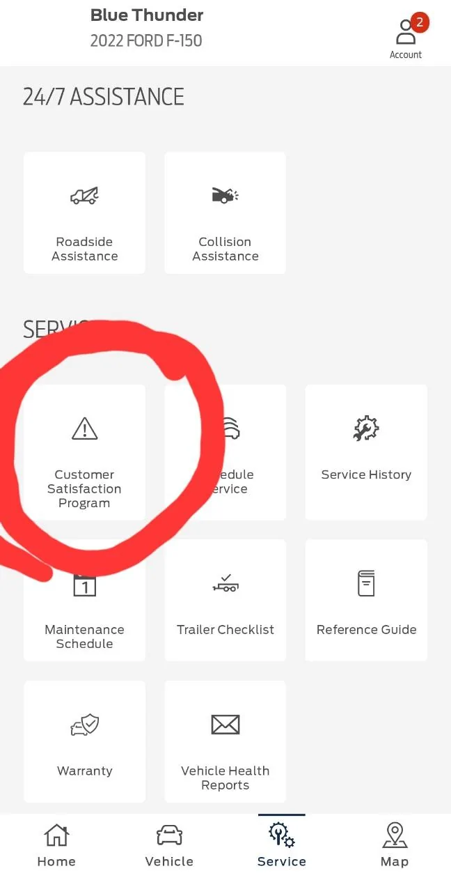

Did you look at the service tab of your Fordpass account? It will have them listed there.
Any applicable for your truck should show up in FordPass and Oasis.
Thanks for that, whole service tab.. who knew??
I have the wiper and rear light bar recall, and the dash mat and battery csp.

TSBs aren’t tied to a VIN like CSPs & recalls.
There are others, headlight switch comes to mind. I learn about them mostly from this forum. Try a search for “TSB” and select “Titles only”.

TSB's are not meant to be preformed unless you have a problem associated with the content of them. That's why they aren't tied to the VIN. They just give the technician a reference to a known solution to a problem the customer might be having.
