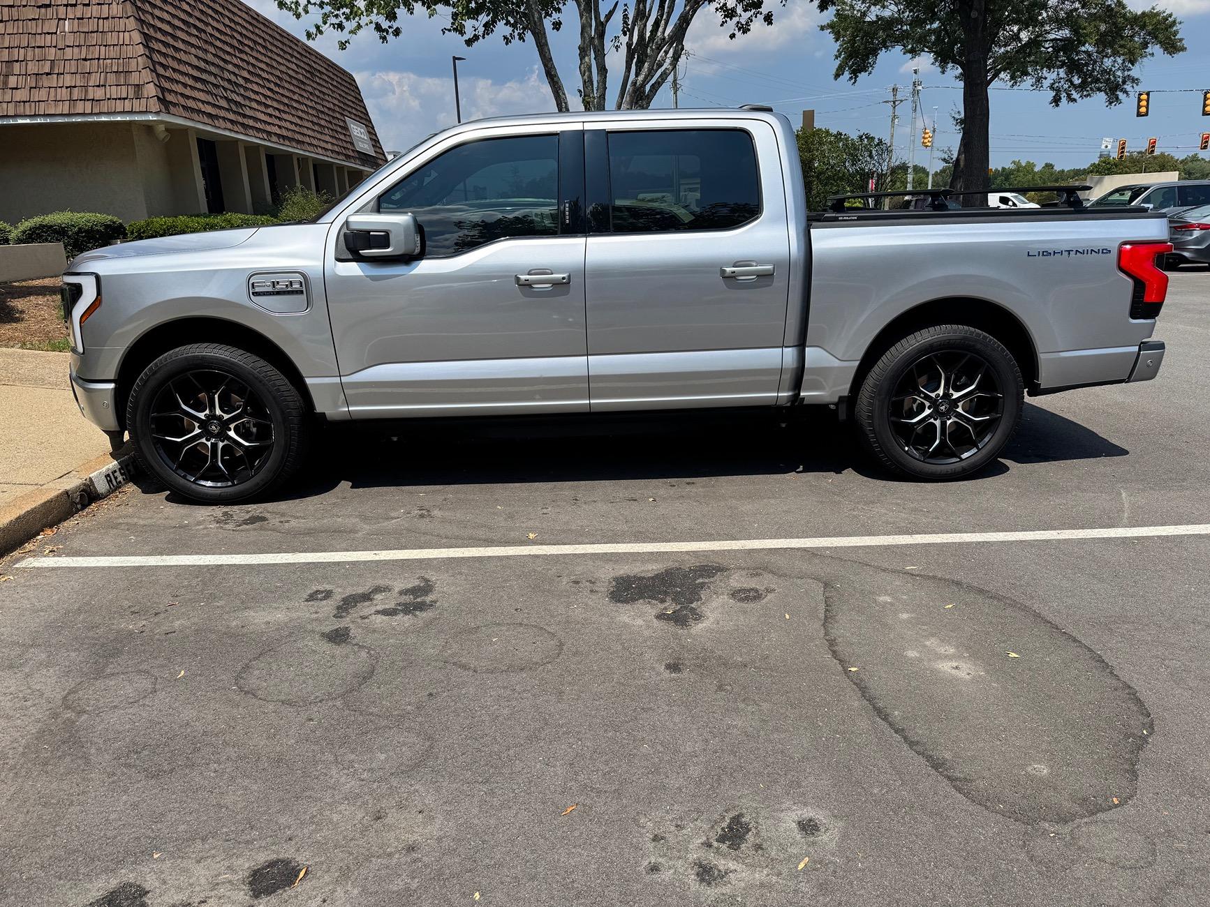

I just picked my truck up from the local suspension shop. I had them install the Eibach Pro-Kit Lowering Springs with the Eibach Sport Shocks and a Hellwig Front Sway Bar. I also used the Icon Camber kit to get the alignment right. I had to come straight back to work, which is on the same road, so I wasn’t able to get a feel for the difference in ride. I definitely like the look an how it sets. For those that don’t know the specs on the Eibach Pro-Kit Lowering Springs, the front dropped 0.5” and the rear 2.9”.
*UPDATE*
Driving home was a blast! Body roll is almost non-existent. Also, the torque steer under hard acceleration is completely gone. You feel a little more of the bumps in the road but the ride improvement is well worth it.

Nice! Can you get a few more angles? Are the lines level or does the rear squat?

How much did this set you back?
The parts cost around $1850 and I paid $1200 for installation and an alignment. I had them install the sway bar since they were under it anyway. The most time consuming part of the install is the camber kit. It takes around 5-6 hours alone

Have you been able to use Blue Cruise? I was under the impression it would not work if you do this. I put in the Eibach Pro shocks but kept to the original ride height and haven't put in the springs. It made driving on and off-road much less bumpy and reduced sway during turns as well. I'm very happy with the ride now.
I used it this morning without any issues. The front only dropped 0.5” so I don’t know why it would be an issue.

Re-aim headlights?
No, I have had absolutely no issues with anything since lowering it. I haven’t checked the bed scales but I’m sure they are off. I haven’t checked never used them so I don’t really care.

I actually asked for the people your going to be facing at night. leveling the truck moves the aimpoint of the headlights up.
Whammy Bar
May 30, 2022
488
751
1971 F100 + 2022⚡Lariat ER
100% agree - they'll need to be adjusted.
OP, don't be that guy that drives around blinding people like a Tesla owner.

Looks great!
I'd also love to see some more pictures with different angles!
