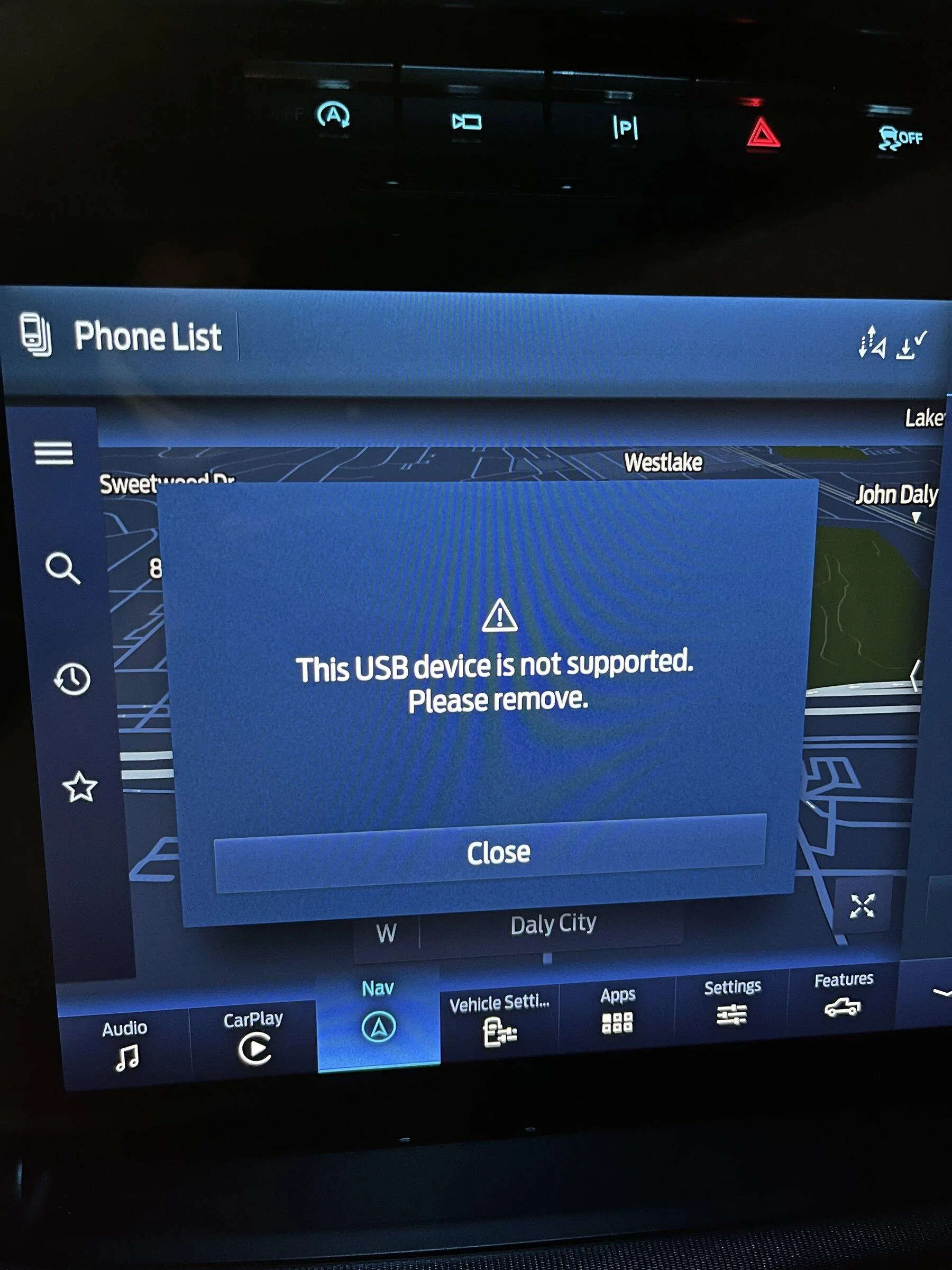

I got a new iPhone and picked up a MagSafe charger for my truck. It is a USB-C plug and every once in a while I get a warning on the screen “This USB device is not supported. Please remove.” Still works just fine…
Has anyone else seen this?

Yes, mine pops that up too and I just ignore it.

Does a usb c to lightning work ok? I wonder if it is the usb c or MagSafe that is the issue.

I received that message too. I changed to an Anker charger and no longer get the error.

although you haven’t provided enough details I’m guessing you are using a port that is used for CarPlay (data) hence the warning.

I've had similar issues with past vehicles. It was always resolved with either replacing the cable or cleaning out the lint/dust that got in to the charging port of the phone.

I use the Magsafe charger, but plug in inside the console, no pop up messages.

I had this issue, tried two different chargers and happened with both. I think it's due to the USB looking to receive data, like carplay or music. I plugged one into the center console plug because I just need power and get no messages. I like this location better anyways bc I can put the phone in the slot next to the shifter and hookup the magsafe when needed. Better then reaching down into that small area.

If you’re plugging into the front port in the front console under the radio, it’s for media connection and will give that warning when any charging device is plugged in.
