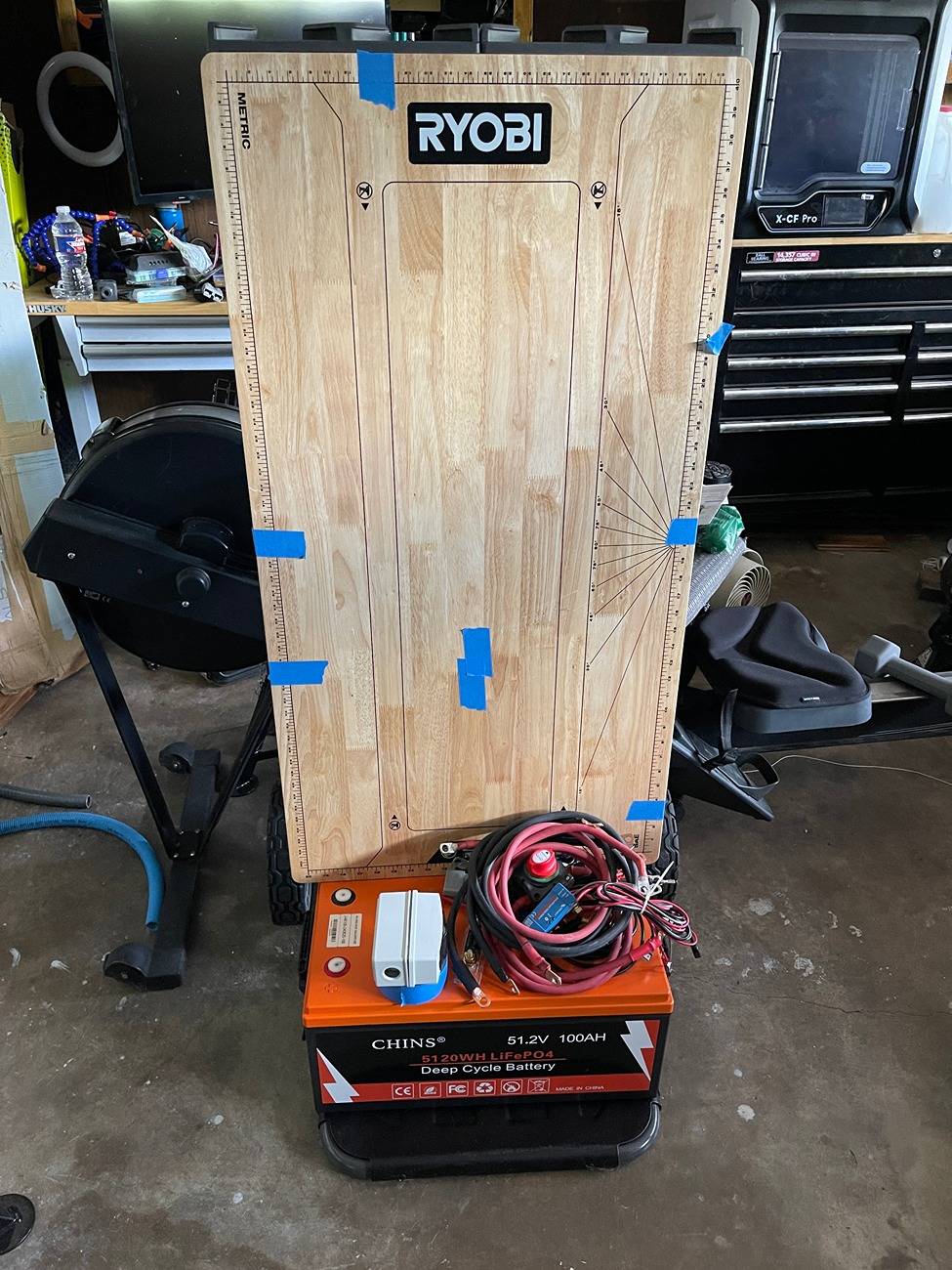

Starting with a Ryobi convertible workbench/dolly, which conveniently, should fit most of the components, but also should be pretty unwieldy. We'll see. It'll hold 400lbs, and we're only at around 200 now.
Ford F-150 Lightning Mobile Overlanding Charging station build with Victron this time diagram
ON the bottom of the Dolly tray we have a 48v, 5kw Battery currently. We'll see if it works or if we need a second one. This takes the home system up to 15kW when it's tied into the system.
