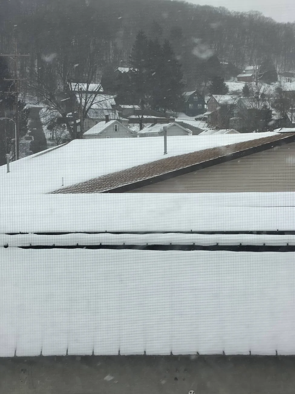

My garage has a separate meter and load center, not connected to my home. The garage roof can only hold 12 solar panels, I wish it could have more, but its geometry has restrictions. It's been online a little over one year and It is grid tied with Net metering. No battery storage in the garage, other than my truck. Only have the garage door opener, some lights and tools in the garage. No other loads, like in a house. In the past year of operating, it generated about 5000kwh of power. I figure that is about 10,000 free miles of driving for the year. The system cost around $15,000 to get installed, and less the 30% tax credit, a net cost around $10,000. My truck's efficiency is around 2 miles per khw of power, year round. That is like 10000 free miles of driving or about $2500 in gasoline. I figure this will be paid off in four years. Right now the roof is covered in snow and not generating any electricity. In the summer it works really well.
We got hit with snow here in North Texas. About 5 inches so far which is not common at all. My panels were covered just like yours but I still pulled in 14KWh's today. Not great but considering it was really cloudy and this was all from the backside of my panels and reflective light I will say its pretty impressive. Batteries are at 50% right now so we should make it through the night without pulling from the grid. I plan to sweep them off in the morning tomorrow because we are going to have another cloudy day and the snow is not going anywhere.
