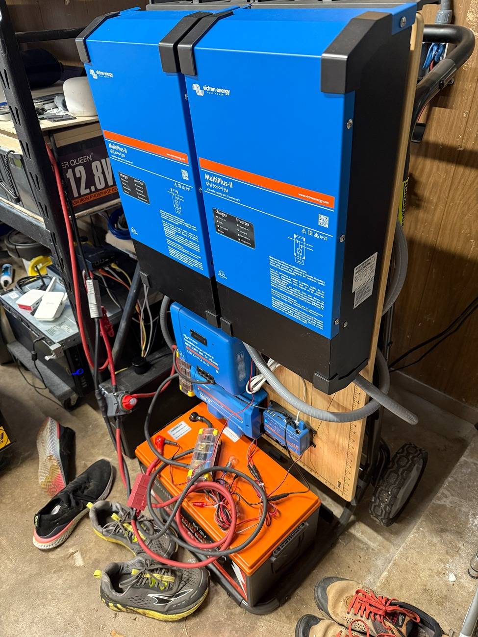

Nice. Like seeing others doing this too. Makes so much sense in the long run.
Our much smaller system, after now switching our system to Victron components, is about 10% paid for after a year. (about $6k after rebates). 15kw of battery, 5kw mobile of it mobile, on the handcart. 3.6kw of used panels charging.
We can only charge at a max of 16amps, but since we both work from home, and only average about putting 6-7k miles on the truck/year, works out great for us. We can put as much as around 50 miles back in a day. Also powers the mini-split in the garage, giving me my temperature controlled man-cave.
