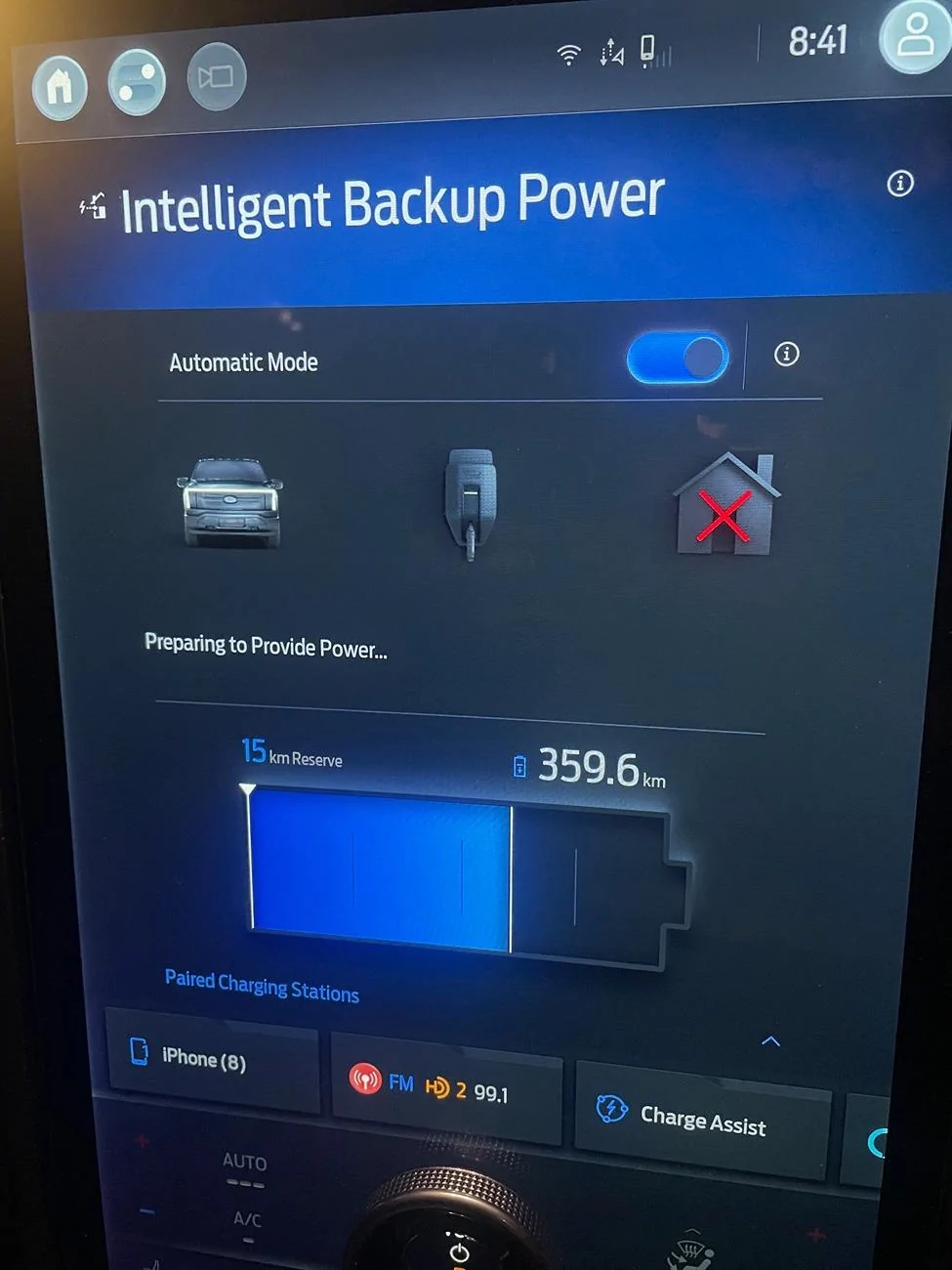

The truck does know that power was cut off, and immediately displays "preparing to provide power" so I believe that they are talking correctly.

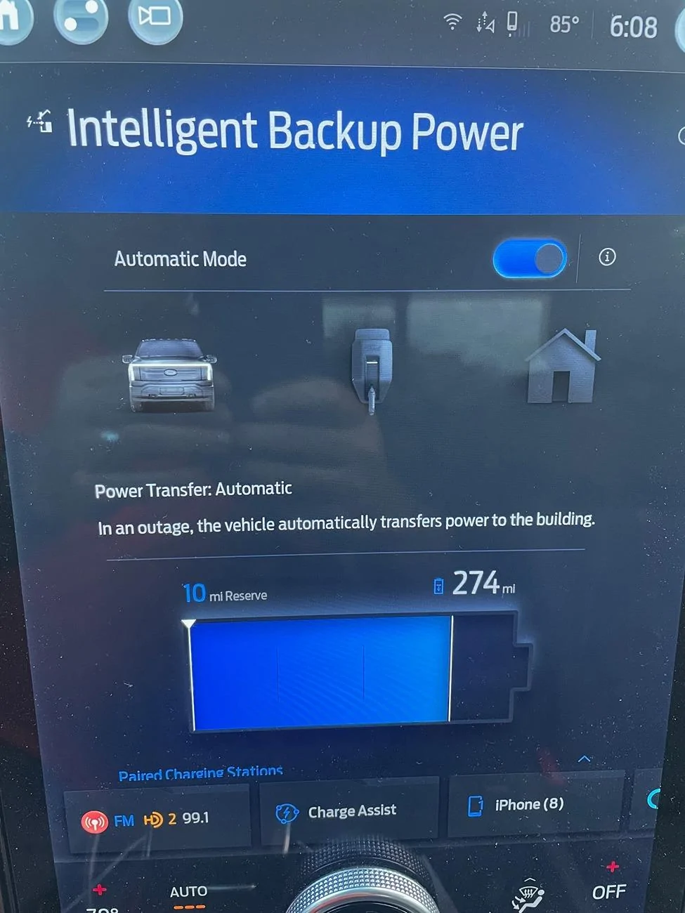

Before I go chasing bluetooth issues, can someone confirm 100% what the symptom is?
When the power is on, or the charger is not plugged in I get the first screen. When I go to grid-down mode, and the cable is plugged in, I go to the second screen which is "preparing to provide power"
