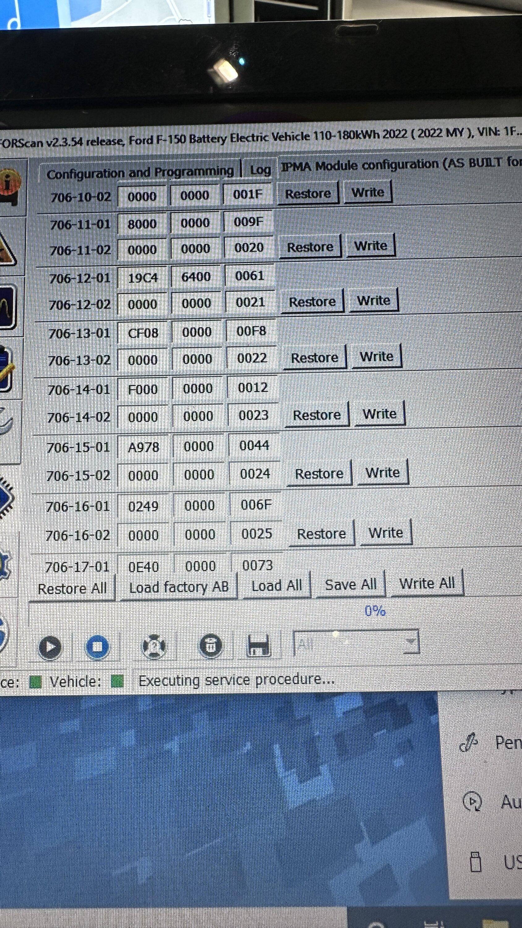

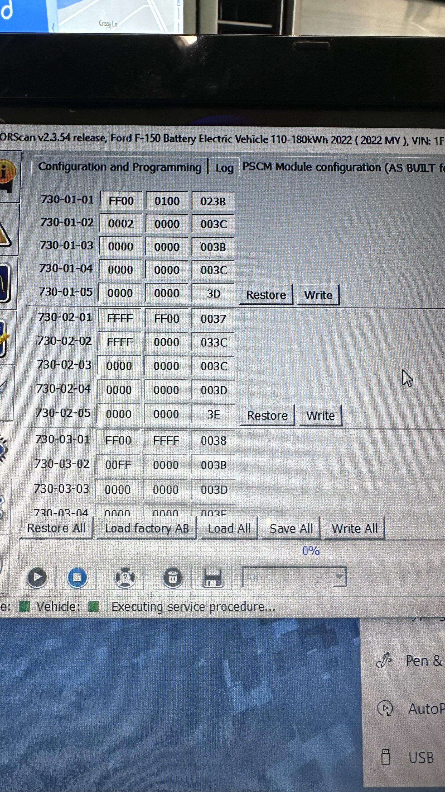

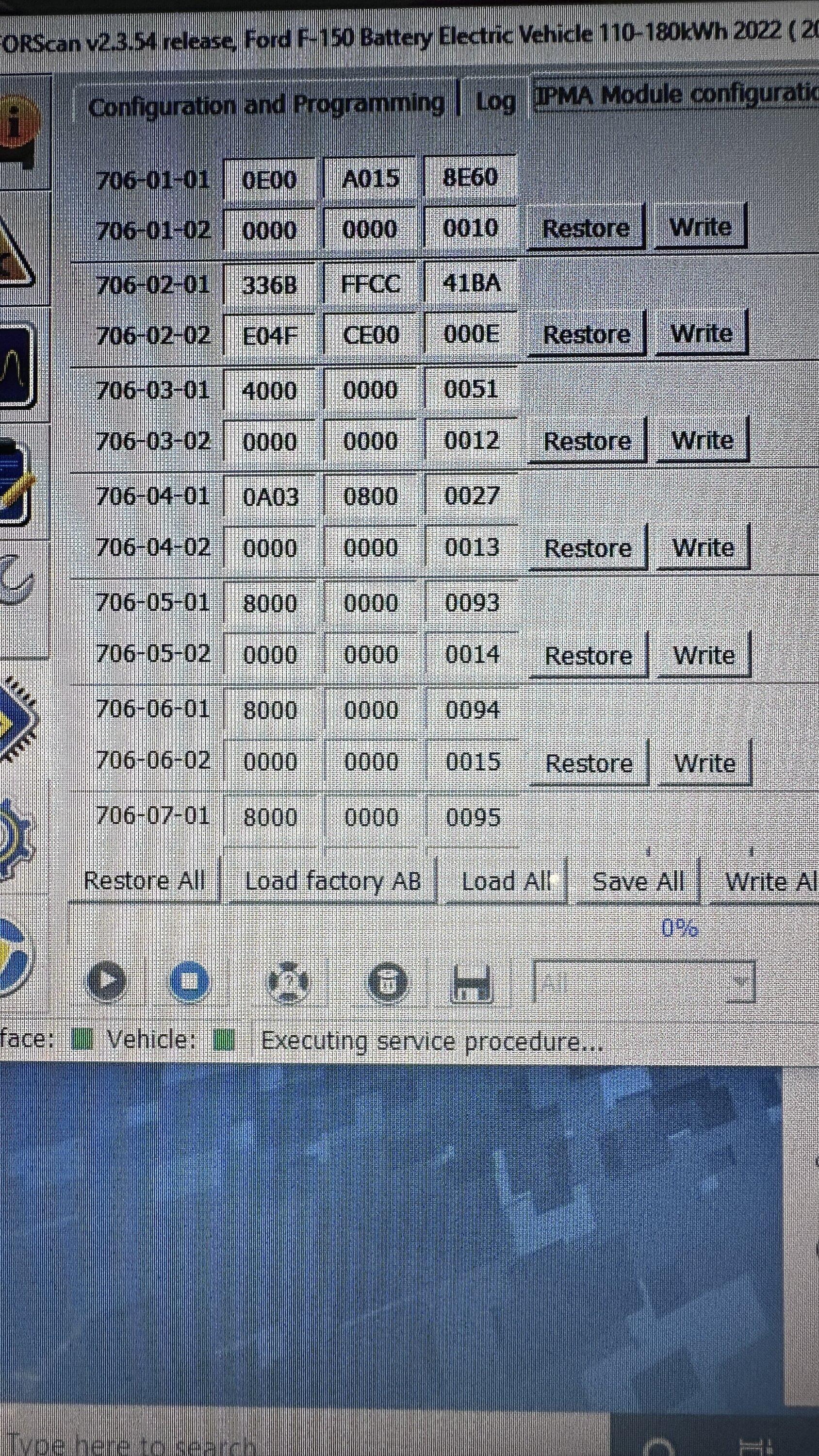

there are others who have either purported to 'have' run the wires and installed everything successfully, or they are 'thinking' positively that they can... I'm not sure which. They may not realize what you are now realizing...
