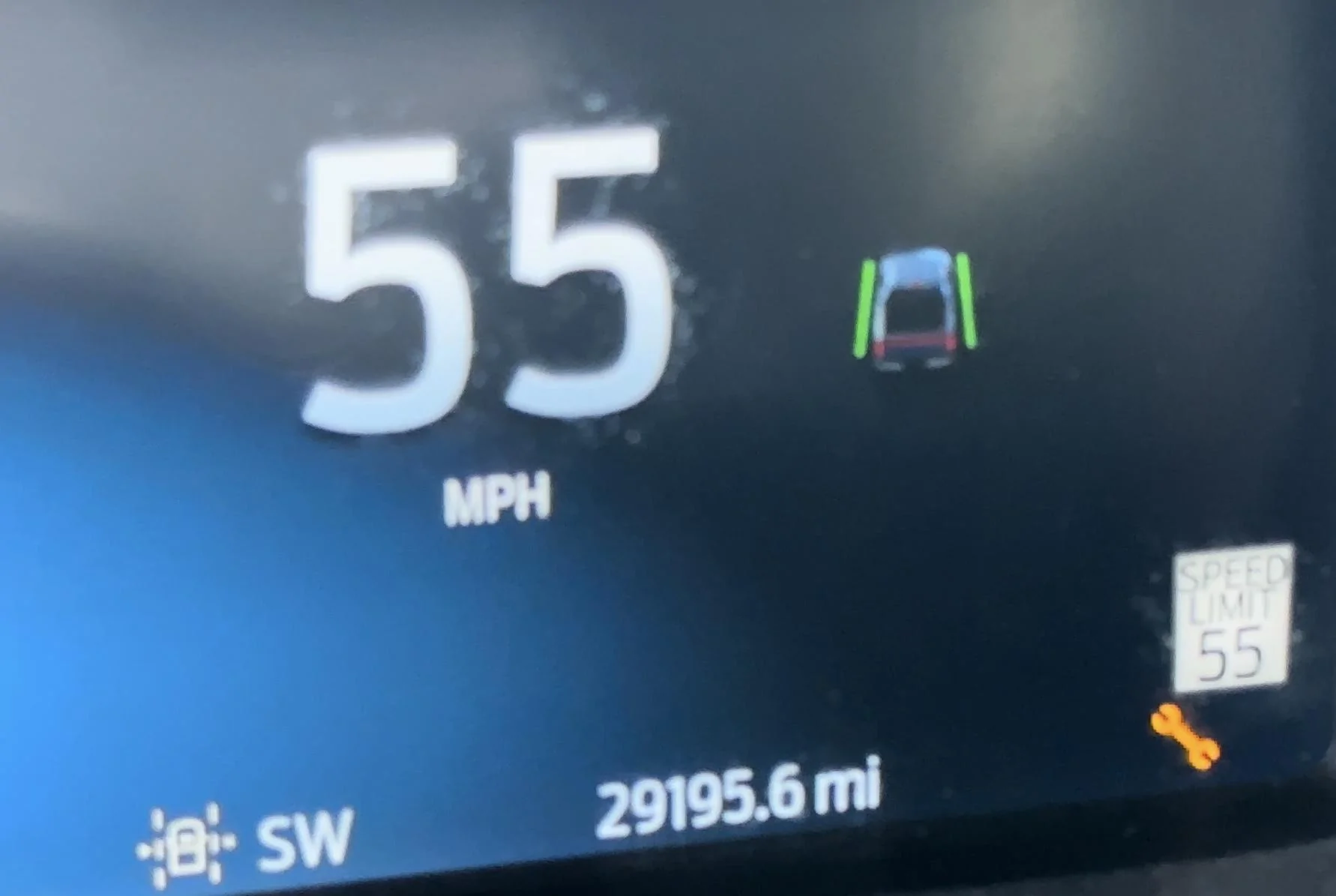

This happened to me this morning leaving my house to go camping. Again at electrify America after charging for my last stop before hitting the trails. But, I got this nasty wrench saying service engine soon. Since I got left stranded before I decided to turn back and will go out tomorrow morning in my Bronco.
