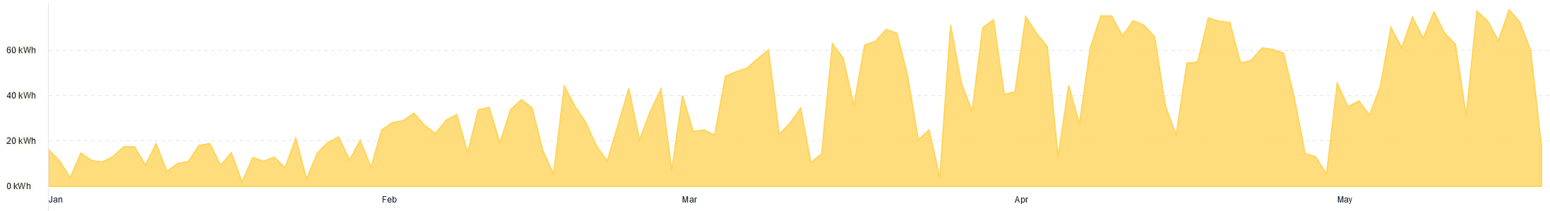

Nice and simple setup. I currently have 46 panels on my roof, and through a set price PPA. Unfortunately mine is considered inefficient since the panels are not facing south, but I still manage to get a more than decent amount of power regardless.
Ford F-150 Lightning Off Grid solar charging station is up and running.. weather permitting! Screenshot 2023-05-21 100823
I want to do what you are doing, but that would mean I need to change out the inverters, and that would be a "violation" of the PPA contract. So I would need to find a way to funnel the electricity from the solar production to a battery, and just feed off the battery for the EVSE. However since its all tied together, there would really be no way of me breaking things up.
