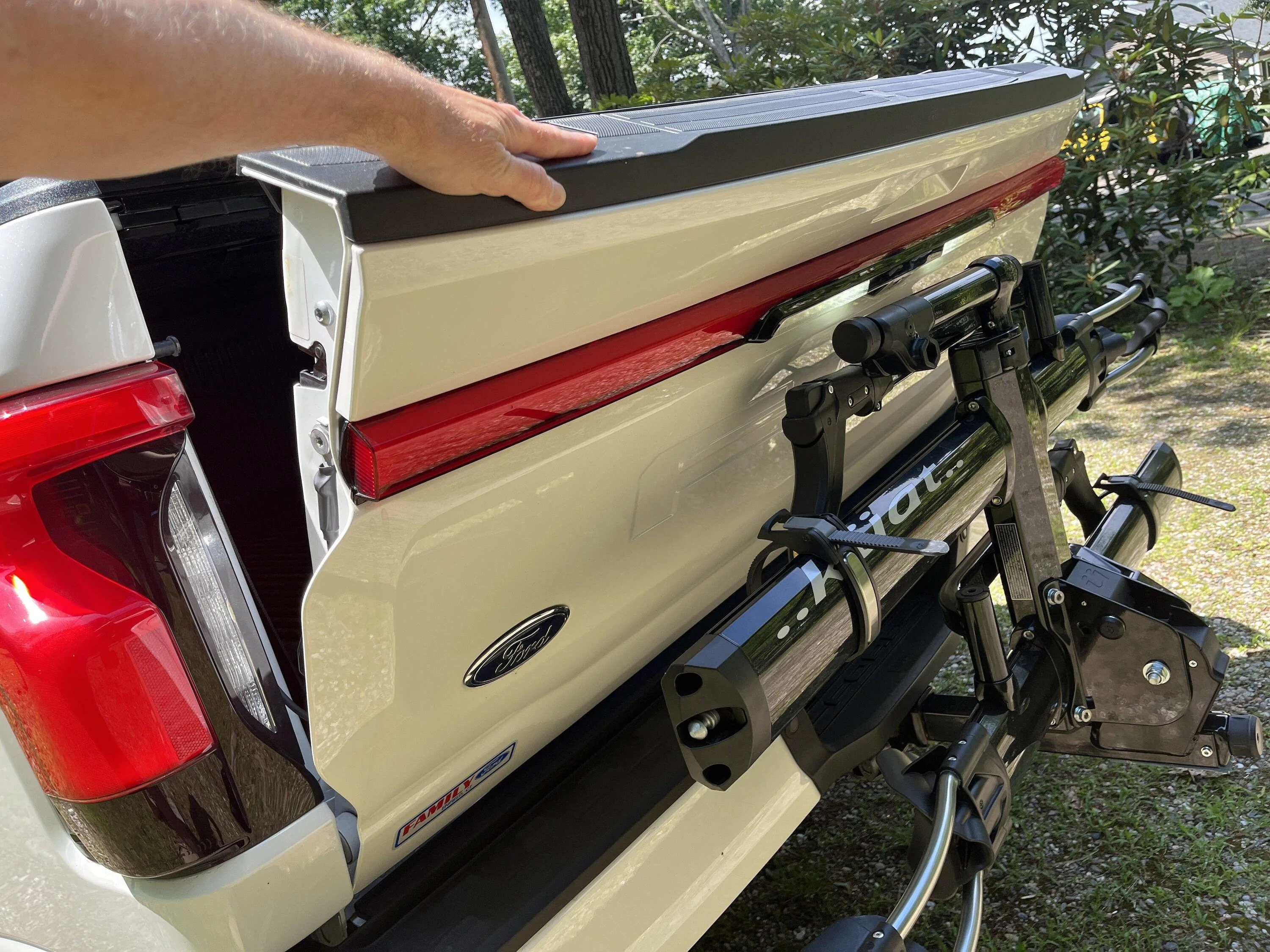

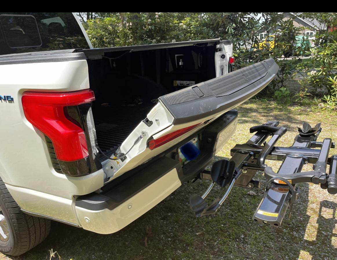

Looking to see about Disabling the button on the key fob and the dashboard, so that the tailgate isn’t accidentally opened, ( in my case to avoid the tailgate from banging into a trailer hitch mounted bike rack).

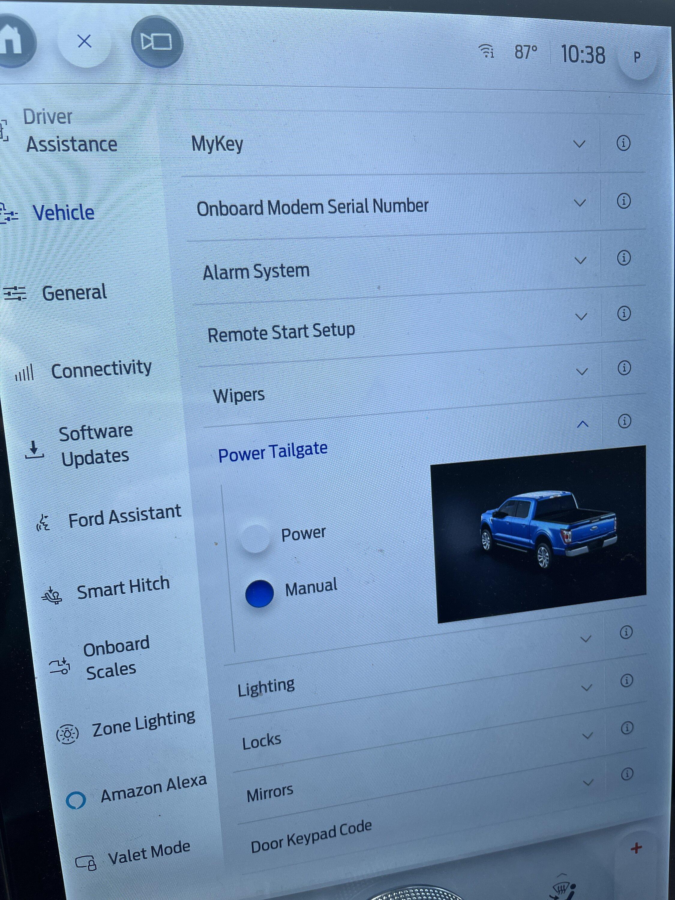

There is an option to turn off the power tailgate and revert to manual. There is a toggle switch under controls on the sync 4 screen

thanks for the tip. I hadn’t seen that before in the controls menu.
I tried it and it seemed to work fine for disabling the tailgate opening button on the dash….but not on the key fob.
when I tested it, the key fob overrode the setting selection to manual that I had made for the tailgate in the menu.
it’s the key fob I am concerned about the most, in accidentally hitting the wrong button on it, and having the tailgate open up into my bike rack.
anything I could be doing wrong?
or is there another disable setting specifically for the key fob ?

It also would be so you can't open it when you know something is in the way, and it may not sense that.
yeah that’s my dilemma, a bike rack that the sensors don’t sense, and so the truck would lower the tailgate right into it, if the power tailgate were accidentally activated, damaging both the tailgate and the bike rack.
