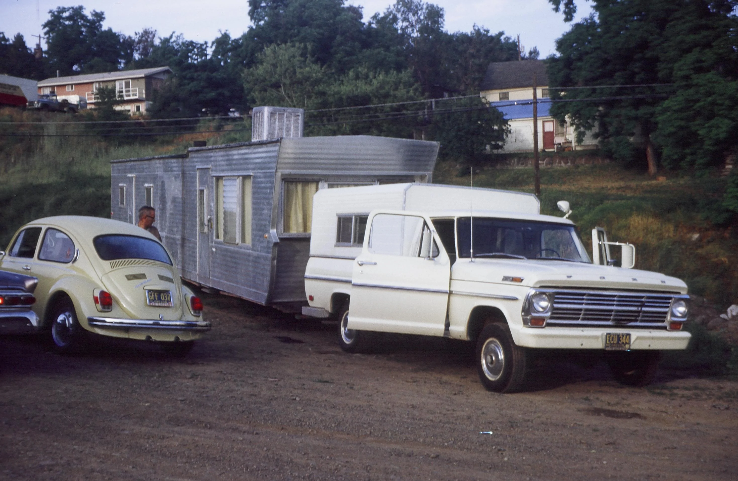

Ford F-150 Lightning Potential Camper size match 1972 7  pulling 40' Great Lakes
