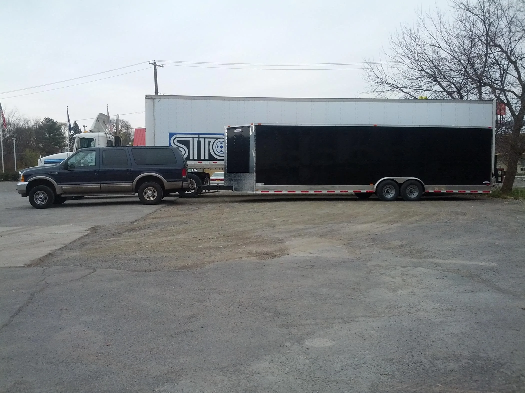

I had 14,000 lbs behind my Excursion that was rated for 10K, and I towed that load 1,400 miles from Minnesota to New Hampshire. I’ve also had 12K behind my 2013 F150 with that same trailer, and it was just fine. The trailer brakes worked great and I had a properly setup WD hitch, and they handled each trip without much drama. I only wish they had the kind of power that our Lightnings do today.
I’m cautious about tongue weight, axle weights, and keeping an eye on engine and transmission temperatures. If you don’t exceed those weights or get something too warm, you won’t hurt the truck. Modern electronic controls are calibrated to limit power before you get to that point, and I’ve never seen my battery or motor temps get hot enough to move the gauges.

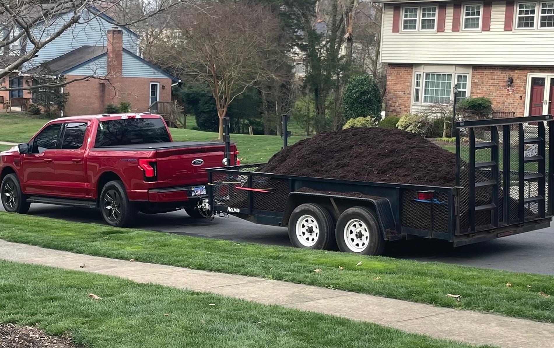

Little over 8;000 Lbs no problem, Truck works every day without issue.

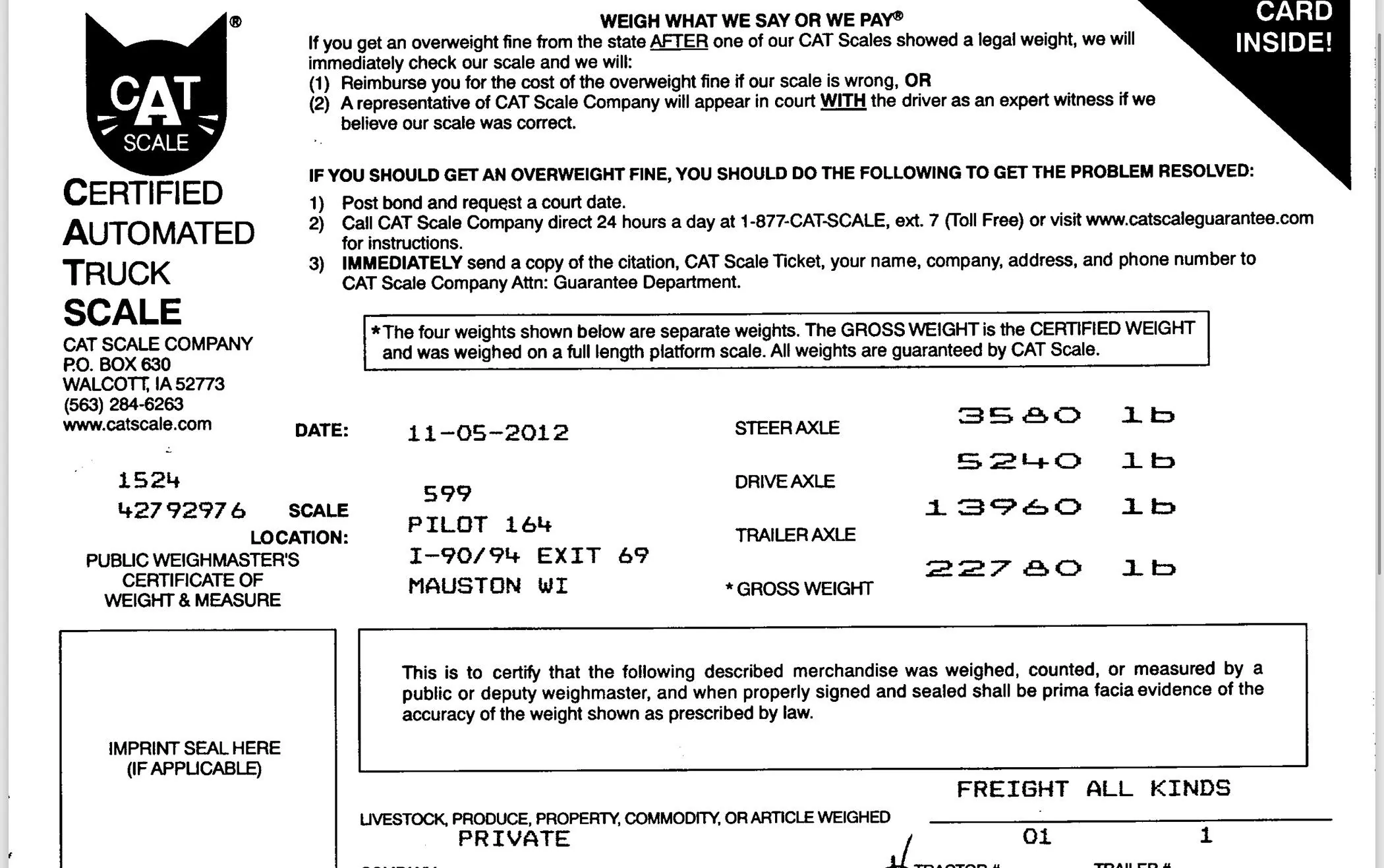

That’s not true. The weight placards on the truck and trailer are enforceable in some jurisdictions, but that’s it. The towing limits are manufacturer recommendations.
They can’t cite you for that any more than they can test your gas and cite you for using the wrong octane.
Ford F-150 Lightning Towing Over 5000lbs Capacity (7000lbs Camper) IMG_1184
TomB985
Jan 14, 2023
367
765
Isanti, MN
2022 Lightning XLT ER
Re-read the bottom paragraph. You can be cited if you’re carrying more weight than you’re licensed to carry. That’s about requiring a CDL and how much weight a trailer is registered for, it has nothing to do with the manufacturer’s towing recommendations. I was a professional driver in a past life, and commercial vehicle enforcement is the only LEO I’ve ever seen to care about weight. None of which has anything to do with the manufacturer’s recommendation.
I’m not familiar with every jurisdiction, and I’ve been wrong before. Can you find me an example of someone being cited for exceeding a manufaturer’s towing recommendation? Can you find a statute that imposes legal weight to a manufacturer’s towing recommendation?
