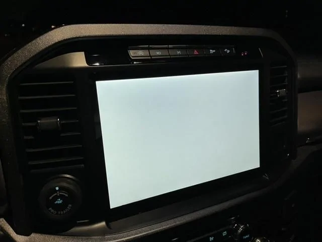

His situation looks bad. I realy think they sent the wrong file out for his truck. It loaded them and screwed it up. That is 100% the 8inch look. The 12” even if the as built was wrong would still have the side bar. The 8” and 12” are identical and load based on what the manifest calls for. And it called for the wrong setup. His only hope at this point would be another update.

this issue would happen with guys on3.4 they have a sync 3 and a sync 3 lite. Guys would download a update from online and load the update and all the sudden their sync unit would display in 4” size. That’s because they loaded the 4” update which were the same different resolution.
I think his is toast. If he sends it to me I can try to downgrade and then go back up.
Outside a future update he will be stuck like that. He is limited in what he can do. I have way more capacity in my office because I have so many tools.
I am sorry it isn’t his fault it is fords servers. They detected something wrong. This is a fluke. He just got the wrong update and there is NOTHING HE DID OR COULD HAVE DONE to cause it

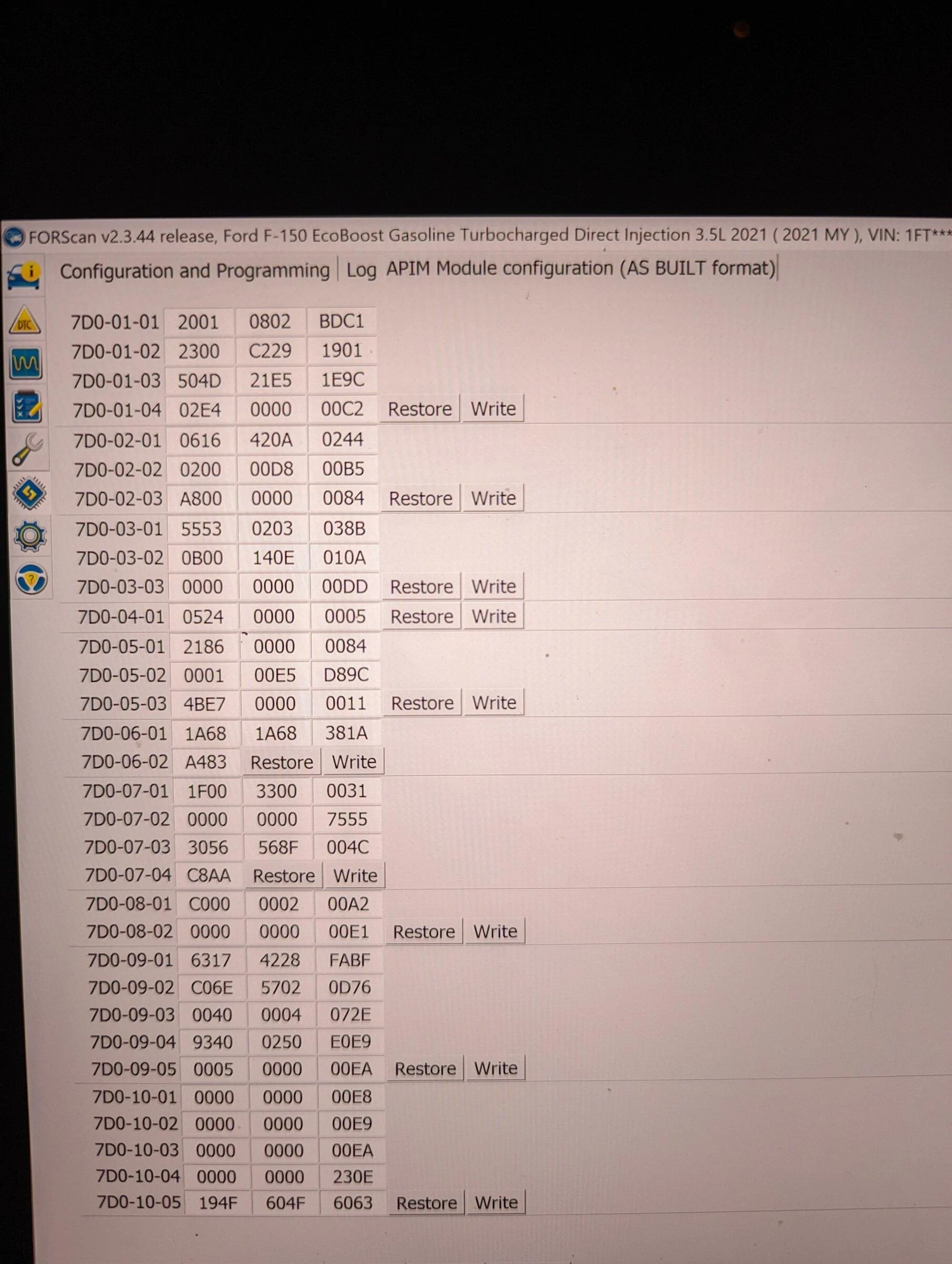

So here is my as built information I pulled from Forscan, if it is of any value. One thing to note is that the bottom bar stretches across the entire bottom of the screen, and doesn't cut off where the right side menu bar should be. It's almost like it is posting images from the 8 and 12 inch versions in different spots.

Your as built is correct. It was a long shot.

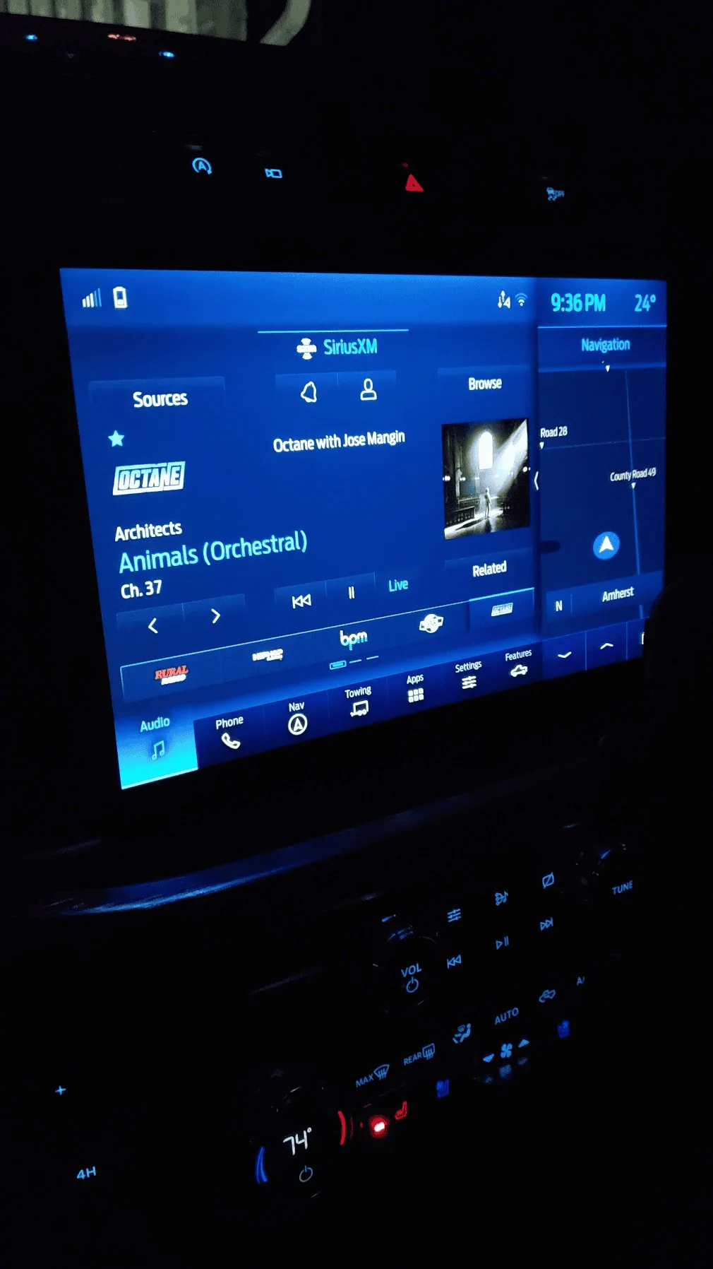

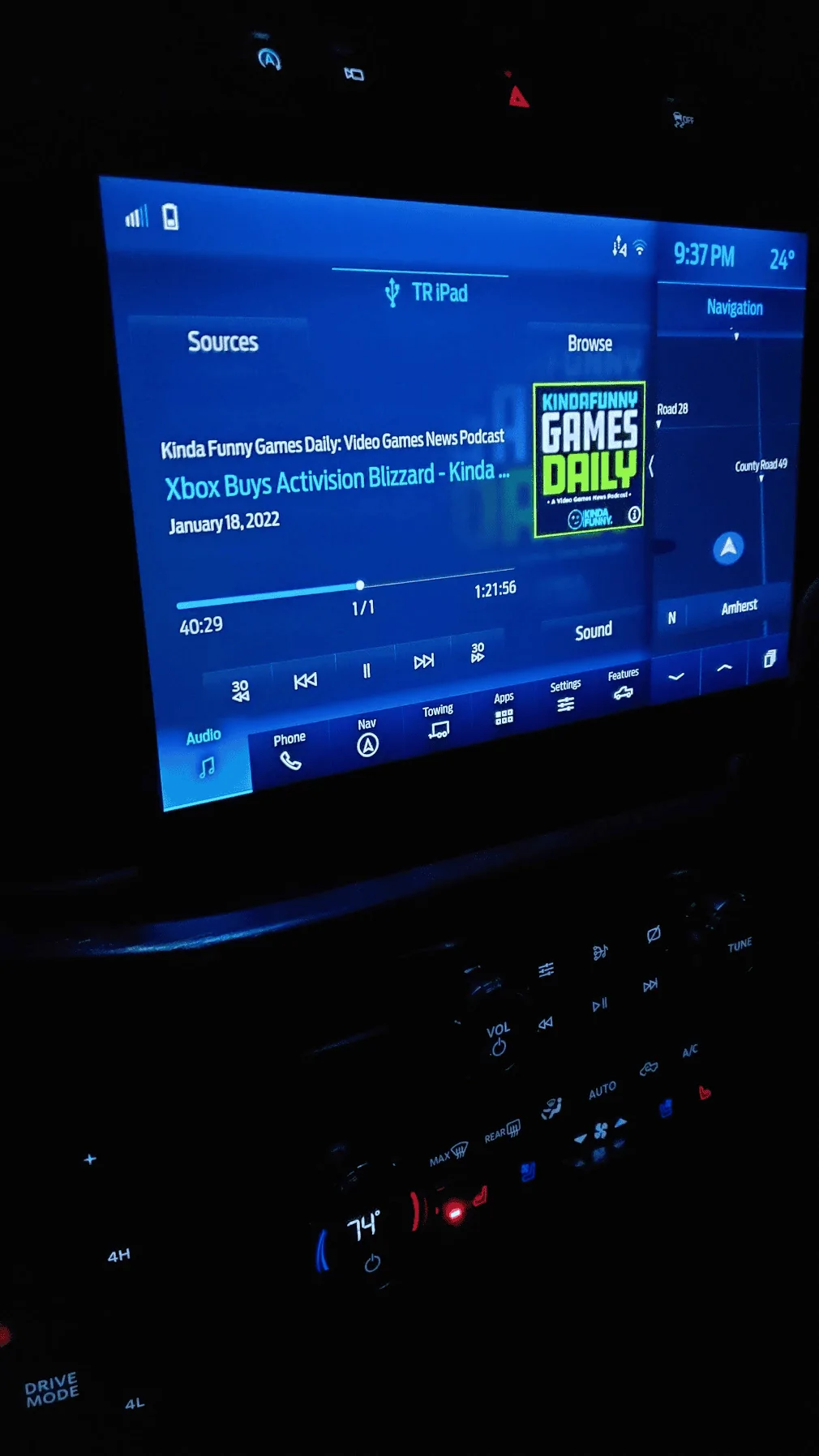

My Job1 early MY20 updated to 2.3.0 this last night much to my surprise and like the improvements and changes I've seen so far. I like the layout of the Audio tab much better and the info it gives you, and they finally fixed the bug where my bluetooth phone info didn't show up all the time at the top left! They also changed something with how the at speed camera menu works as that is different now than it was before, but need to play around with it more. Still no normal reverse camera view at speed though for me, still only the hitch camera shows at speed. The volume pop up screen font is also different from what I can tell ;)

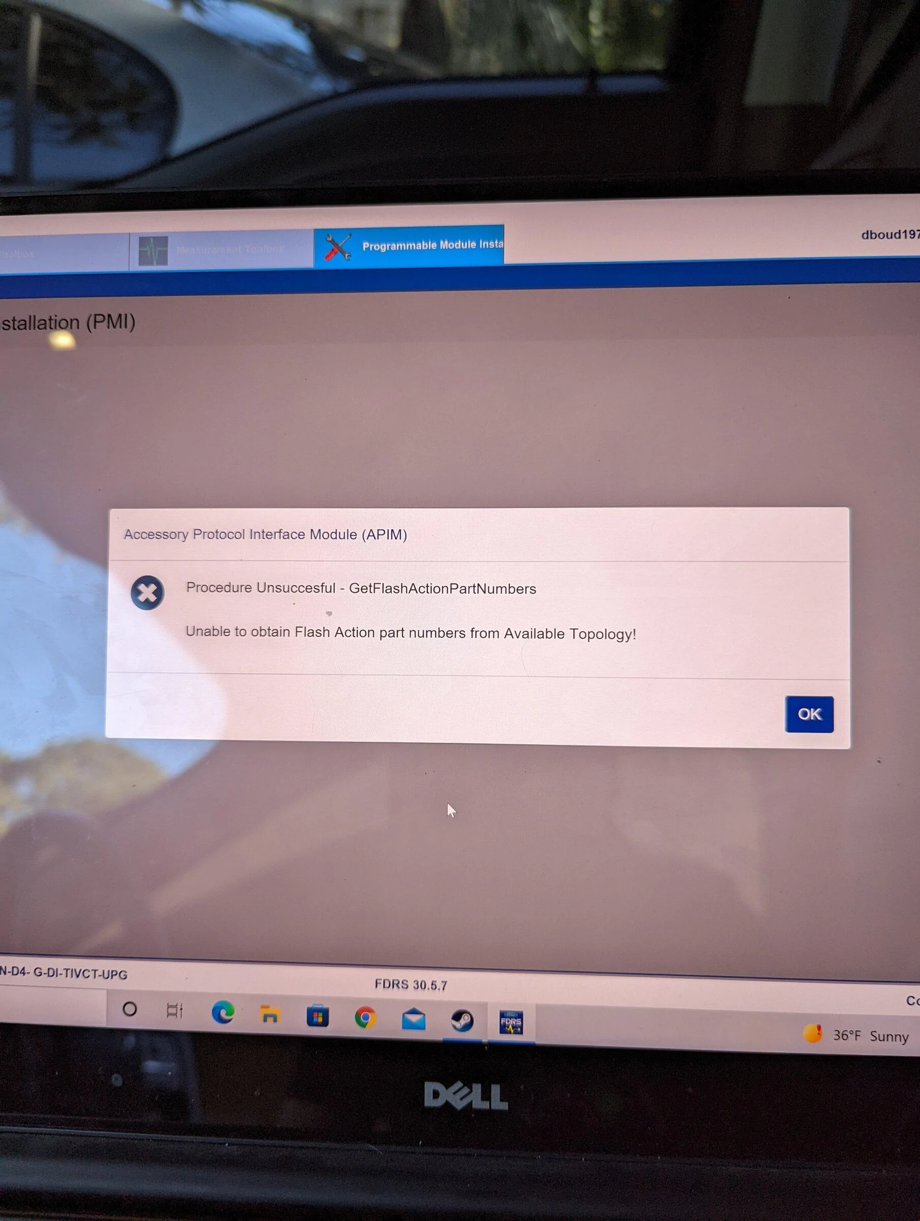

This is another shot in the dark. @Hauk but try to run a PMI on the APIM in FDRS. IT MAY allow you to redownload the files it MAY see a weird version in its check and download a new update. It may also boot you since its already the existing APIM. Its something to try while you have FDRS
You were right, the PMI procedure did not allow me to finish and kicked me out with the below message.

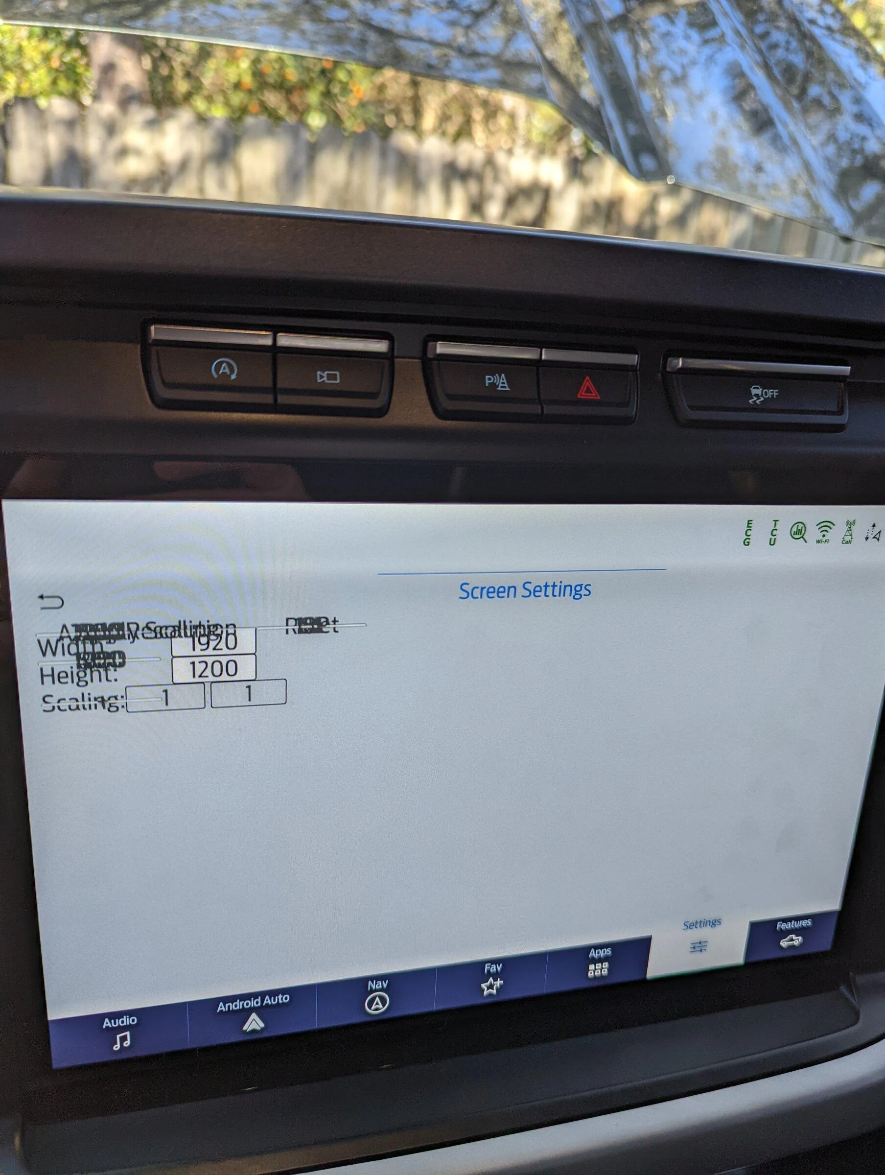

One other thing I wanted to verify was the screen size setting on the testing menu page. The text is jumbled but I can read out 1900x1200 resolution. Is this correct for the 12 inch screen?

Yeah.. that is wrong the resolution thats the 8"
Try the PMI again. Make sure you have a good internet connection.. Fortunately that wasnt a complete fail it tried. So try again.. and again until you get passed that message. You may get somewhere. That message is a failure to download not a failure of a condition it detects in the truck such as part or software.
Ok I will try again. Also when prompted should I tell the system that the original module is currently installed or that the replacement is already installed?

Also what is the correct resolution for the 12 inch screen? Would it be worth trying to update the resolution on those text boxes on the screen size screen or is that not going to do anything?
Say a replacement
