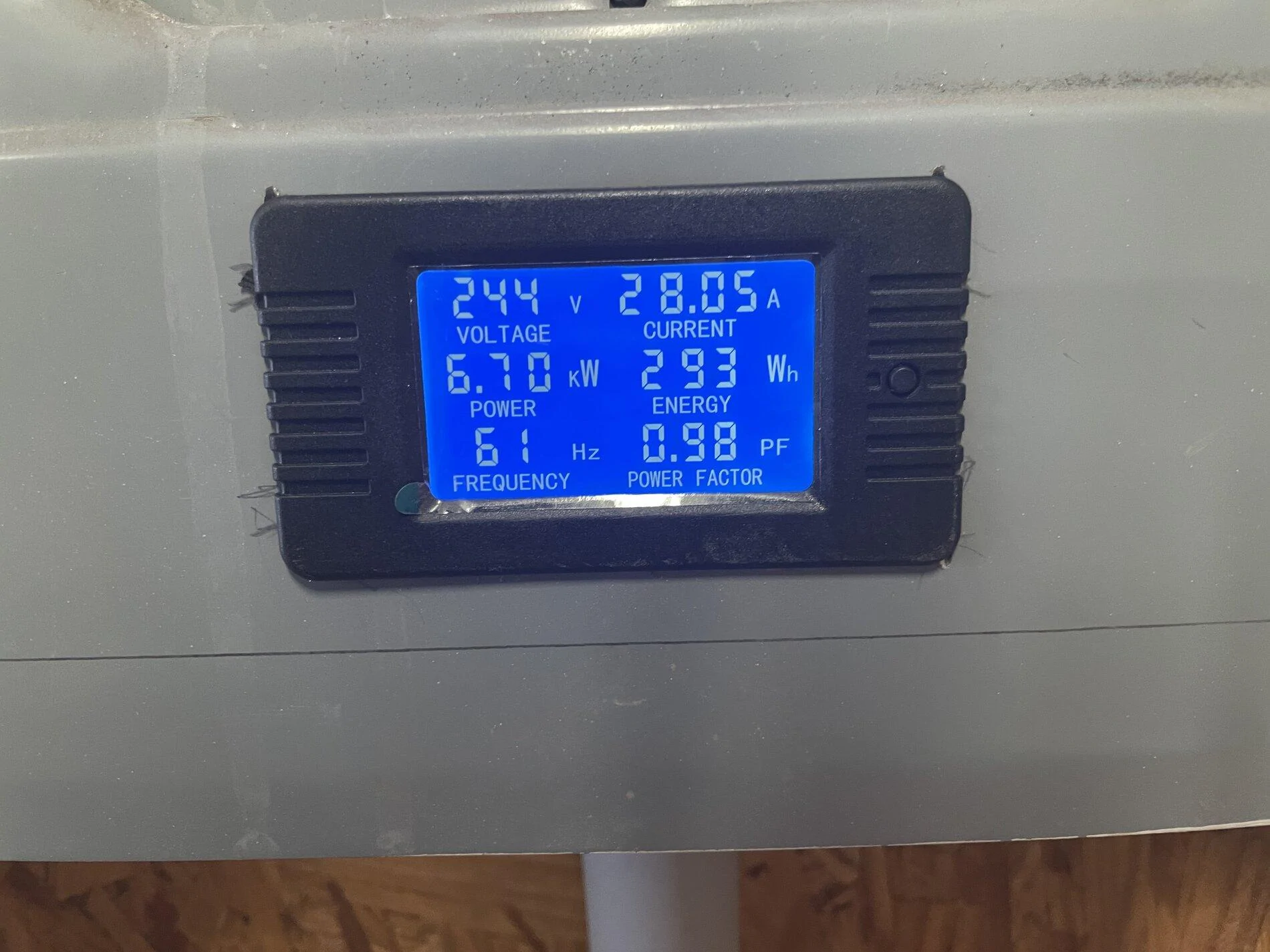

7.2KW should run most of the house and an A/C unit as long as a soft starter is installed on the A/C. I'm using a 9.5kw roll around and it powered every light, TV, fridge, fan, and the 5-ton downstairs AC unit on a 3700 sqf house when I did load testing while putting out 6700 watts at 28 amps.

Now that I actually have a truck, I see that 7.2KW power station only has a 30-amp output. My test load above was 28 amps for the whole house, but the AC was already running when I took that picture. Most assuredly I was pushing 50 amps when the AC kicked on. If you are going to run the whole house from a F150 you will need a very good soft starter on your AC and probably need to keep the lights and TVs to a minimum anytime the AC could be cycling. The 7.2KW is plenty for a whole house, but the 30 amps is marginal.

7.2kw is 30A @240v, what are you trying to say? Two hot legs @120v each with 30A of power makes for 7.2kw. That’s normal for an L14-30 connector which is why they probably made the inverter this power. You couldn’t have any higher amperage at that voltage and still be within 7.2kw.
For some reason I thought the truck had a 14-50R plug and not a 14-30. Looking at mine now that I have delivery i see I was wrong. I guess I assumed it was 7.2KW running and something higher (maybe 9.5KW or 10.0KW peak), but I'm probably getting just getting myself confused with all the other generator research I did after snowmageddon.
