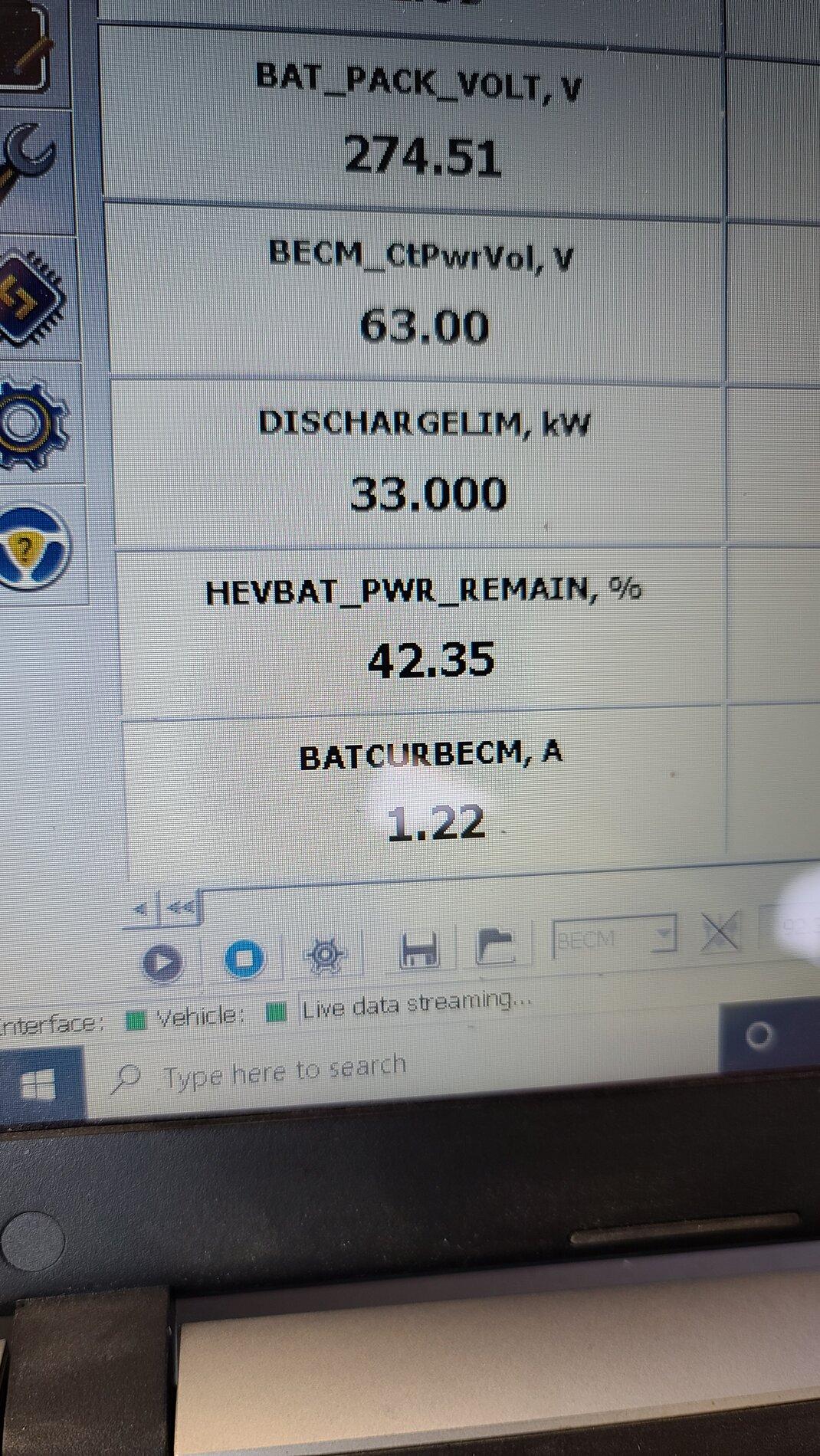

This thread had me curious, so I did some more messing around. I used forscan to data log a few parameters regarding the hybrid battery, and it is extremely interesting...
I was mainly curious as to what the idle load on the battery was with nothing on/running, and when it called for the engine to run to recharge. This picture shows my trucks idle current. Again, this is everything off. HVAC, center stack screen, lights, everything off. This is the lowest I saw. It mostly hovered around 1.5 amps.
Ford F-150 Lightning Powerboost Propower and locking/double-honking/starting/parking/camping 20210412_183426
My guess is that this is due to the sheer amount of modules running in the truck while it's on. Looking at the truck info, there was probably 40 modules listed.
Here's what really confused me. While I was data logging, the truck started and went to 1500 rpms to recharge the battery. When the engine kicked on, the battery percentage was at about 42%, with a draw on the battery of roughly 2 amps. The truck sent about 115 amps to the battery to charge it, and it started charging really fast. But oddly enough, the battery stopped charging at 49.6%, and the engine shut off a few seconds later.
I am really intrigued as to why the battery didn't charge up to 80-100%, but stopped after only gaining a charge of about 8%. Very interesting... I will test this more thoroughly tomorrow, and I'll be using varying loads on the pro power to see how it reacts.

Ah! Thanks for digging into the gritty details, I have not messed with Forscan at all, I'm afraid I'd go down the rabbit hole and want to reverse engineer everything.
So that must explain why even at light light loads, it can still do a few engine starts within short times of each other. i.e. it doesn't automatically charge until full, which is surprising!
I turn on Eco Idle so that the battery charges faster. But I guess it still decides "eh, I've had enough for now" and stops charging.
What I wouldn't give to be able to see HEVBAT_PWR_REMAIN in the dash and on Fordpass, it would help let us know how long we have before the engine kicks on, and can manage quiet hours better. Like I may want to sit in the driver seat and put it in tow/haul or sport and have it charge to 100% just before generator hours end and quiet hours begin.
