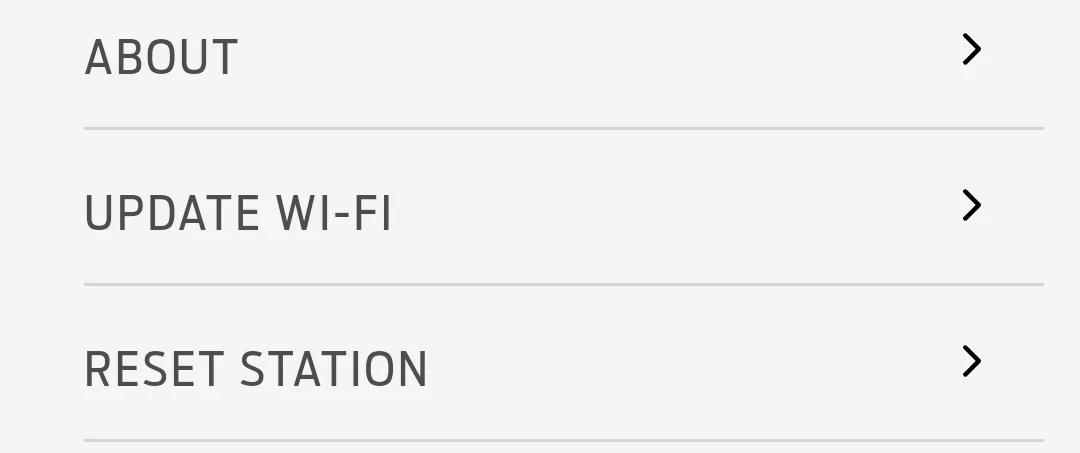

There is a red button to the left of the lugs where you terminate the incoming power, or you can reset it by the Charge Station Pro setup app. The app would be safer for those nervous about having the cover removed with the power on.

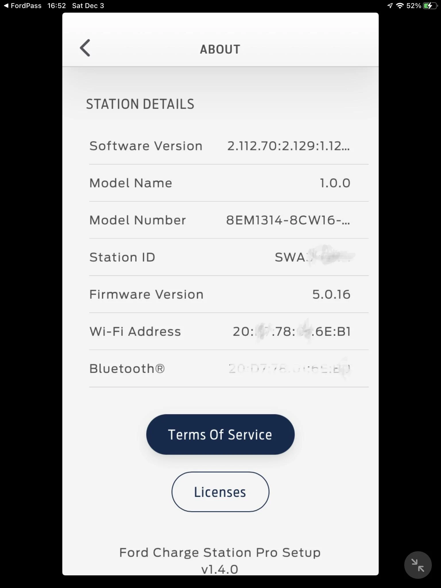

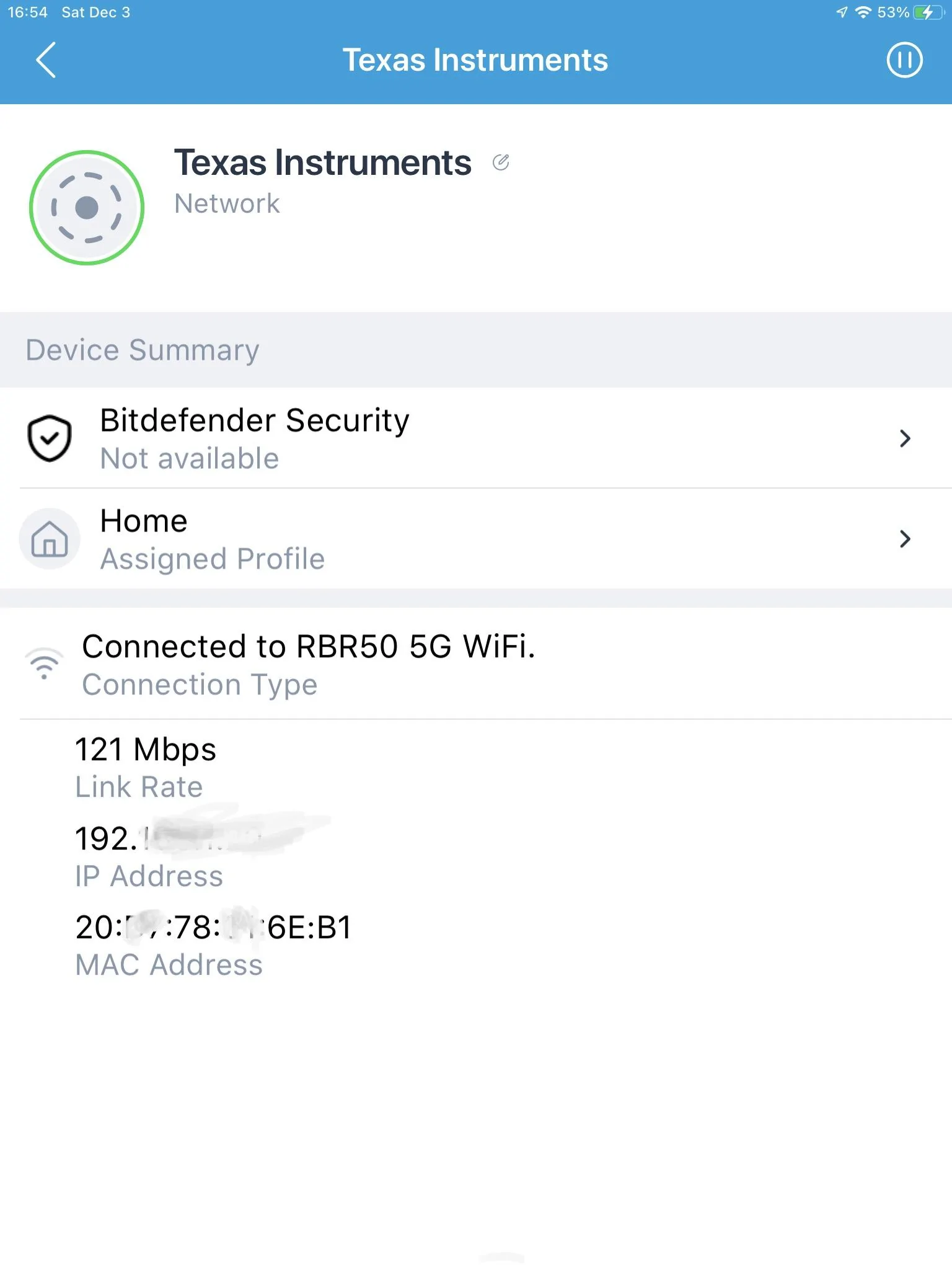

In my case when I configured my FCSP, my Home network was never viewable….I had to manually enter my network SSID during the setup in order to connect.
Post setup, I had to do a MAC Address search on my home network to figure out which of my connected devices was my FCSP….it shows as a network: Texas Instruments…..
FCSP app

Network Manage app
Ford F-150 Lightning Pro Charger Wifi Help E4842ACB-31DB-4107-96FC-A8FF441856BF
