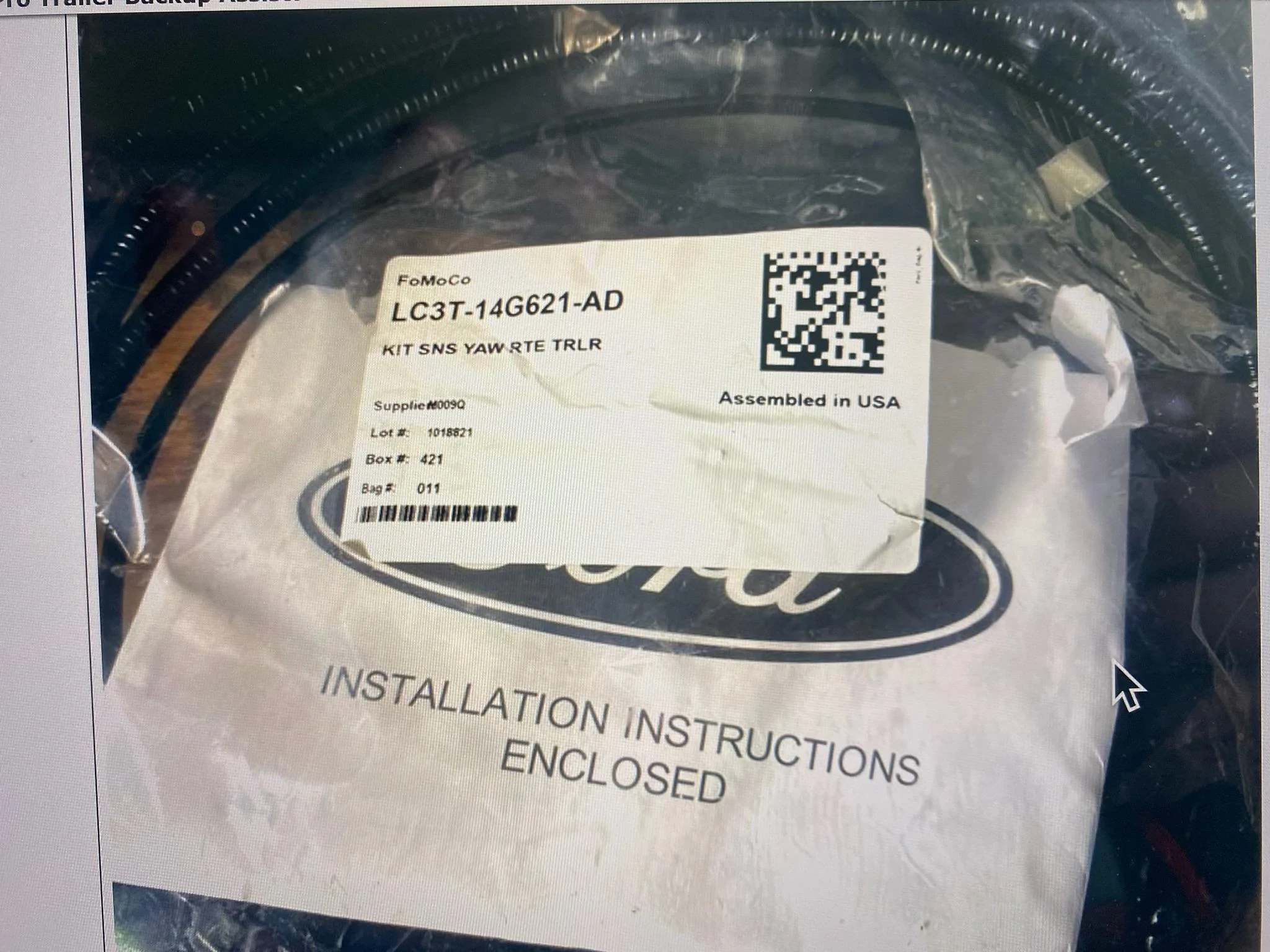

Anyway, I'm trying to buy the dang sensor kit, but I can't seem to find anyone that can give me the part number(s) of what I need. Just to prove that I'm not crazy, this is the kit that I'm looking for:
Ford F-150 Lightning Pro Trailer Backup - yaw sensor kit? No one seems to know what this is. 1646404747804

Oops, I forgot. The part number of the kit I bought on ebay was LC3T-14G621-AD. Hope that helps.

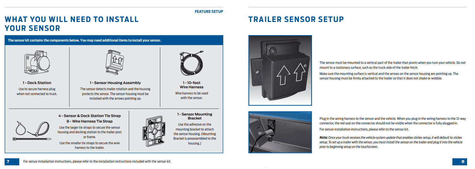

Here is the kit you need. I found this info on f150forum.com. However, your truck may not have come with it,it may have the stickers and they should be in your glovebox with the trailer backup directions. Later trucks built in July or so have the updated software to use stickers and not the yaw sensor. Hope this helps you.
Ford F-150 Lightning Pro Trailer Backup - yaw sensor kit? No one seems to know what this is. 65FE9109-C08C-4A2A-B8A8-5FAE27786AD6

If you have Tow Pkgs with Pro Trailer Backup Assist you have in your truck either Stickers (will be in with all the manuals) or the Sensor and cable (might be hidden somewhere in your truck (under/behind the seats, etc).
If you have neither your dealer owes one or the another to you.
Note, my 2022 (built in Dec) came with ONLY stickers. Manual says I'd have to buy the Yaw Sensor as an accessory if I want it.
