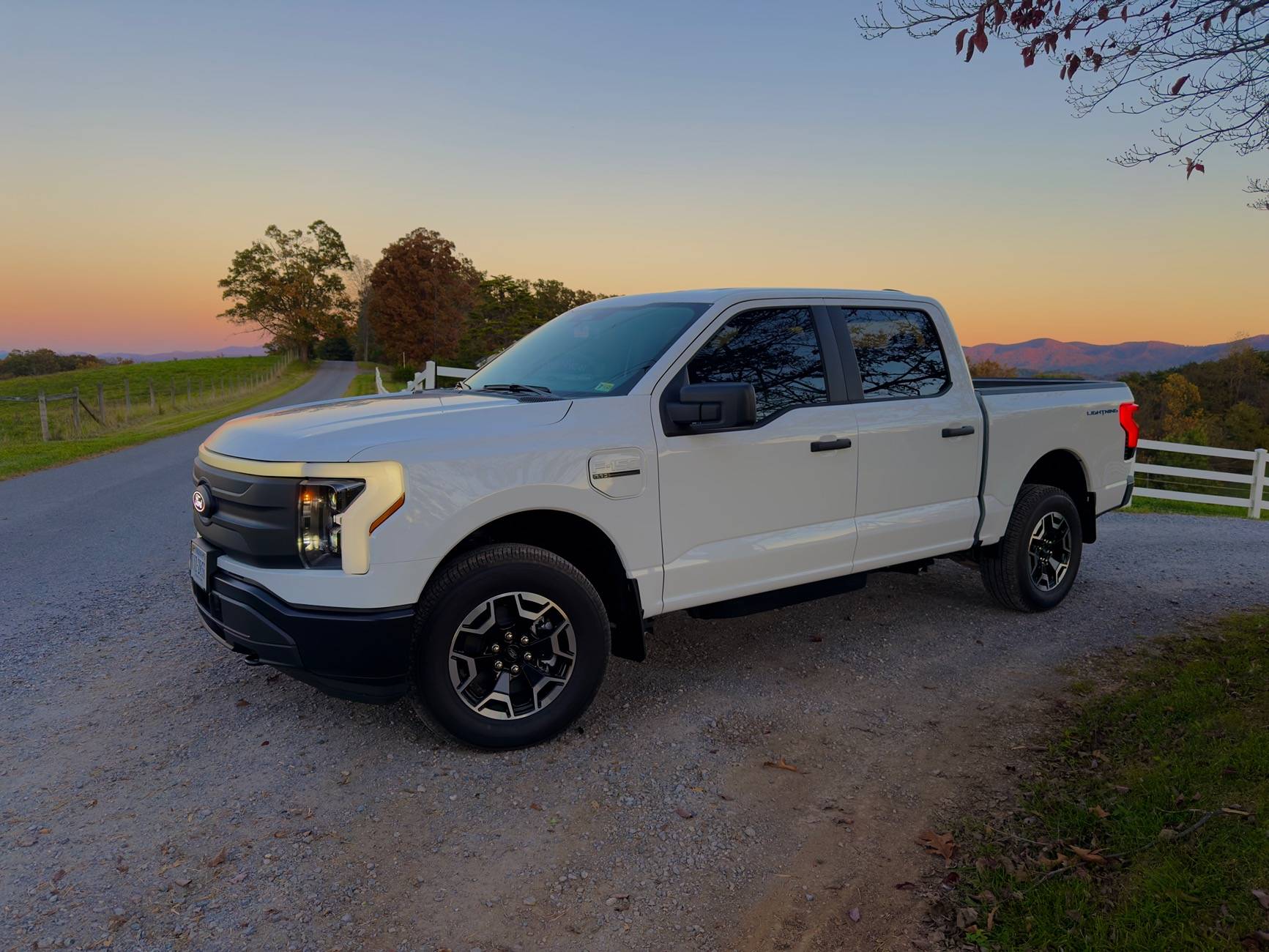

Just found this thread, but I’m about 2/3 of the way into a very similar build on my 23 Pro ER. Fantastic work!!
I’m not sure about changing the seats, honestly, I don’t mind the vinyl so I’m on the fence. But the katzkin leather looks like a good option, so maybe eventually. Also, I love the pro wheels, so probably won’t change those but love the complete look of yours :)

Thanks! I would go for the upgrades that are most important to you. The cosmetics are in the eye of the beholder. I've since swapped the lariat wheels for aftermarket, but kept them in case I want to go back to a stock look.
