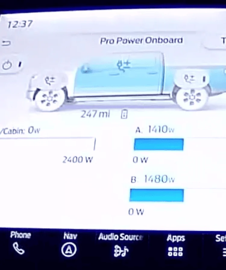

After all the good tips I got, the test went fine this past Monday. Today, the real test: Power company had a planned power outage from 9AM to 3PM. I had everything ready and switched over with no issues.
Here's the Pro Power screen:
Ford F-150 Lightning Procedure to test pro power to house IMG_4091
Leg "B" is supplying the whole house (fridge, tv's, DVR, internet, etc) plus a 12,000 BTU portable A/C.
Leg "A" is supplying power to a microwave used to heat up my lunch ?.
Truck saved the day! Wife is making fun of me for being excited with my big "toy" :crackup:
Super happy with the results. Thanks to you all for the help!
