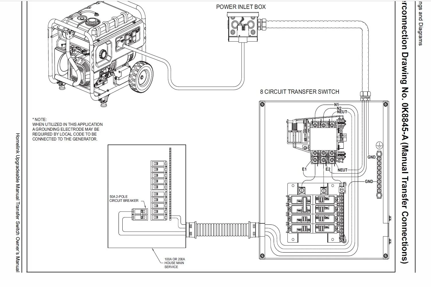

@chl I followed what you said here, and thanks for the great write up. I already purchased a Generac 6853 since that seemed to be the hot product. However, I have not opened it yet as I am still waiting on the FCPS and installation. Some people seem have it working by making sure the plug inlet and switch are not bonded. Do you think this is the wrong product and a GFI specific transfer switch is better?
Thanks!
I downloaded the User Manual, and searched for "bonded" in the text and I found this:
On page 11 of the user manual it states:
"Requirements
The Upgradeable Manual Transfer Switch is designed for use with portable generators with a bonded neutral, and used as a separately derived system. A grounding system and a grounding electrode system shall be connected to the ground terminal on the portable generator."
Also if you look at the wiring diagram on page 18, it shows that the transfer switch DOES switch the neutral lines isolating the bonded panel neutral from the generator.
Both are attached for your reference.
So is sounds like it should work.
