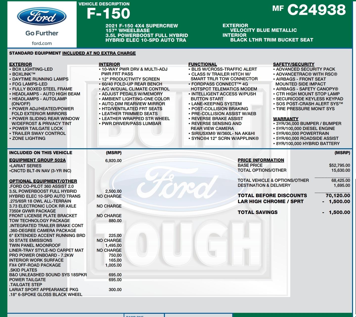

Got it. I just did the search as you suggested and also noticed this comment at the bottom of the page.
"Ford Co-Pilot Assist 2.0 includes rain-sensing wipers and forward sensing system when ordered on 500A or 501A"
Still odd that you are required to pay for the Active 2.0 package on a 502A to get the front sensors.
Agree it is silly. I really wanted FSS, so in part, it kept me away from the high packages as the price would have escalated quickly with having to add Active to it.

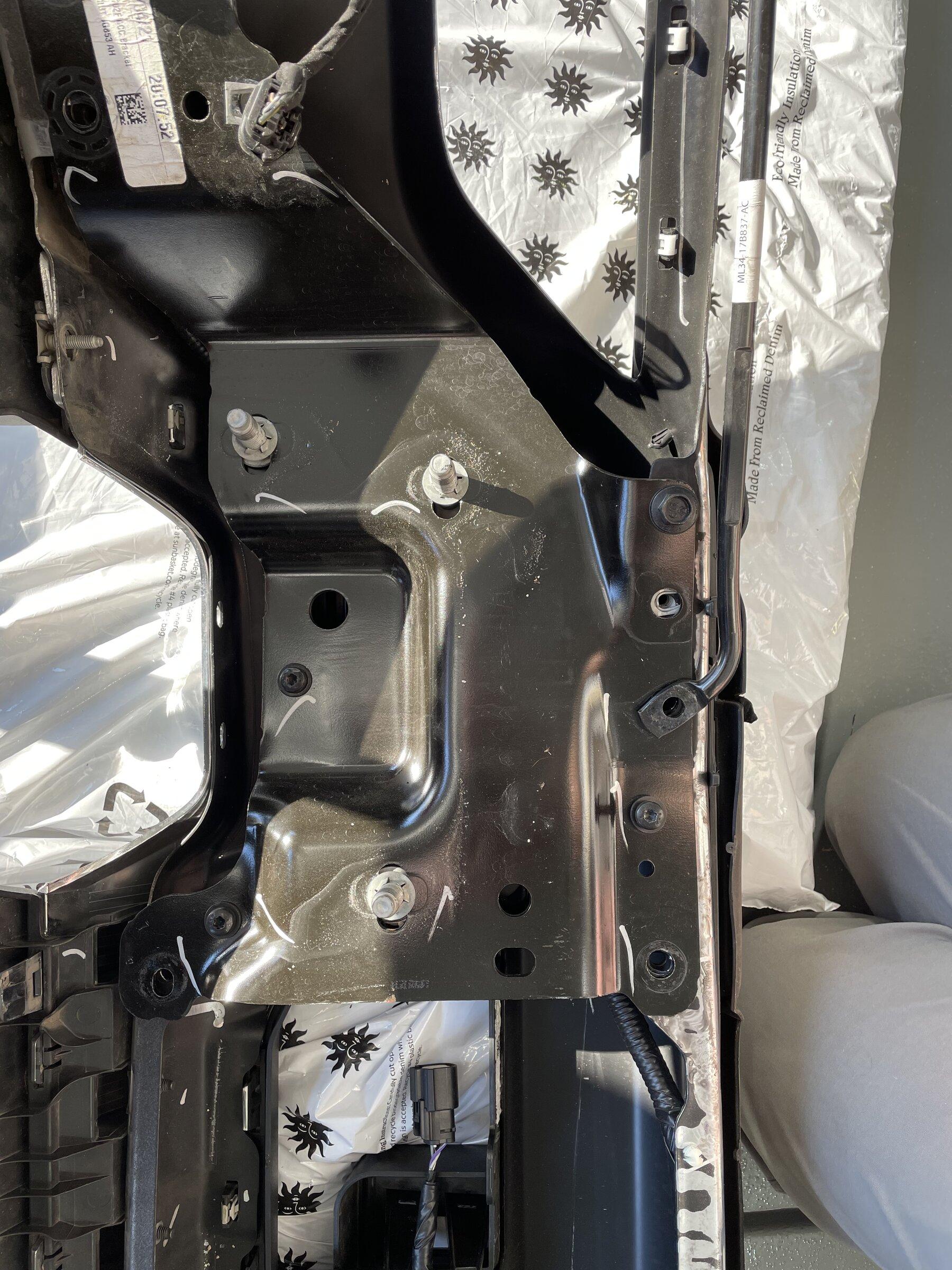

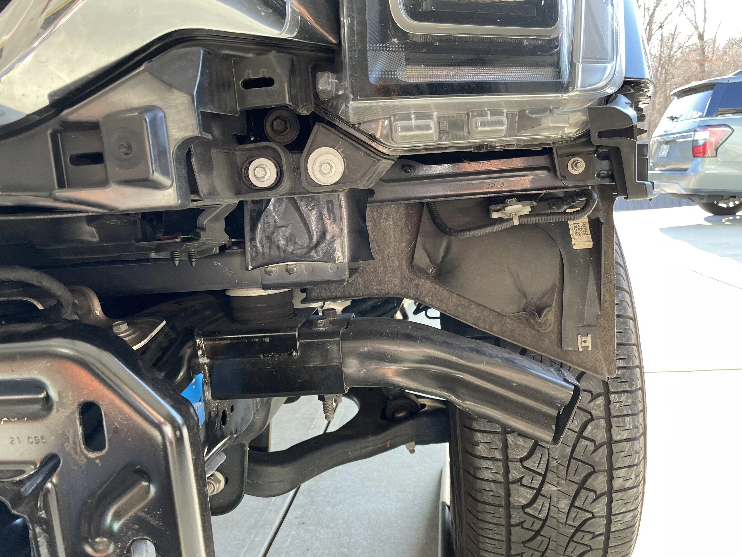

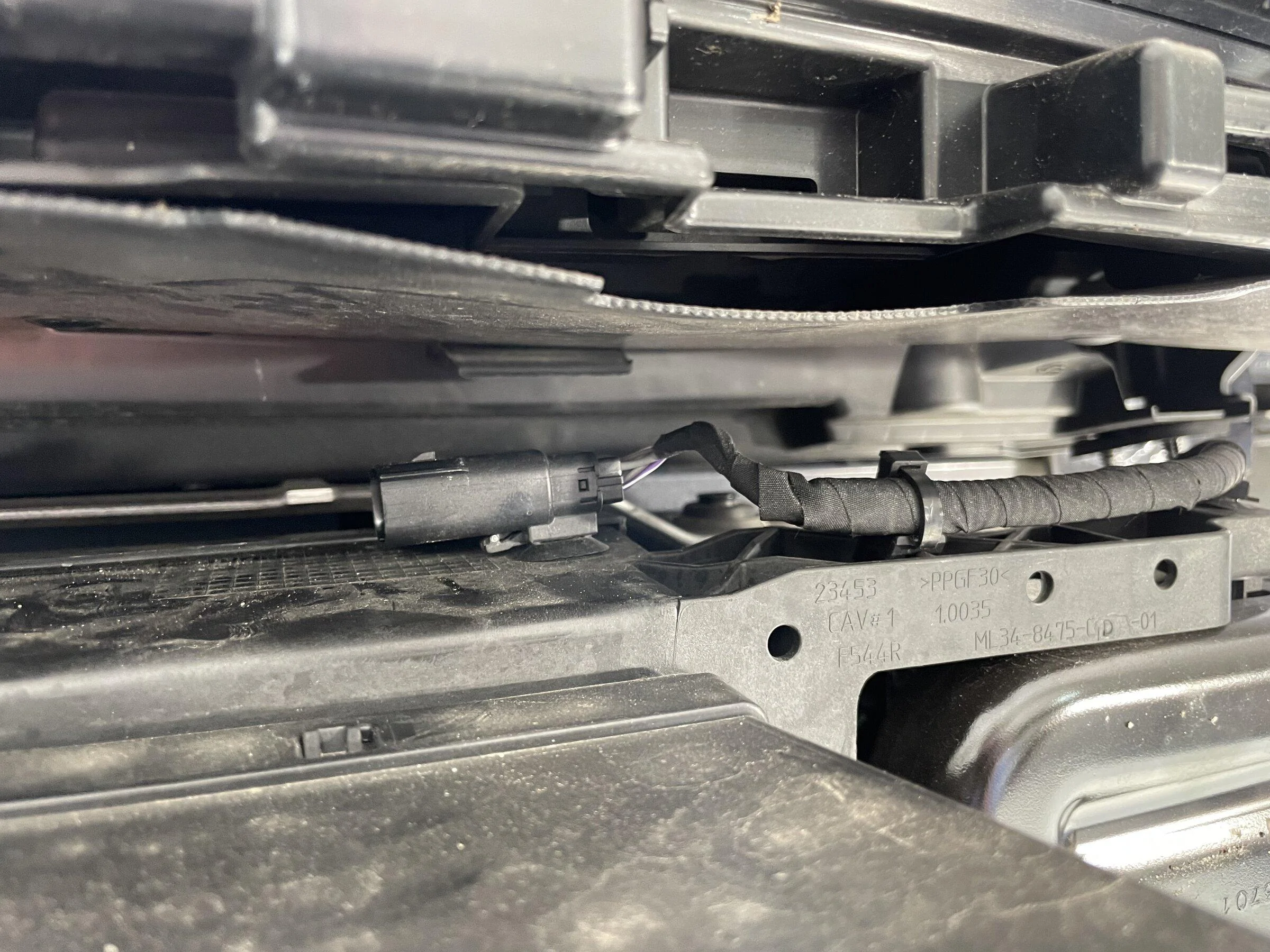

Working with my dealer’s parts department, we have been able to determine the correct wiring harness, front sensors, and sensor retaining clips to add the front proximity sensors to my 21 KR. I still need to figure out how to update the truck to recognize the sensors.
The parts are as follows: (Parts cost $373.78)
- (1) ML3Z 15K867 NA
- (4) LU5Z 15K859 AAPTM
- (1) ML3Z 15A862 ADPTM
- (1) ML3Z 15A862 ABPTM
- (1) ML3Z 15A862 AAPTM
- (1) ML3Z 15A862 ACPTM

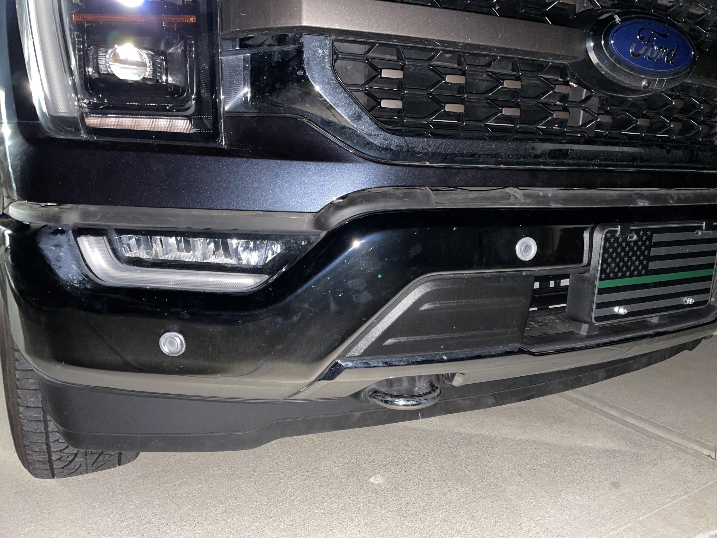

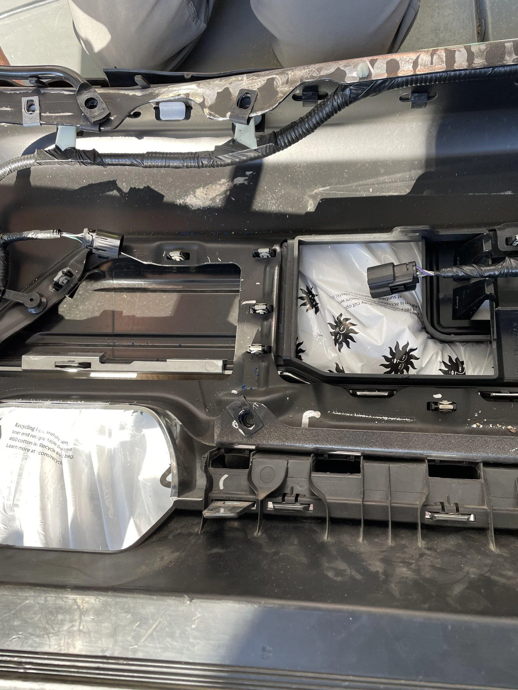

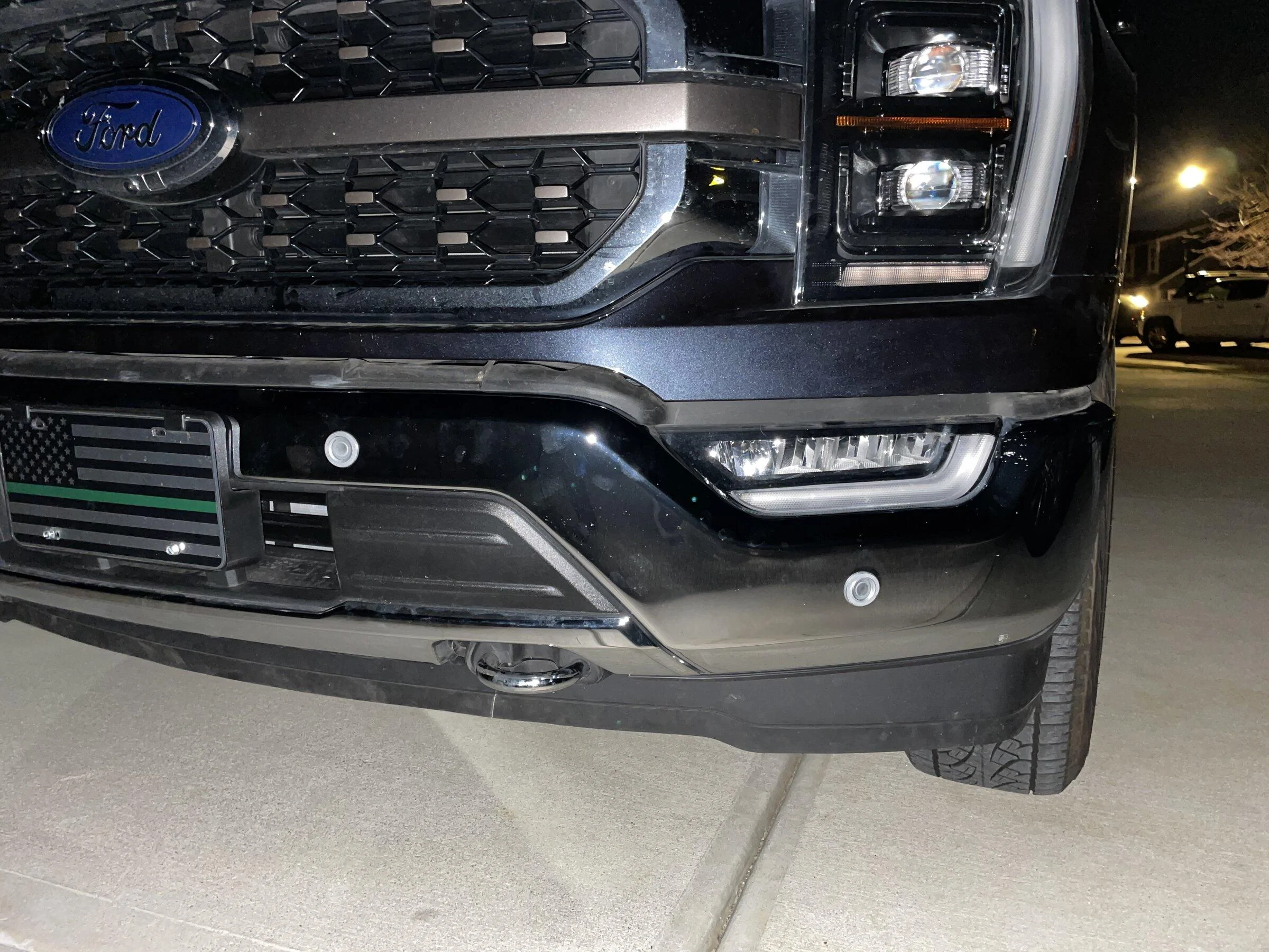

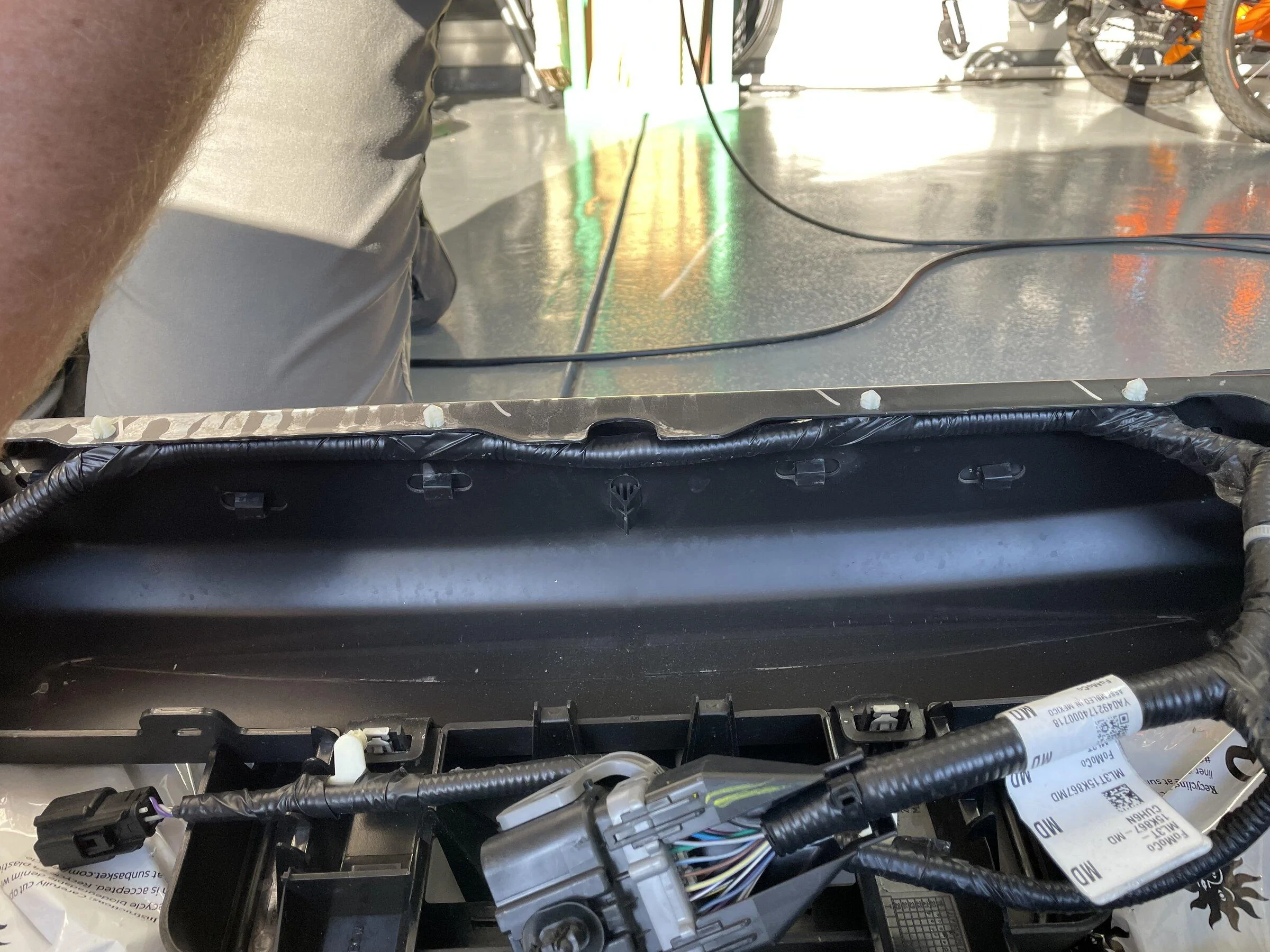

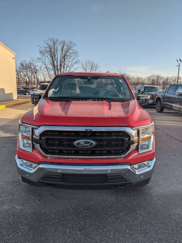

Pics of the front now that i finished installing the sensors. I will provide a better post once i figure out how to get them working.
Ford F-150 Lightning proximity sensors on front bumper? B903AFDE-8361-495A-B9D1-0514C2F6978F
Ford F-150 Lightning proximity sensors on front bumper? 22BB7E57-372F-41BA-9CE6-EE068C04EF94

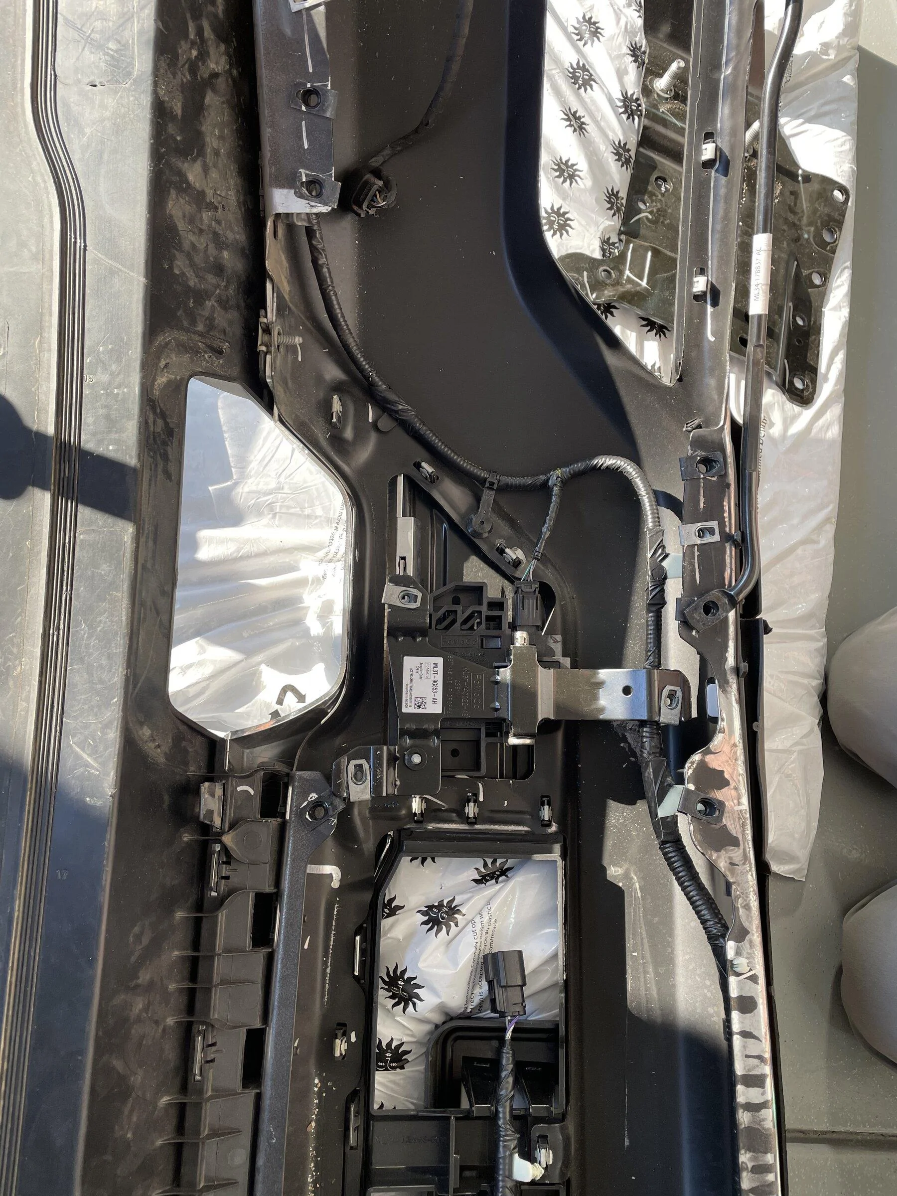

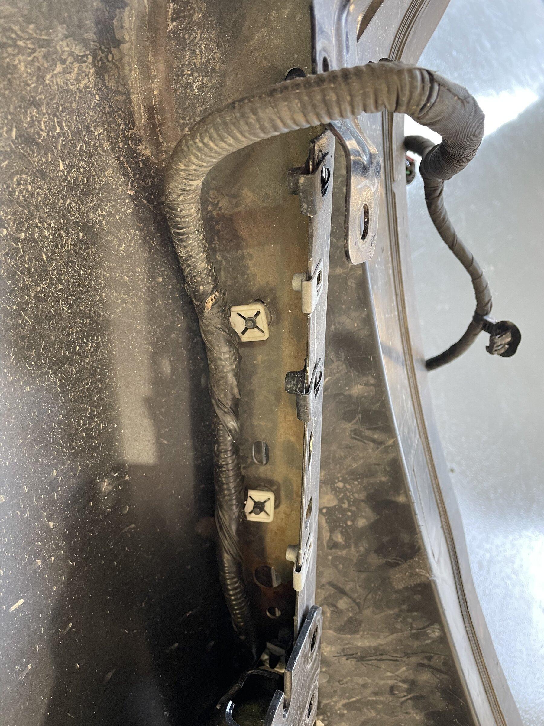

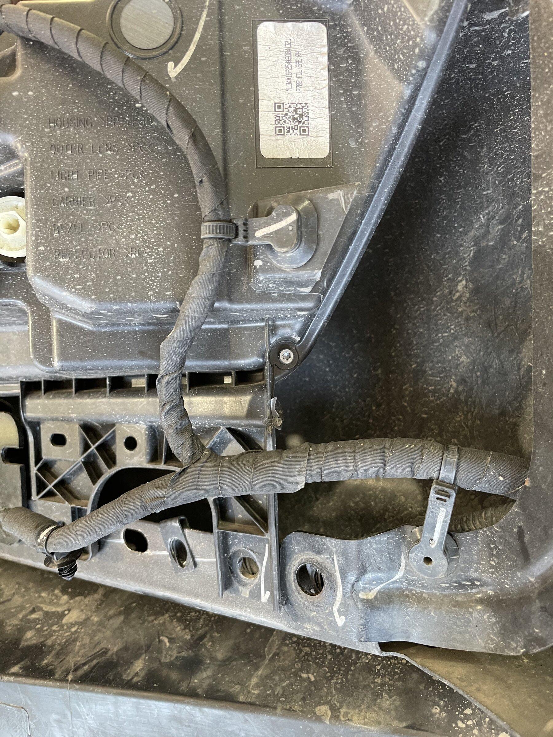

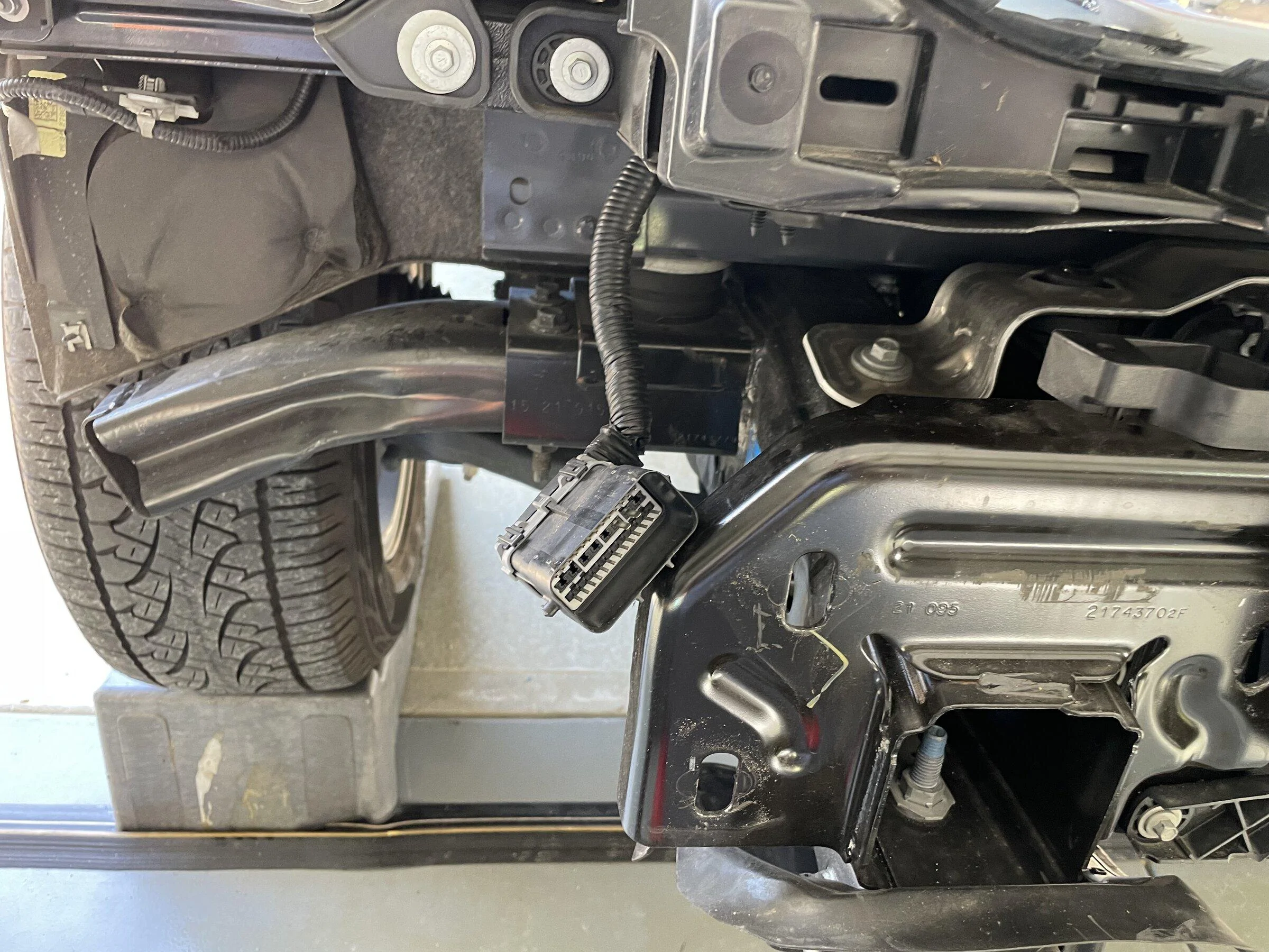

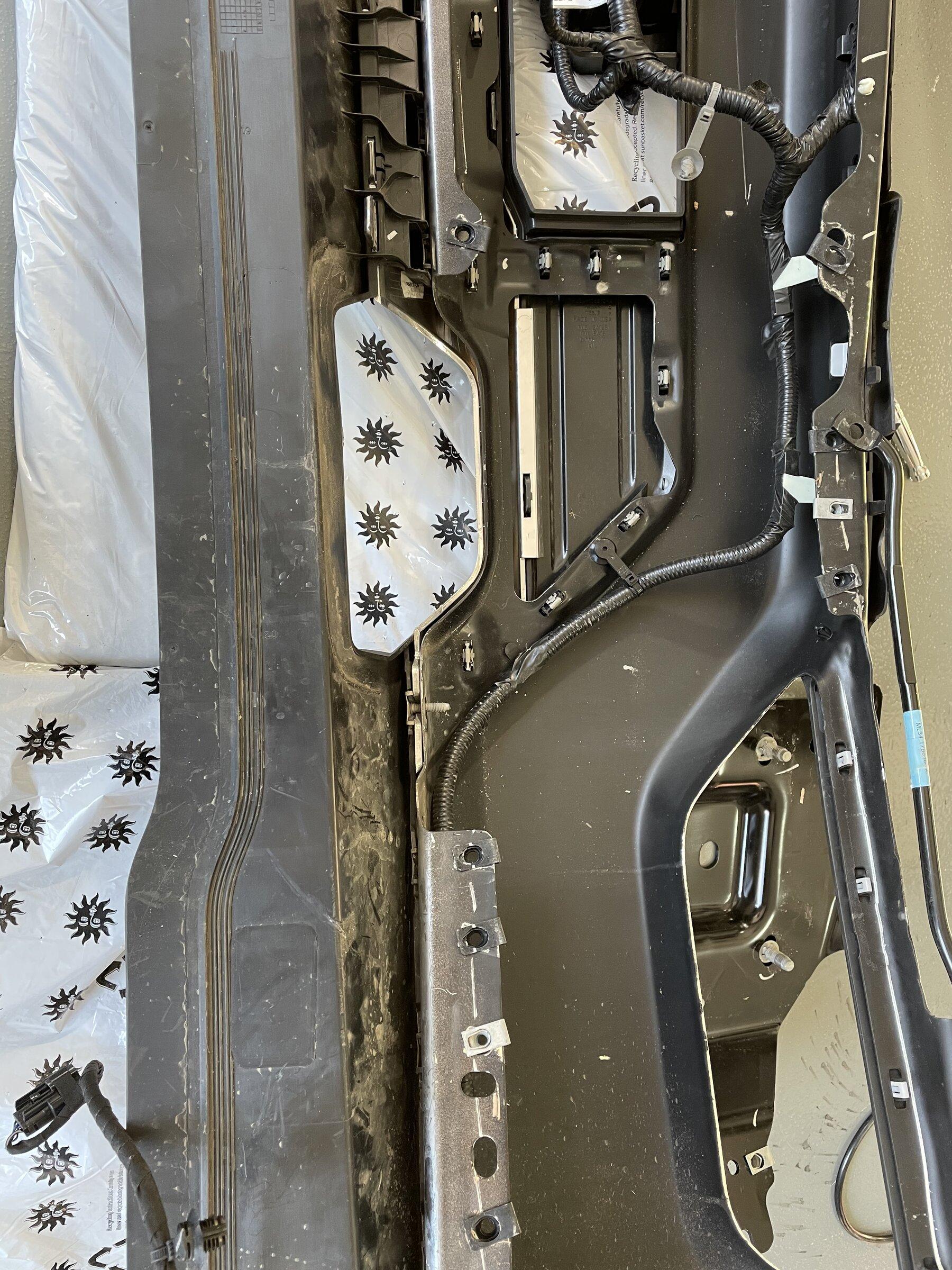

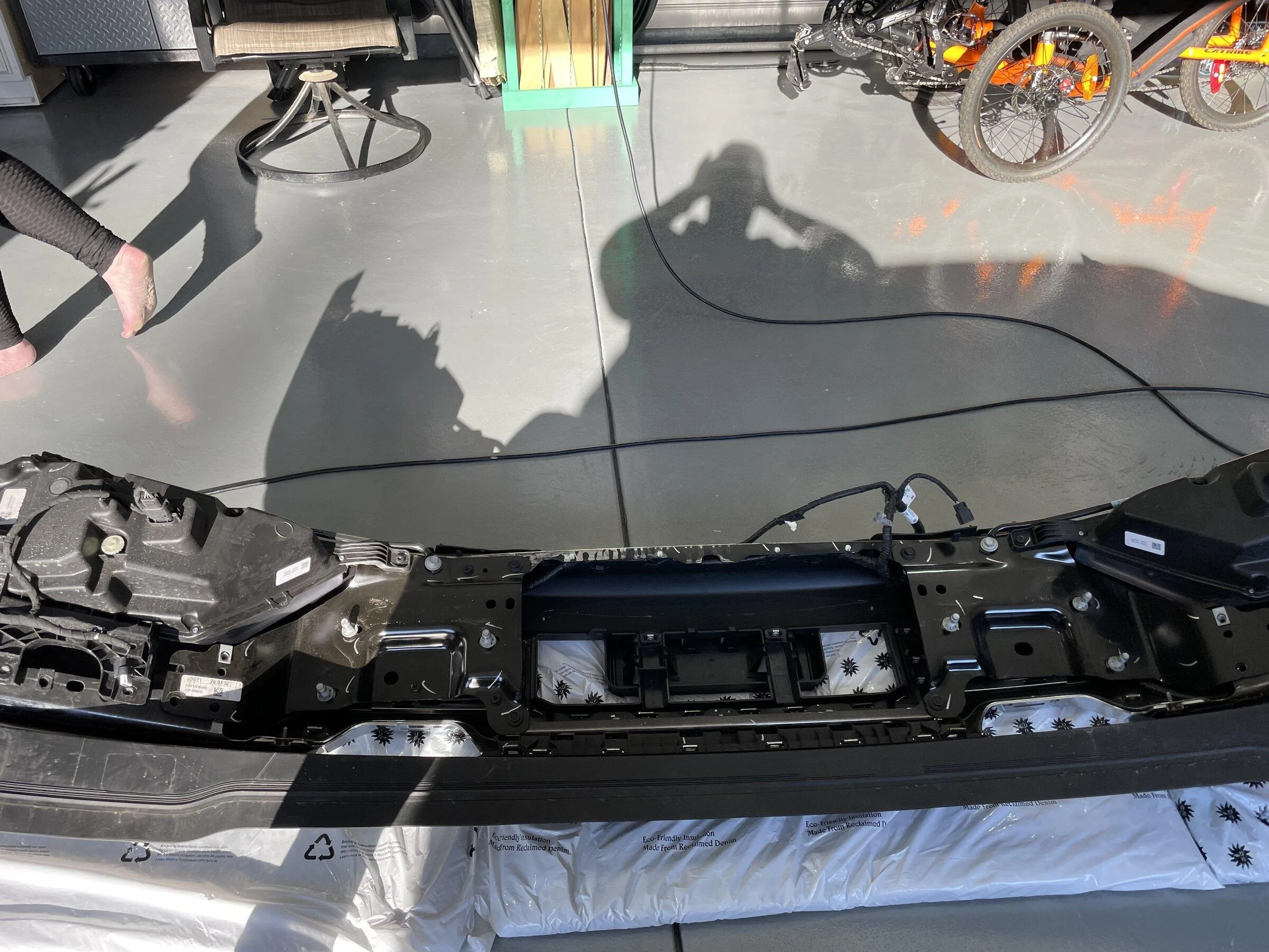

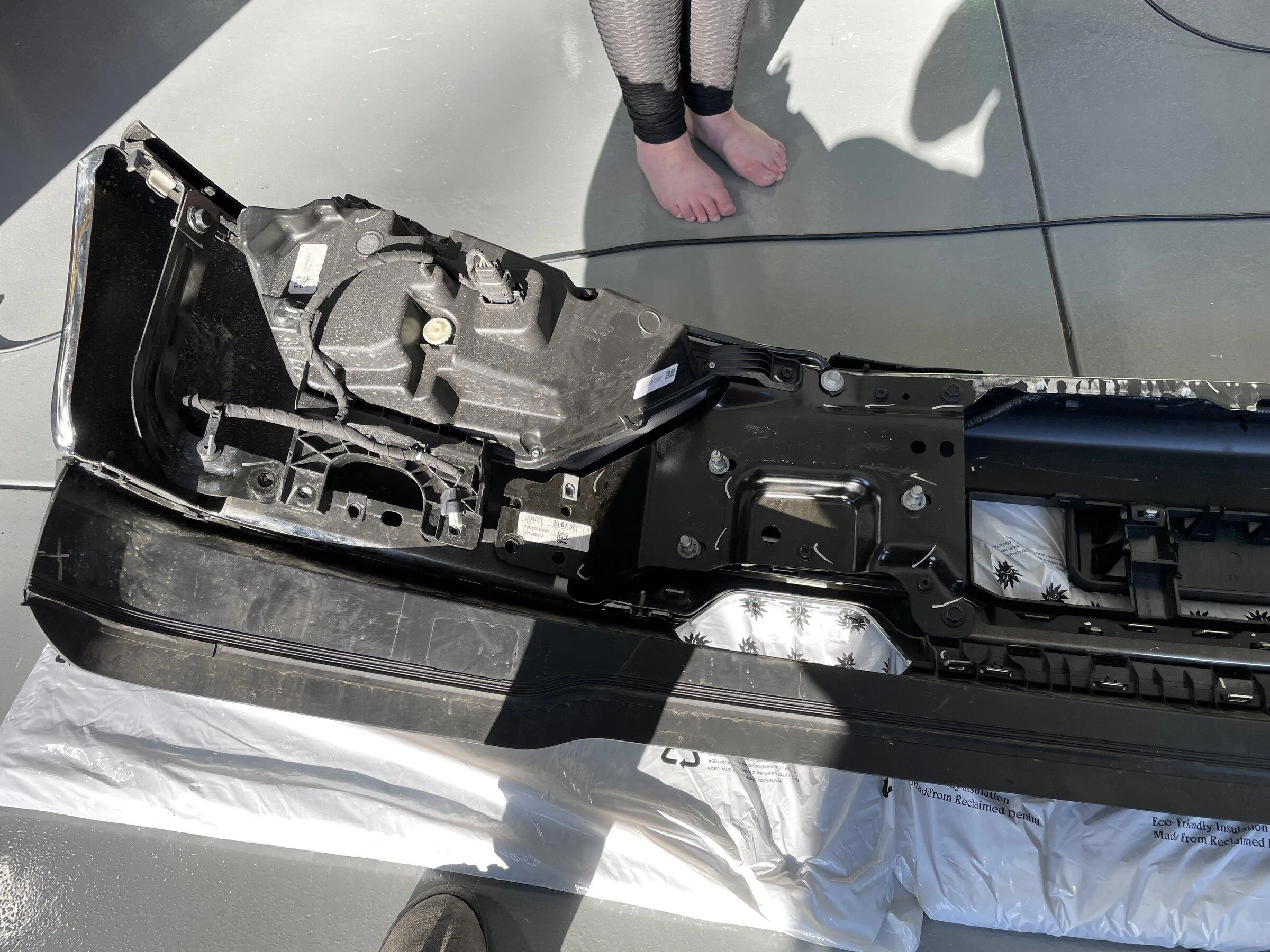

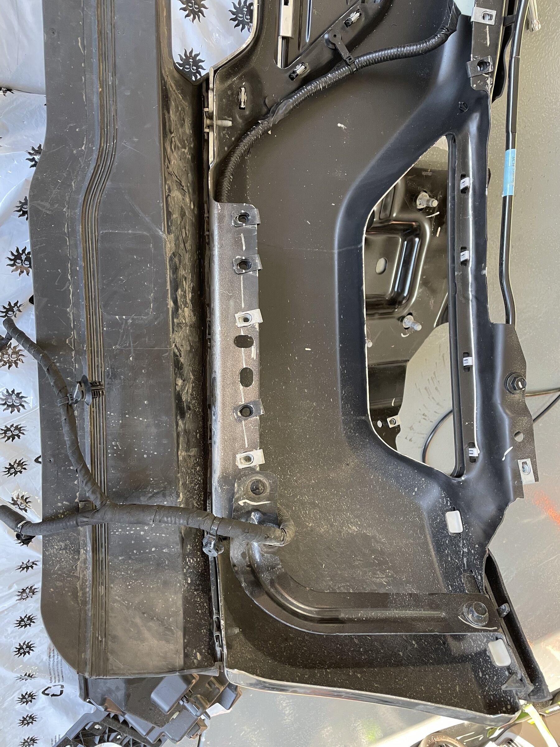

More pics of the wiring harness that was on the truck before i removed it. The one i added was the same except for having four sensor connectors as well.
Ford F-150 Lightning proximity sensors on front bumper? 46843531-00A1-41C2-8C60-C4CF92C29A96
Ford F-150 Lightning proximity sensors on front bumper? A59ECFE5-EE58-4953-9FF4-F11262444D6D
Ford F-150 Lightning proximity sensors on front bumper? 909B52D8-EEB4-4DB8-BC23-599FC66C9621
Ford F-150 Lightning proximity sensors on front bumper? 0F619C67-830F-4474-AF5C-CF45CC180871
Ford F-150 Lightning proximity sensors on front bumper? A40CA34D-DBF9-43BA-87B9-D45FD049C6C2
Ford F-150 Lightning proximity sensors on front bumper? 0ED3E894-7257-435A-B52A-2EAF22AFF30F
Ford F-150 Lightning proximity sensors on front bumper? E65789AE-2989-456A-A801-28D68948DB98
Ford F-150 Lightning proximity sensors on front bumper? A01D57E6-A6D3-4C28-831F-7B6E00855F2A
Ford F-150 Lightning proximity sensors on front bumper? 6997A579-7A18-4FE6-8444-A7F40FDDB935
Ford F-150 Lightning proximity sensors on front bumper? 0C9F2054-A6BB-49F3-90C1-A9509C222F64
