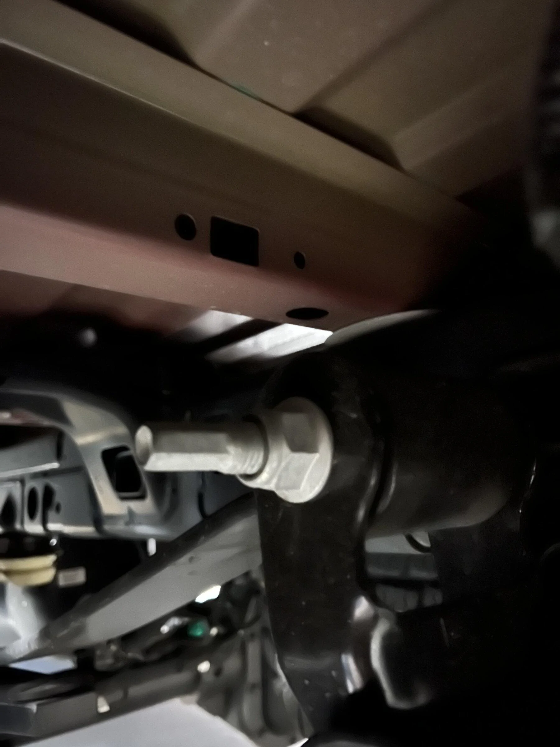

From looking at my 2021 and from what I have read, using the 2" drop shackles on a 2021/22 would require cutting into the bed support brace, since the leaf spring would hit it.
Ford F-150 Lightning Rear lowering shackles - prior gen fit 2021? IMG_7558

Had to trim a little for my Crown 2" nit that bug of a deal.
