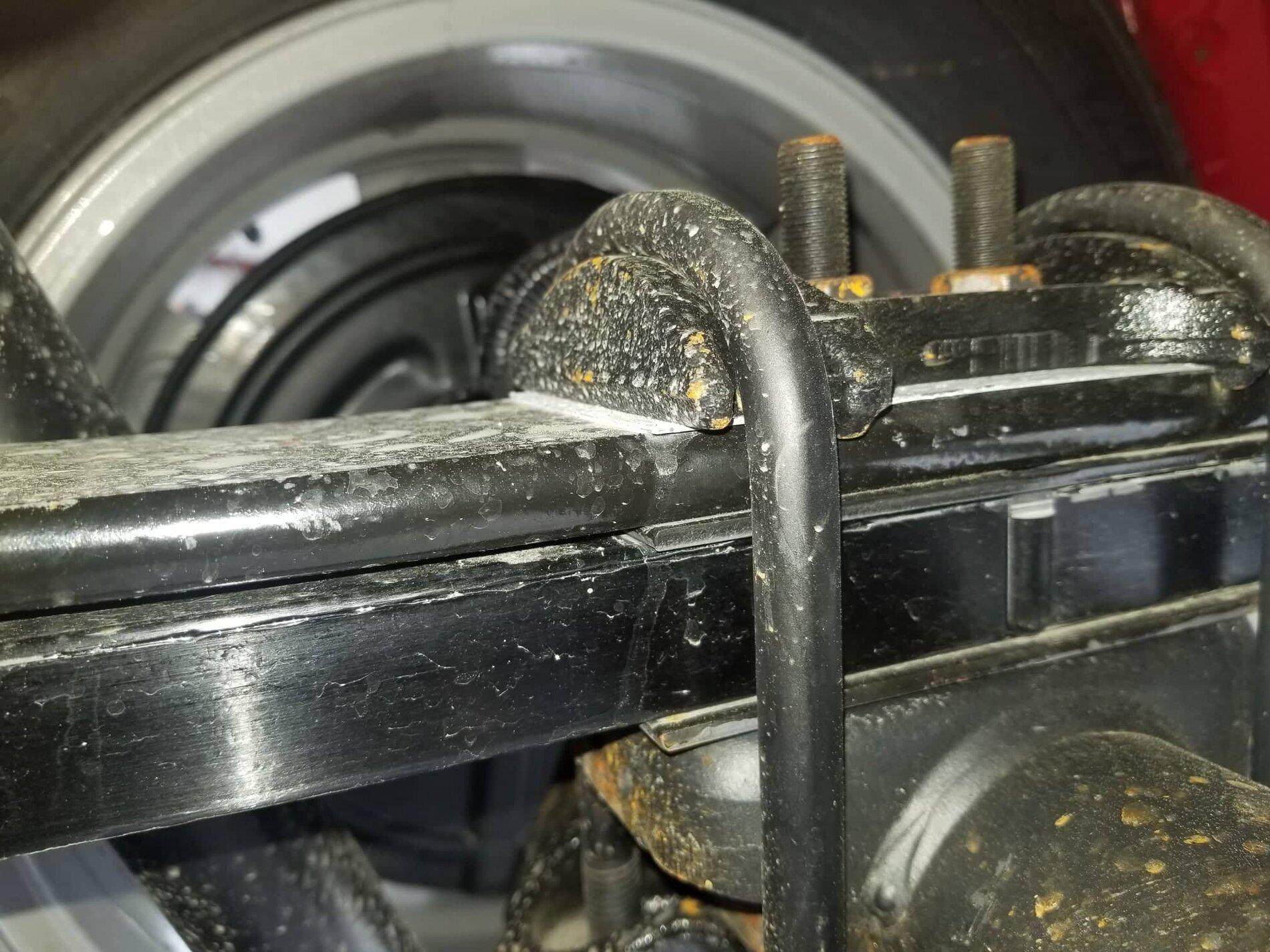

New member here, I’m going to remove the blocks on Monday and try the factory u bolts. I’ll keep you updated.

I removed the rear spacers from my 2018 XLT and it did not change the ride quality at all. I did replace the U bolts with the shorter ones but it was not necessary. The threads on the longer ones were long enough o accommodate but it looked funny sticking down under the truck.
Drove if for 3 years like that until I traded it in for the 2021.
How did removing the blocks work on your 2021?

I haven’t done it but saw on the 14th Gen FB page that someone did remove the rear block on a 4x4 and used the stock u bolts to tighten it all back up.

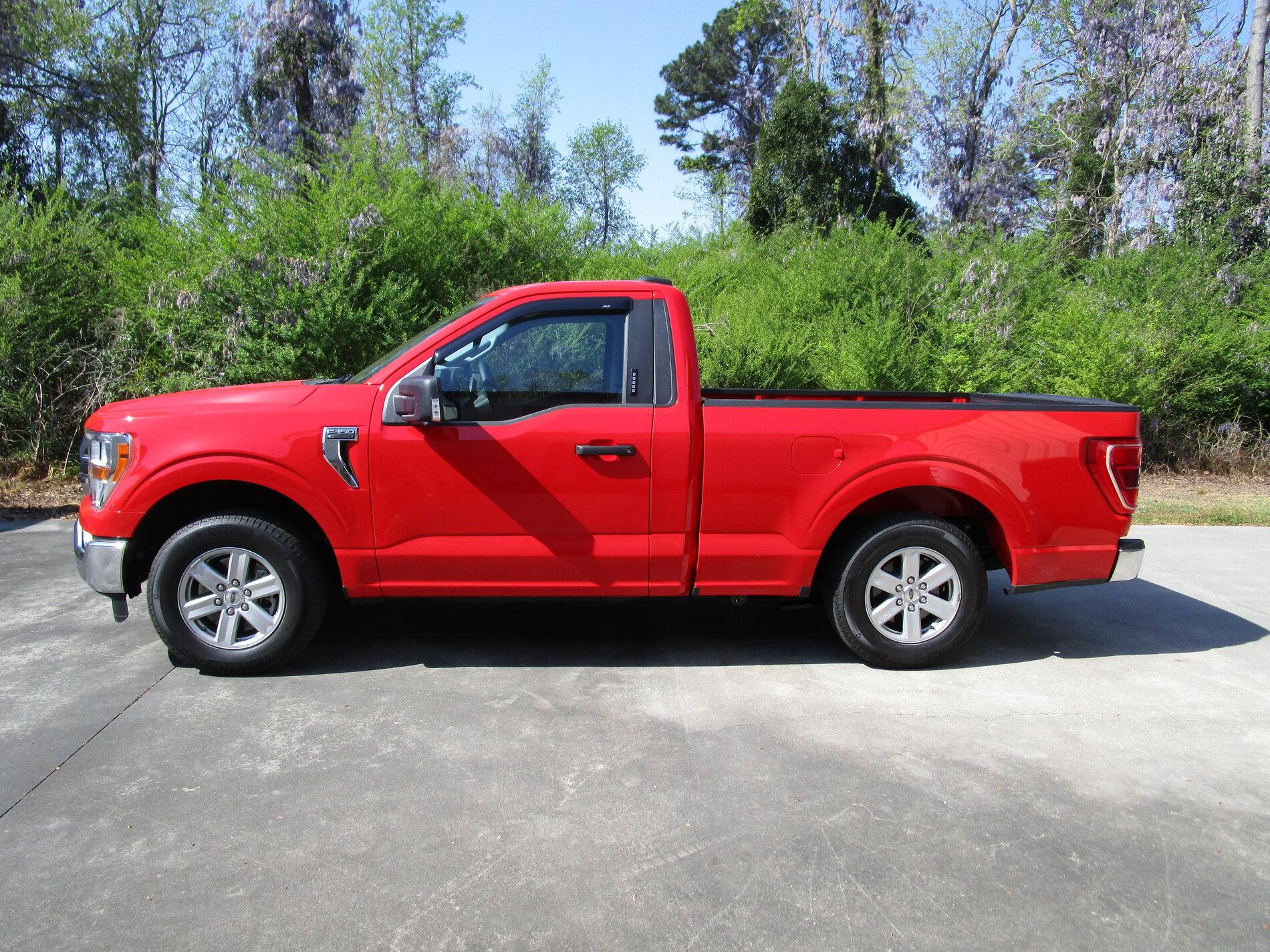

I installed Belltech's 4" flip kit #6447 on mine today. They would not say that it would fit the 2021 but everything bolted right up with no modifications. Kit dropped it exactly 4" as advertised. Took about 4 hrs to install.

Super cool! This kit does include different shackles, so maybe a shackle-only swap with the 15-20 kits (for a 1-2" drop) would work too... Seems promising. Nice RCSB btw, love it!
