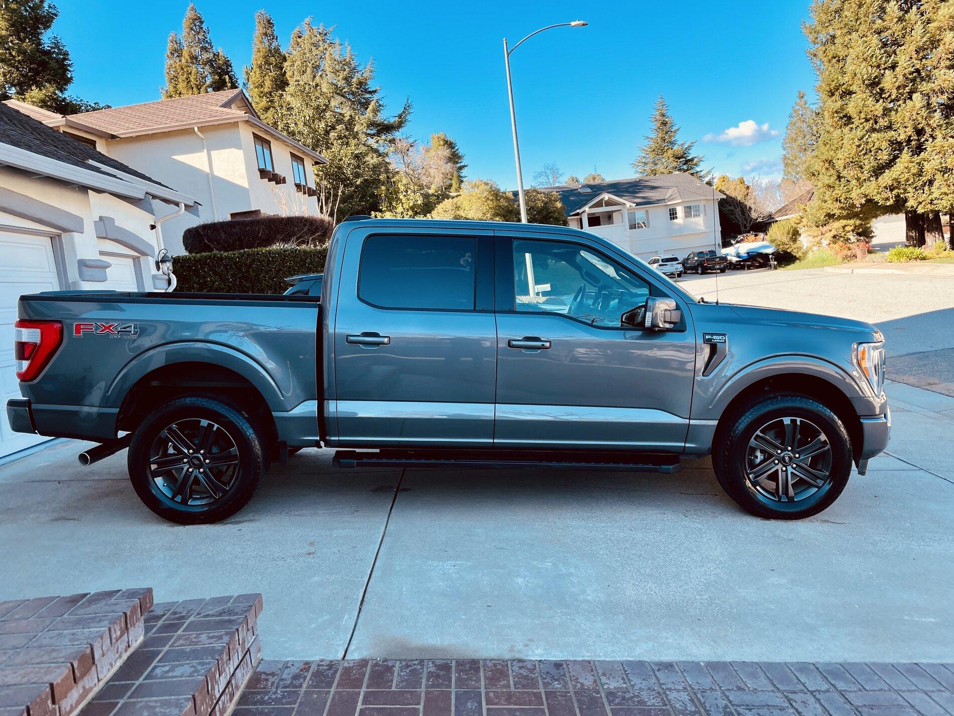

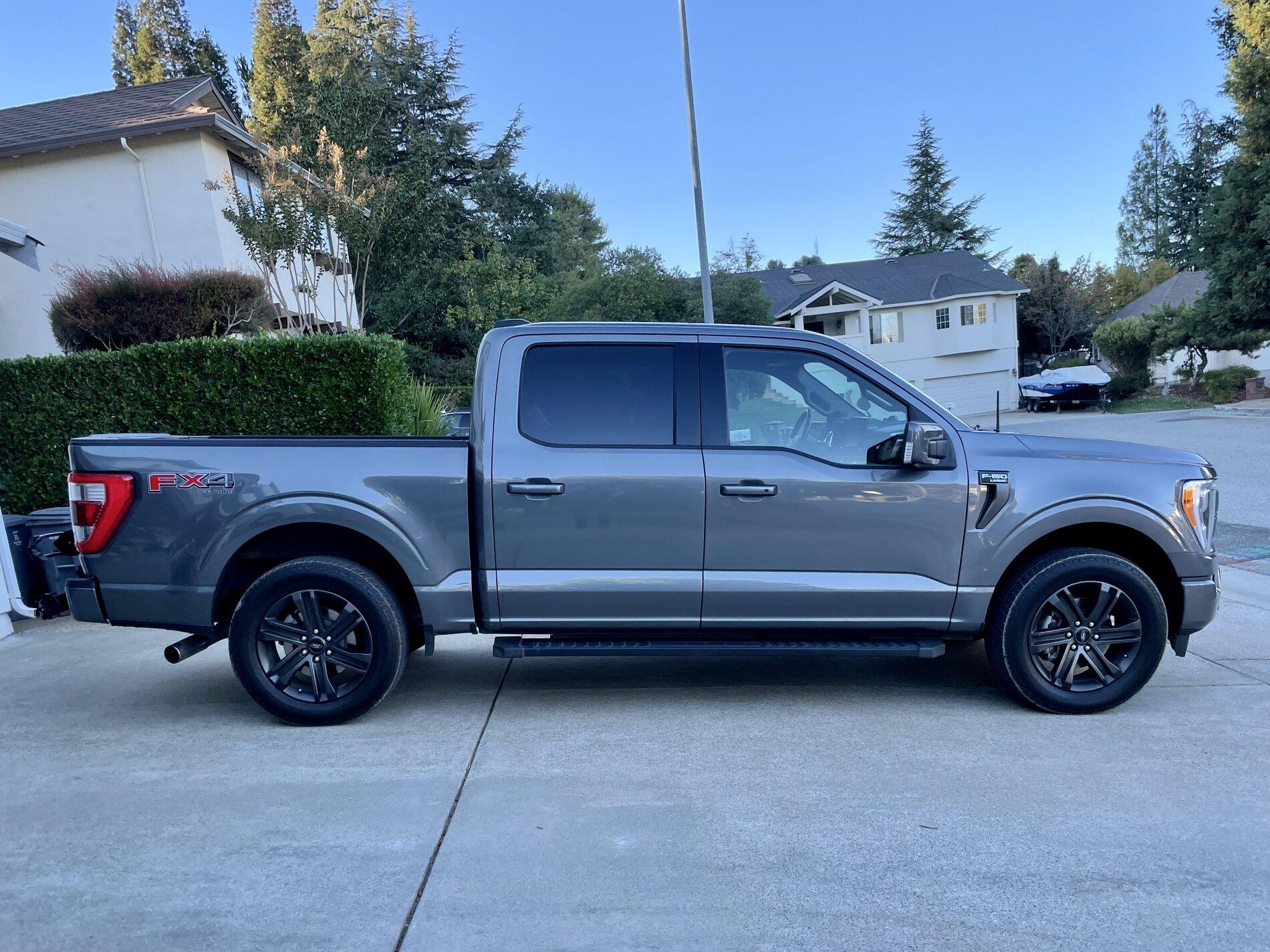

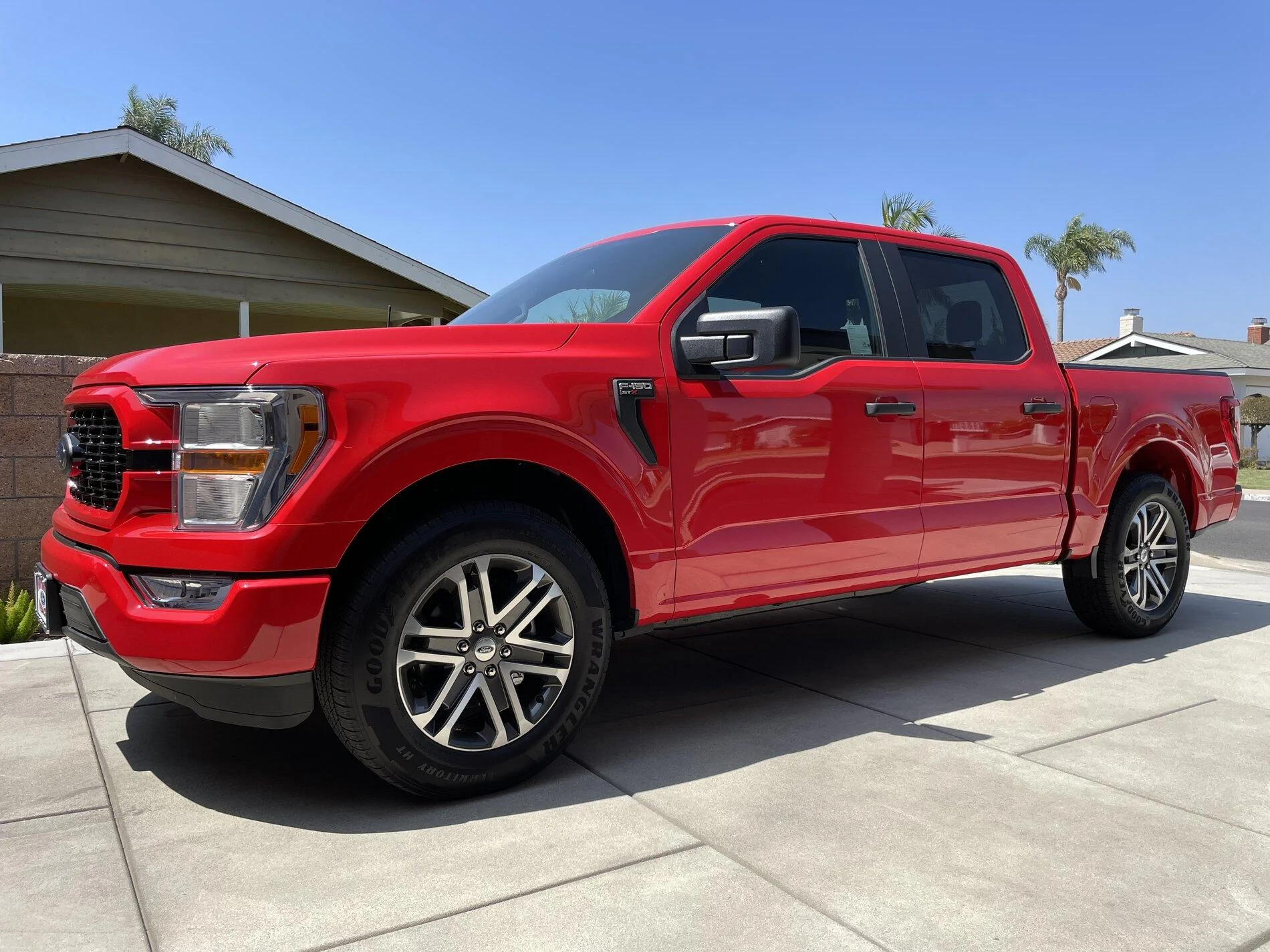

I installed Belltech's 4" flip kit #6447 on mine today. They would not say that it would fit the 2021 but everything bolted right up with no modifications. Kit dropped it exactly 4" as advertised. Took about 4 hrs to install.
In this photo it looks a little low in the rear, is that true or is it just how the photo was taken? Can you also measure the wheel gap for both front and rear so I can maybe get an idea on my truck?
Alex_Bo
Alex Bo
Feb 8, 2021
Morgan Hill, CA
2021 Ford F150 Lariat 4x4
Electro-Mechanical Engineer
It look too low. Must drive terrible. Maybe consider lowering the front or raising the rear a bit?
If you drop it with a flip kit, you will definitely need to lower the front at least an inch or else it will look like that.

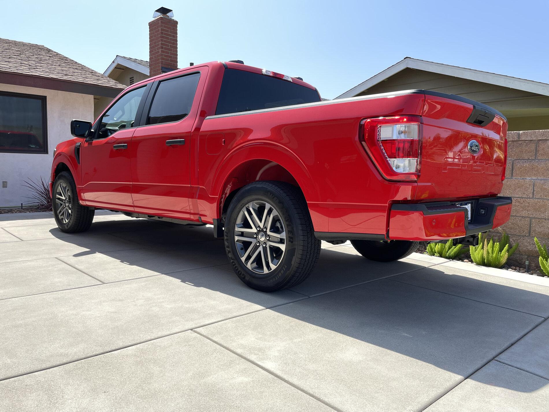

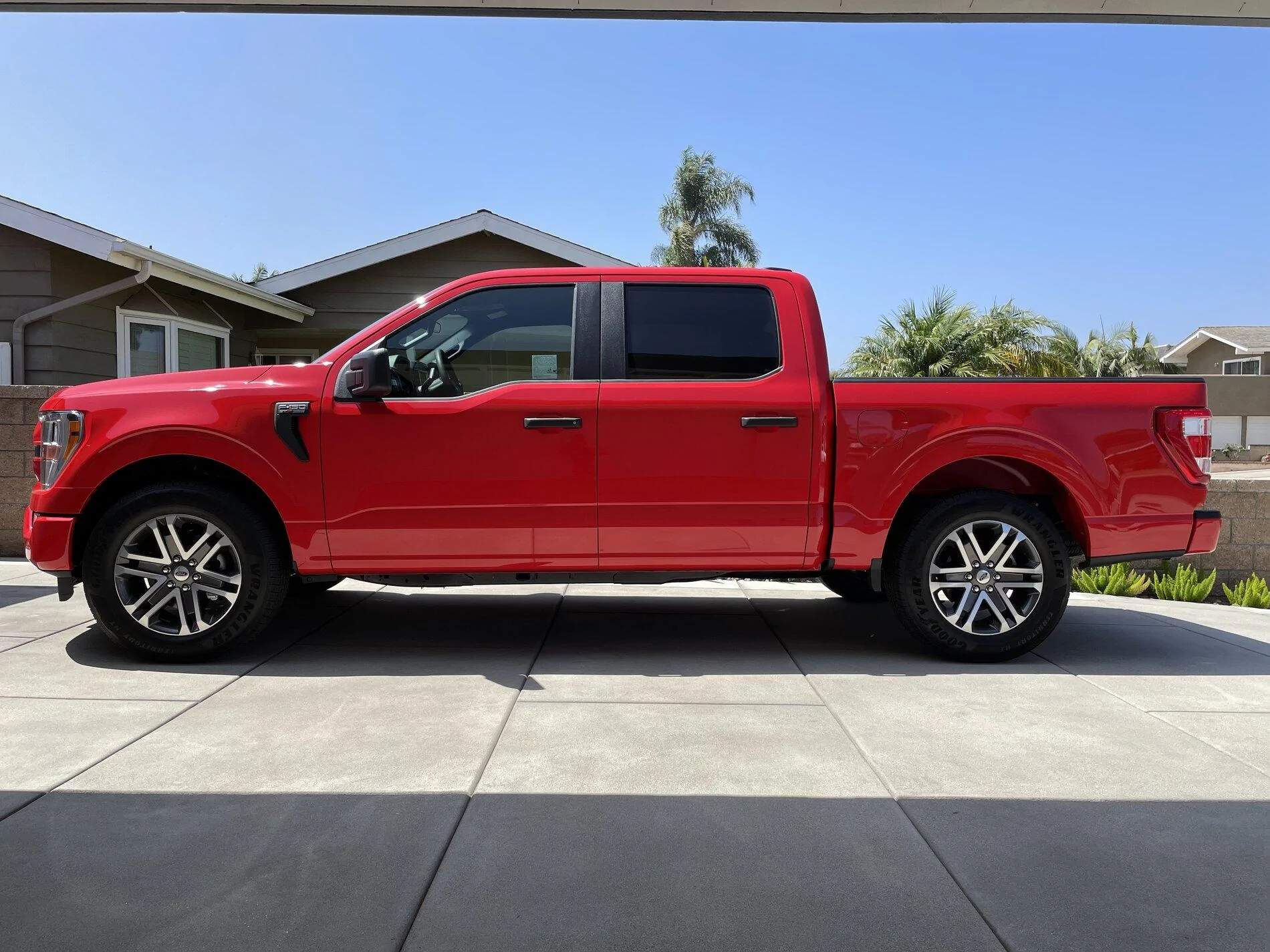

Alas! Finally found and installed the 2015-2021 Ford F-150 2wd/4wd 1.5-2" Rear Lowering Shackles - PRS-413710. Easy install. Looks great. I do feel the front end a little light while driving but something I'll get used to. Also, I will need to adjust the headlight down a bit...
Any vibration from driveshaft with change in angle? Do you think this kit is better than Ford Performance kit that includes wedge for driveshaft angle that gets installed in spring pack?
I didn't know there was a Ford Perf kit available. I would have gotten that one instead. For sure it is probably better.
No vibration I noticed. I did notice the auto pilot is acting a bit weird not. It seems to skewed to the right side of the lane when cruise is engaged for some reason. Maybe system needs to be recalibrated or something do to the ride height adjustment? Also I will need to adjust the headlights down a bit to compensate lowering the rear.
