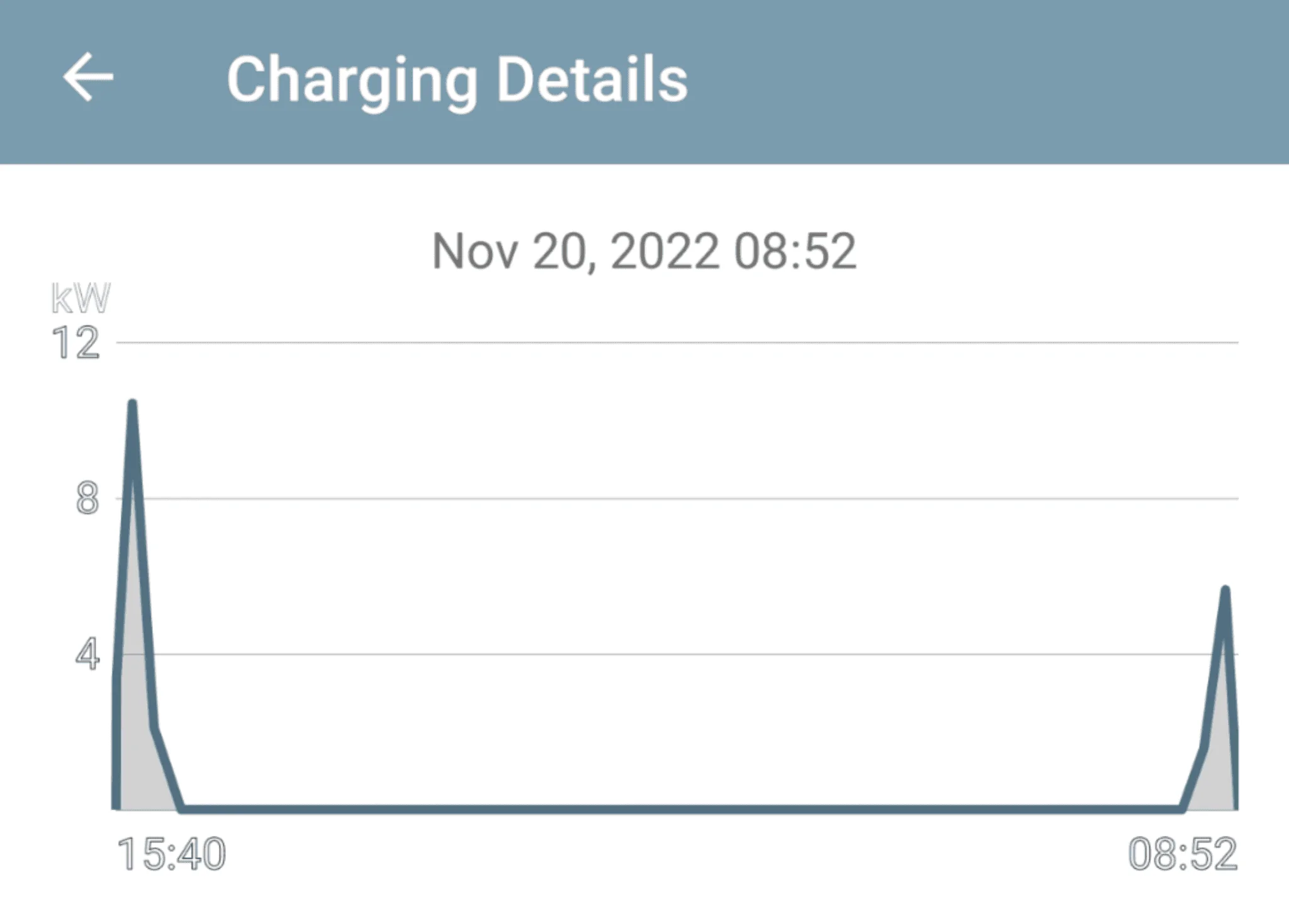

Thank you. I'll try the same experiment but it will have to wait until next week as I'm off-peak all weekend. Off-peak, FP is happy to have my HomeFlex charger do the work. On-peak? Maybe not.
This is what it looked like last Sunday, all off-peak.
Ford F-150 Lightning Scheduled Charging and Departure Times/Remote Start Screenshot_20221126-104423

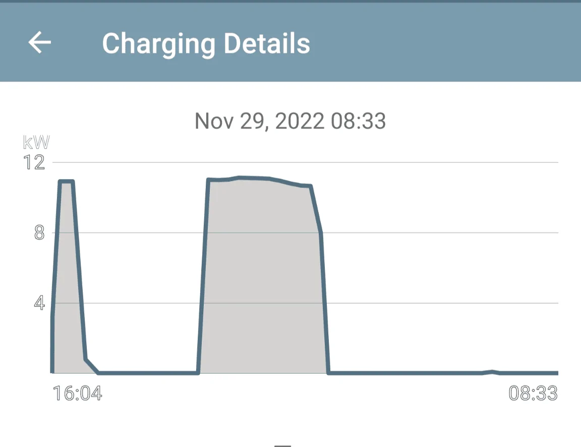

Where does the energy come from if I ask the truck to precondition during an on-peak time?
- Plugged in at 16:15 during PM off-peak hours
- Truck charged until 17:00, which is the end of the PM off-peak hours
- Truck resumed charging at 21:00, the beginning of night time off-peak
- Charged until about 02:00 when it reached 90% target
- Off-peak ends at 07:00
- Departure time set for 08:30
- OAT 36F, so truck wants to be preconditioned (presumably)
- At 8:40, cab is cold, no indication that preconditioning occurred.
- Between 07:00 and departure time, I did see a reduction in distance-to-empty of 5 miles. There was no apparent exchange of miles for cab heat; could this have been a tiny bit of energy expended to warm the pack?
This is only one experiment but it indicates that the TOU restrictions in FordPass will not allow you to use the grid/EVSE to provide the energy needed to precondition for a departure time set in on-peak hours. Do you buy that @TaxmanHog?
Next question: in the above case, will the truck expend a significant number of miles-to-empty to precondition itself?
Ford F-150 Lightning Scheduled Charging and Departure Times/Remote Start Screenshot_20221129-102533

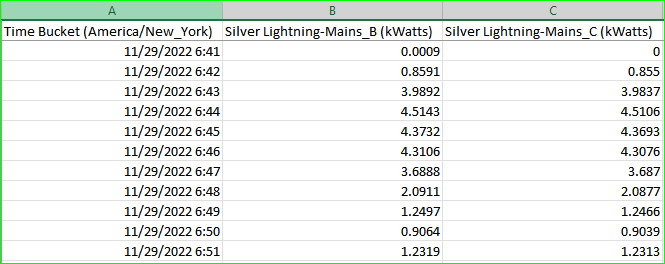

My wife messed up my plans to test pre-conditioning this morning, she wanted to hit Market Basket at 7am, so I started a round of remote start while plugged in at 06:42, in this operation the truck was programmed with a made up TOU schedule to avoid charging from 4am to 9am. The truck started and preconditioned the cabin, including the steering wheel warmer, all was comfy when we left.
by the minute
