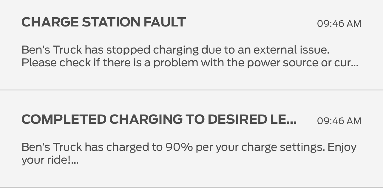

Just noticed a related bug, if I charge on a 120V charger to anything below 100%, then immediately once charging is complete the truck reports a charger error ?‍♂
Ford F-150 Lightning Scheduled charging broken for 120V chargers only? Screenshot 2023-06-24 at 10.46.39 AM
