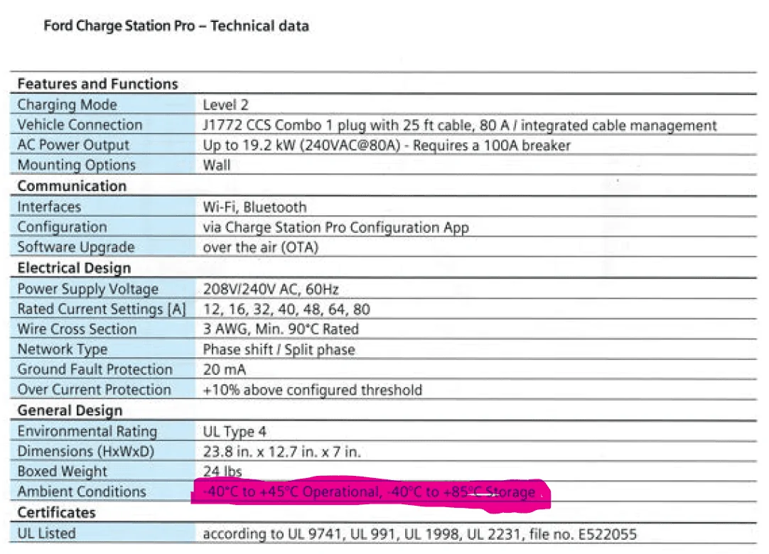

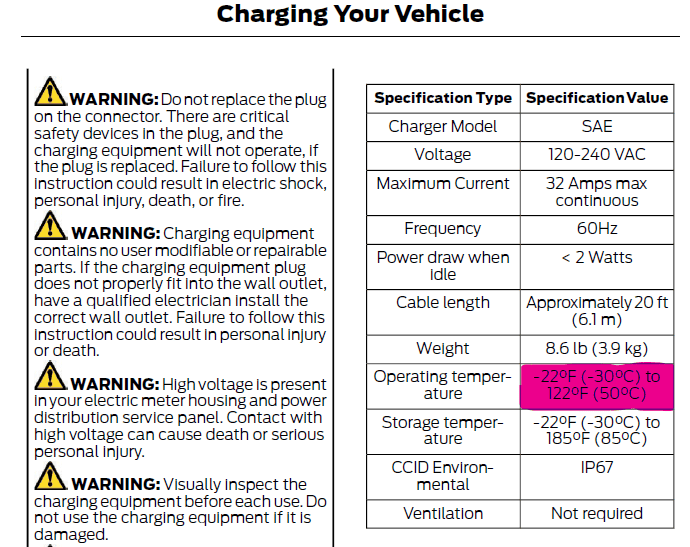

WattTruck
Jan 26, 2024
Still Looking
Thanks all. @mefly2 appreciate the experience. Do you think other than the cabin heating and pre conditioning it would have worked in that cold? Or did you perhaps notice if it was still charging but just not keeping up with the heating load? I am trying to figure out if it will ever not work at all. But if it charged down to -22F (albeit slowly I know) at least I’d know when I could count on it and not.
It typically stays above 0 in my garage. But I’m also curious about perhaps plugging in at something like a workplace.

@mb0220 Sounds like good news to me, if I’m reading right it was still charging at 0F (but not keeping up due to distance and cabin heat I’m guessing). If it’s still charging down to zero that’s well on the road to getting close to what I’d need (rarely might have to / want to charge lower) but I guess per specs -22F is the limit.
@Calvin H-C does 120V indeed heat the battery in cold? I had thought that was only on 240 but could be mistaken.

Thanks @Shawnson - have you found 0F to be about the limit? Have one account of successfully charging at 0F so maybe that’s the lowest it will go? Appreciate everyone’s input.
