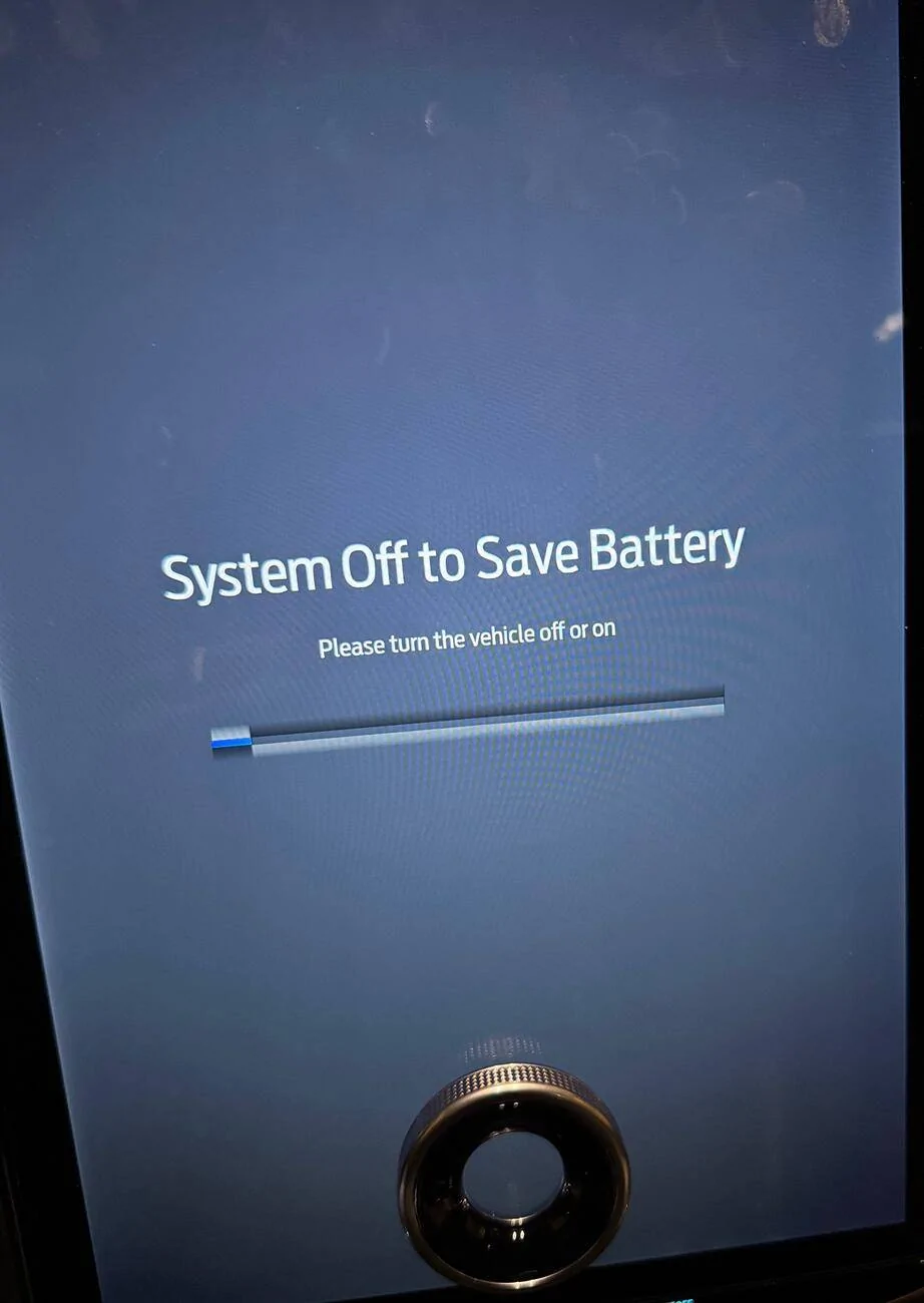

I recently had my truck in for service for a software upgrade to fix an issue with the parking sensors. The service advisor mentioned the factory recommended additional updates which they installed. Ever since then, I get a "System off to save battery" message when I turn the truck off. I also get messages in the app stating I have to drive the vehicle to reconnect. As a result, the welcome & dome lights don't come on when I unlock the truck (I verified the setting is on).
I read on here that a weak 12V battery could cause this issue, however mine is just over a year old and I tested it with a meter and it read 14V. So, I don't think this is the issue.
Is anyone else experiencing this issue? Any recommendations on solving the problem?

Your battery is not 14V. You're testing it with the truck running...
The reality is that doing the updates, they drained your 12v. Either they did this by not hooking up the required 12v power supply, hooking it up incorrect (to the battery not jump posts), or similar.
Two choices - drive a bunch or put your 12v (via the jump posts) on a Battery Tender.
Mine was in early October. Tech is very knowledgeable. I got the same message... Drove it, went away.
