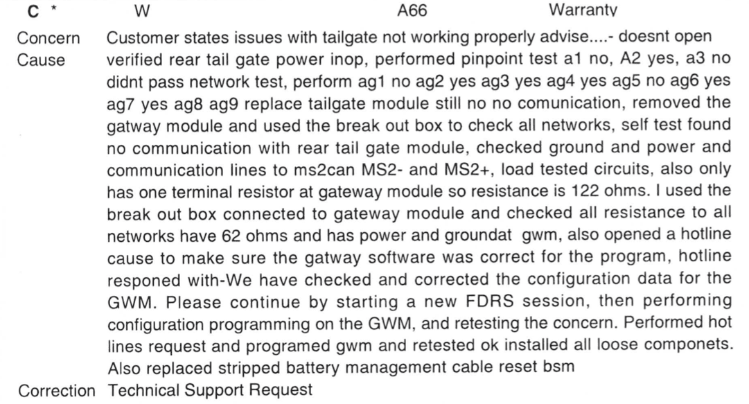

It took 2.5 weeks at the dealer, but yes, it is resolved now.
They replaced a Control Unit, MU5Z 14B291U
Also, they had to correct and reload the configuration. Here's a scan...

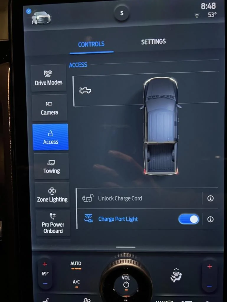

Does the Controls-Access screen show the tailgate?
Mine just shows the frunk even after the tailgate started working again.

Answering my own question: no the Access screen does not show the tailgate based on this Sync 4 walk through (15:17):

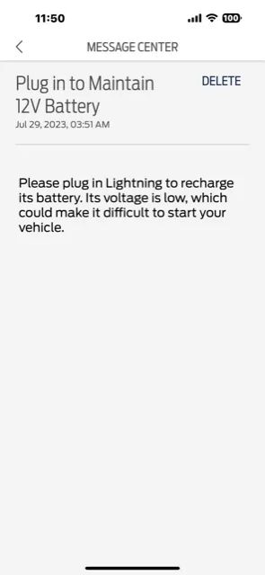

Today I went out to get something in my truck bed (have a locked topper) and the tailgate would not open evening running. It didn’t matter if I use the remote for the open button inside the truck. Interestingly, when I first got in, I had a message on the screen that said something like battery save mode. Anyone had this problem? I guess I need to take it to the dealer.

This is the message. The truck is fully charged. Also tried to manually open the tailgate in relation to the previous post.
