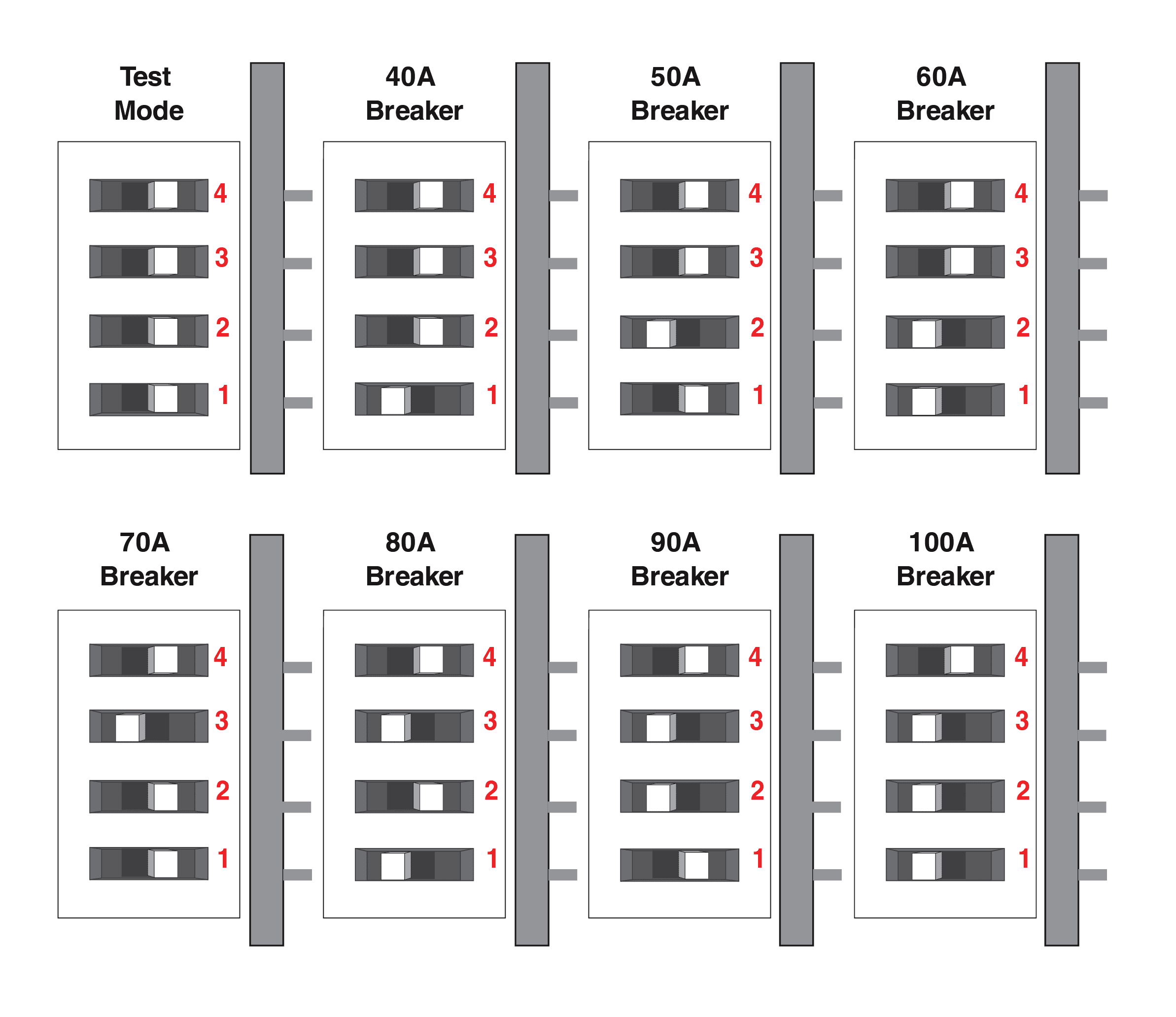

All settings except 80/100 will work on HPWC1, but as I noted just above, you won't get that. The absolute maximum I could get the truck to charge at was 24A with the 72A/90A setting, confirmed by my OBD2 monitoring.
OK, more than a little late to the party on this one, but, I might have just figured out what you and I saw with these chargers at "72A".
According to the Tesla docs page there are two versions of the Gen1 HPWC. The 72A DIP switch settings for one are the settings for 24A on the other...
https://www.tesla.com/support/charging/product-guides#gen-1-wall-connector
The 64A setting on both models is the same, as is the 80A setting. Next time I'm where that lonely old Gen1 of mine lives, I will try setting it to 64A instead of "72A" and see what happens.
And that's why you should always have a file drawer of all your manuals!
Fascinating catch/discovery about DIP switch settings between the two different V1 Tesla HPWC versions.
I tried every setting possible and it was with my original manual. The PWM signal was incompatible, and the maximum that the truck would charge at ANY setting was 24A.
