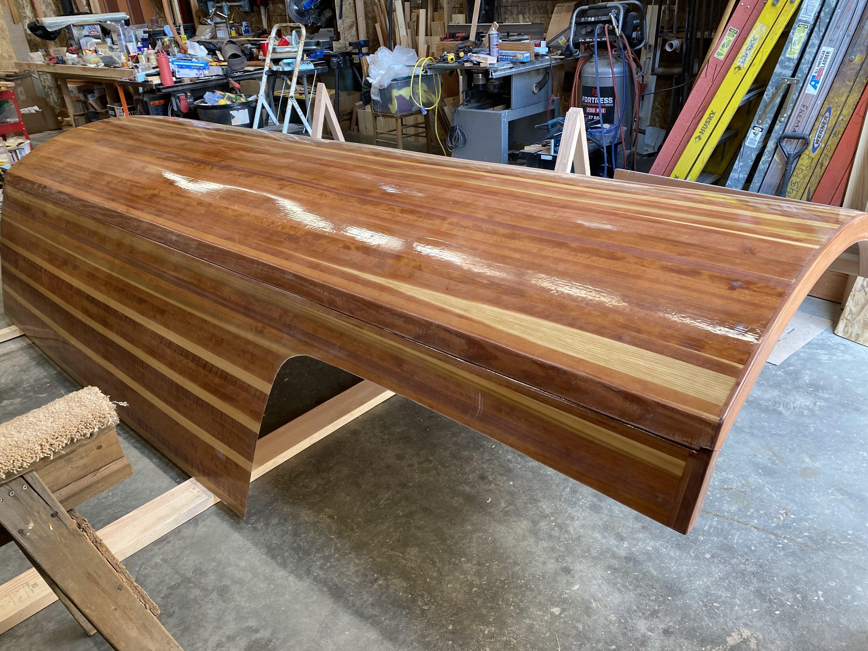

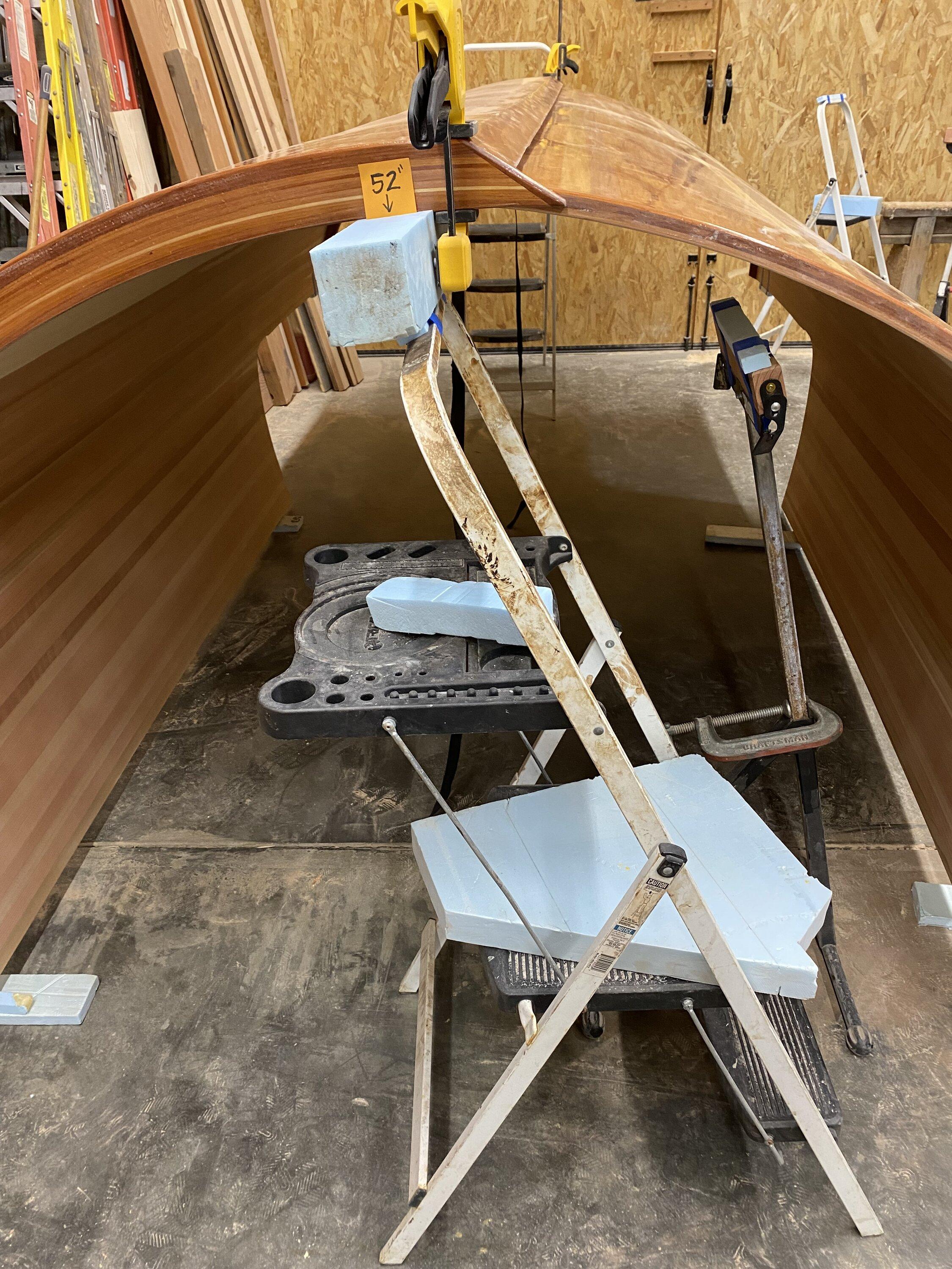

Nice job Ken. Coming from a slightly different approach, I’m working on an aerodynamic expandable redwood and cedar strip fiberglass shell. I still have a long way to go, but if you’re willing to share, you could save me a bunch of time and work if you could pass on links or ordering info for your sink/pump/water heater/water tanks, fridge, cooktop, cassette toilet, and memory foam mattress. Just about finished with the two overlapping panels, and soon to start the half nose cone, over the cab venting window, and over the tailgate screened entry door.

Awesome, and thank you. Yes, I’ll post photos once I get it all finished.

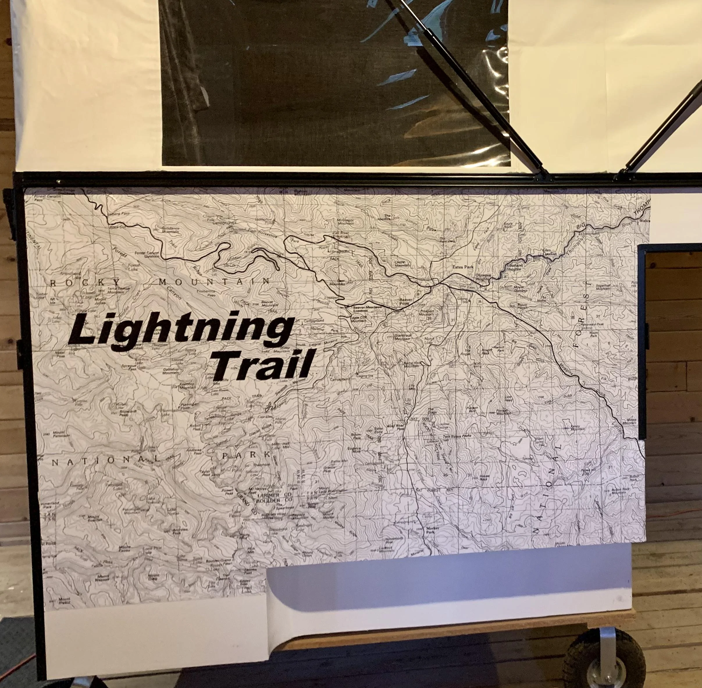

Playing with some graphics options…

Wow. Just wow.
