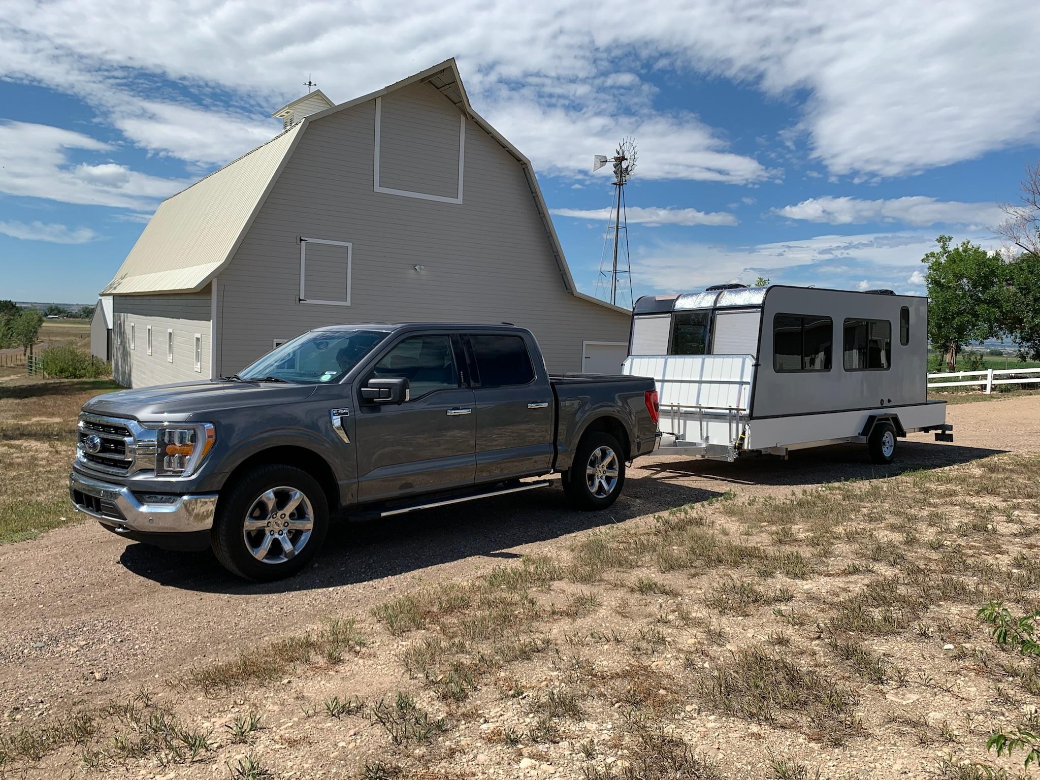

To clarify, the 'CampinBoat' was my winter '21/22 project. The Lightning camper was my winter '22/23 project.
I will say that I designed/built the solar-powered CampinBoat to be towed by my highly-anticipated Lightning, as part of my dream of low-carbon touring and camping. Then the reality of significant range reduction and (perhaps more importantly) the lack of pull-through charging stations made me postpone those plans. That's when I decided to build the Lightning camper.
I'm still working on the CampinBoat, and after finally receiving the electric motors for it in January, hope to put it on the water this summer, locally towed and launched with the Lightning. And my fingers are crossed that we'll see LOTS more pull-through charging stations in the near future so I can float the Erie canal and 100 other places I want to explore in this country.
