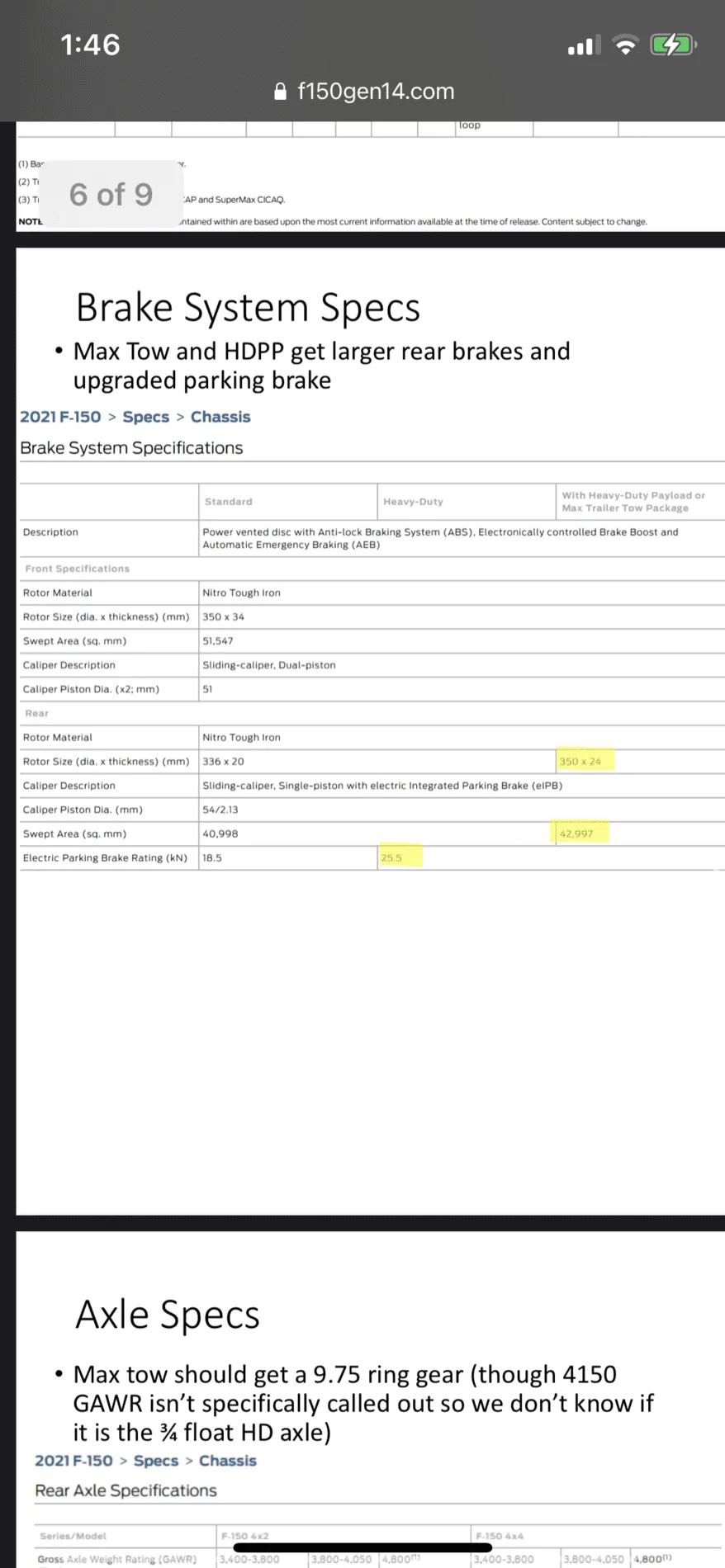

The thread was started with a document. That consolidated much of the known info.

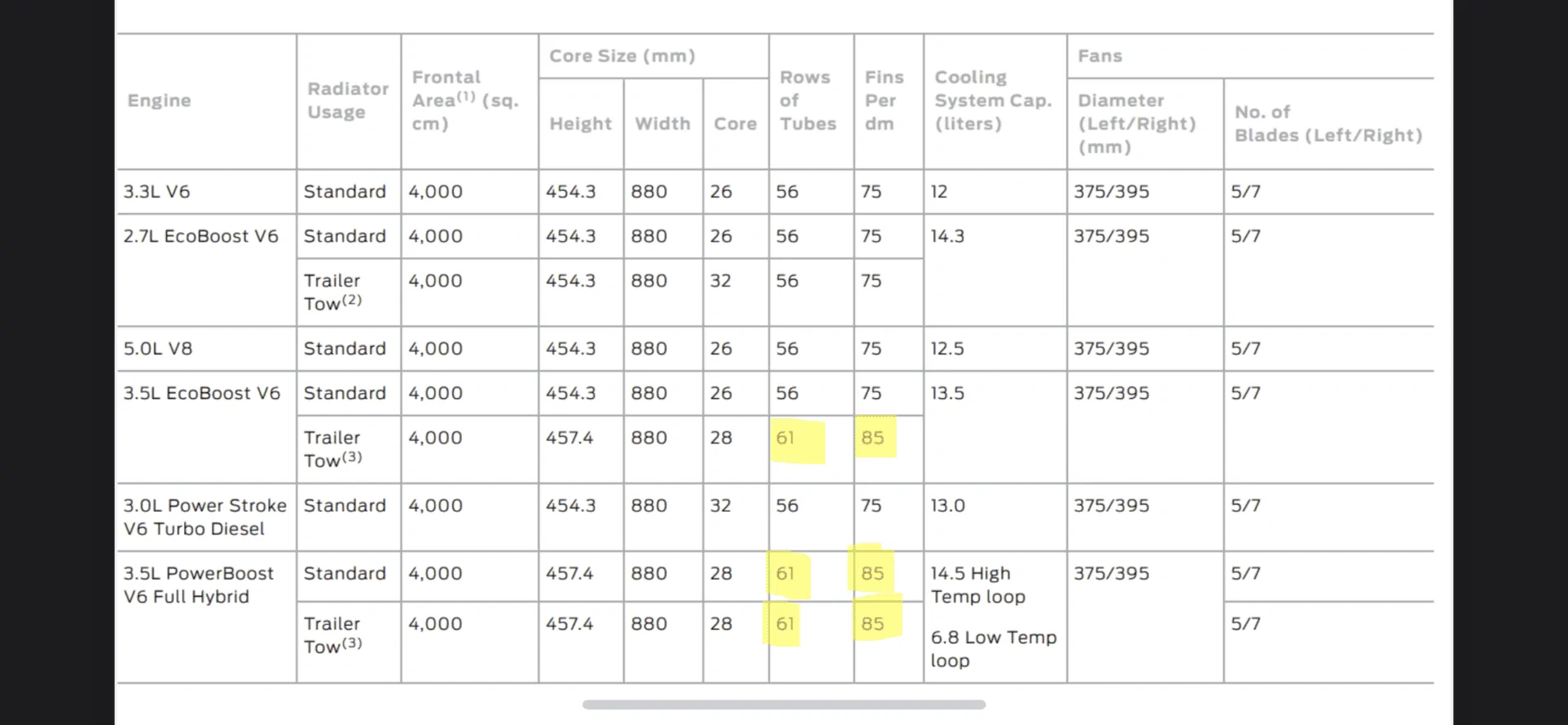

For starters, you don’t have the larger radiator, which is needed to pass the SAE tests with a 3.5 Ecoboost. It is rated for 7,000lbs. The chat people literally know nothing and are not engineers.

There is nothing to “credit” for 17T. It doesn’t increase capacity. Beyond the radiator, the parking brake is also different. “Trailer tow” is referred to as “heavy duty” in the esourcebook and the owners manual.
Ford F-150 Lightning Towing Specs Consolidated Document - Bumper vs. Class IV vs. Tow vs. Max Tow - UPDATED DOC v4 AD4B8991-F940-4C3C-AB85-9FF4DE25AC27

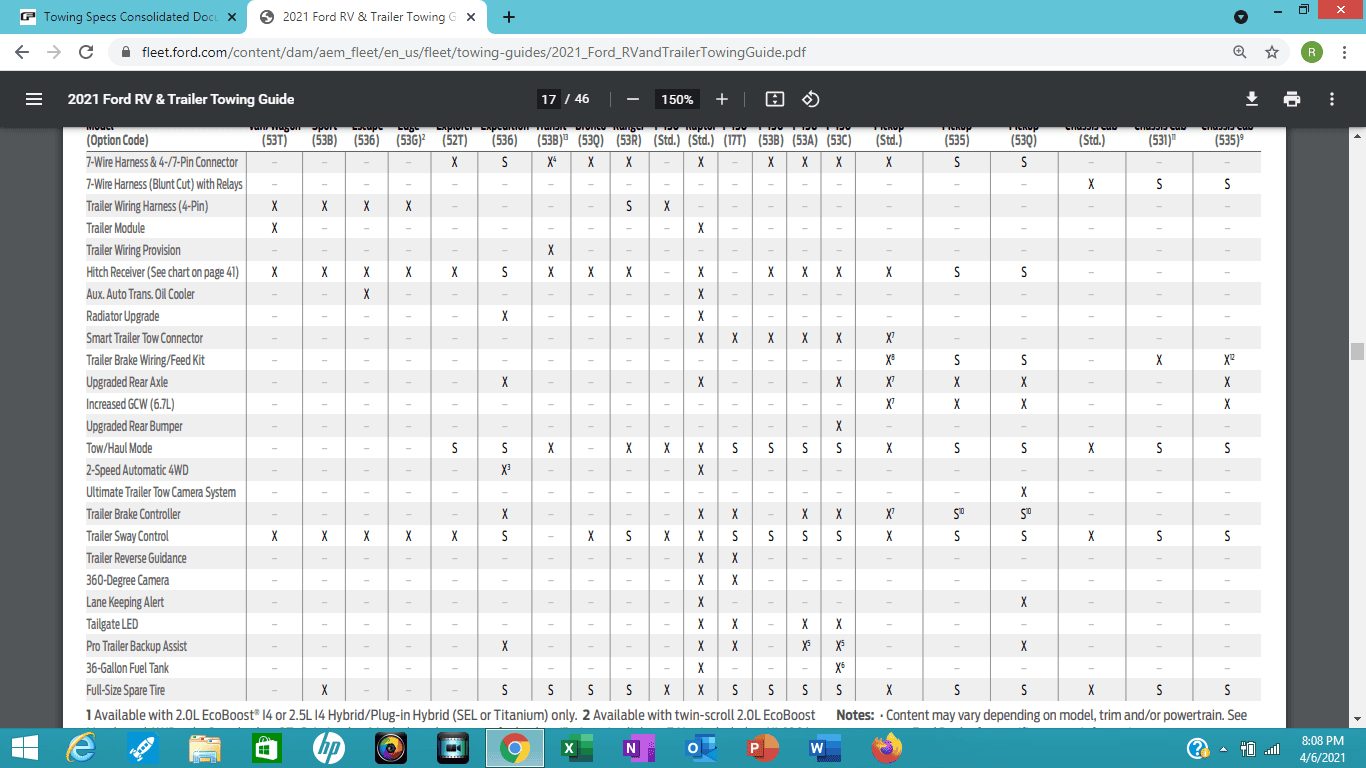

Again appreciate your work on this Timmay and per your comments will remind you that while this thread began with consolidated documents and information which have been a great help it also included some inaccuracies and uncertainty throughout the duration of the thread. The vin tool seems to have greatly bolstered the collective confidence in the actual tow ratings. Of course that is if we can trust that it's actually accurate - After all why wouldn't we? I appreciate you providing the attachments / specs and you would think for a 4k lb difference the ford rv and trailer towing guide would reflect a radiator upgrade and e brake differences for the packages that include the upgrades - they do not for whatever reason. I've looked for those spec sheets you provided - please remind me where I can find them as I want to show them to the dealer / mechanic. If I remember right it was from some system the dealers have access to.
In the mean-time I'll avoid those non-engineer chat box jockeys... :)
The links at at the end of the document. Itself.
mother than the sway bar size, I think everything is accurate. Parking brakes, brake sizes, radiators, that’s all legit.

I'm chiming in...from my other posts on this topic... your guide shows me two differences i see for my scab xlt 2.7t 302a with tow tech vs buying the tow pack and 360 cam: the pack would give me a solid stabilizer bar, vs the hollow. and it would give me a radiator with 32 core instead of 26.
which i don't know if it means crap to me... but if that's all; there is... it sure wouldn't ding my mileage. conversely...good friend pointed out if i'm not towing stuff that needs that capacity now... don't screw with overthinking my order the way it is.

Question for you all:
I ordered a Powerboost with Tow tech.
This means I have compared to trailer tow package (not max tow)
- same larger radiator (standard on powerboost)
- same transmission (all have same oil coolers seems for 2021)
- same 7350 gvwr frame (same for all PBs)
- same rear axle (4150 gvwr according to the rear axle specs on doc)
- same rear bumper/hitch rating (not upgraded until Max Tow)
- same driveshaft ? not sure about this one
- different front sway bar (hollow sway bar)
- different parking brake (slightly smaller)
So this means that the only difference from my truck to a trailer tow Powerboost (7000lb to 11000 lb tow capacity), is the sway bar and parking brake.
If I add a hellwig rear sway bar, I think I should be good to tow up to 11000 lbs right?
So what I'm not getting with this whole debate is, what's the hitch say? I have NO trailer tow.paclage, no max tow, no 360 cameras, no brake controller, no anything to do with a tow package BUT I do have a Lariat 501a Powerboost which comes standard with the class IV hitch and BLIS, and we all know Powerboost payload is 7350 and my available payload is 1450, according to everything I read and everyone here, max towing for me is 7000 lbs.
My hitch clearly says max weight is 11,600 with weight distribution hitch so what do I believe? I cant seem to wrap my head around this 7k lb max unless it was a XLT or below that doesn't come standard with the hitch and smart connector.
