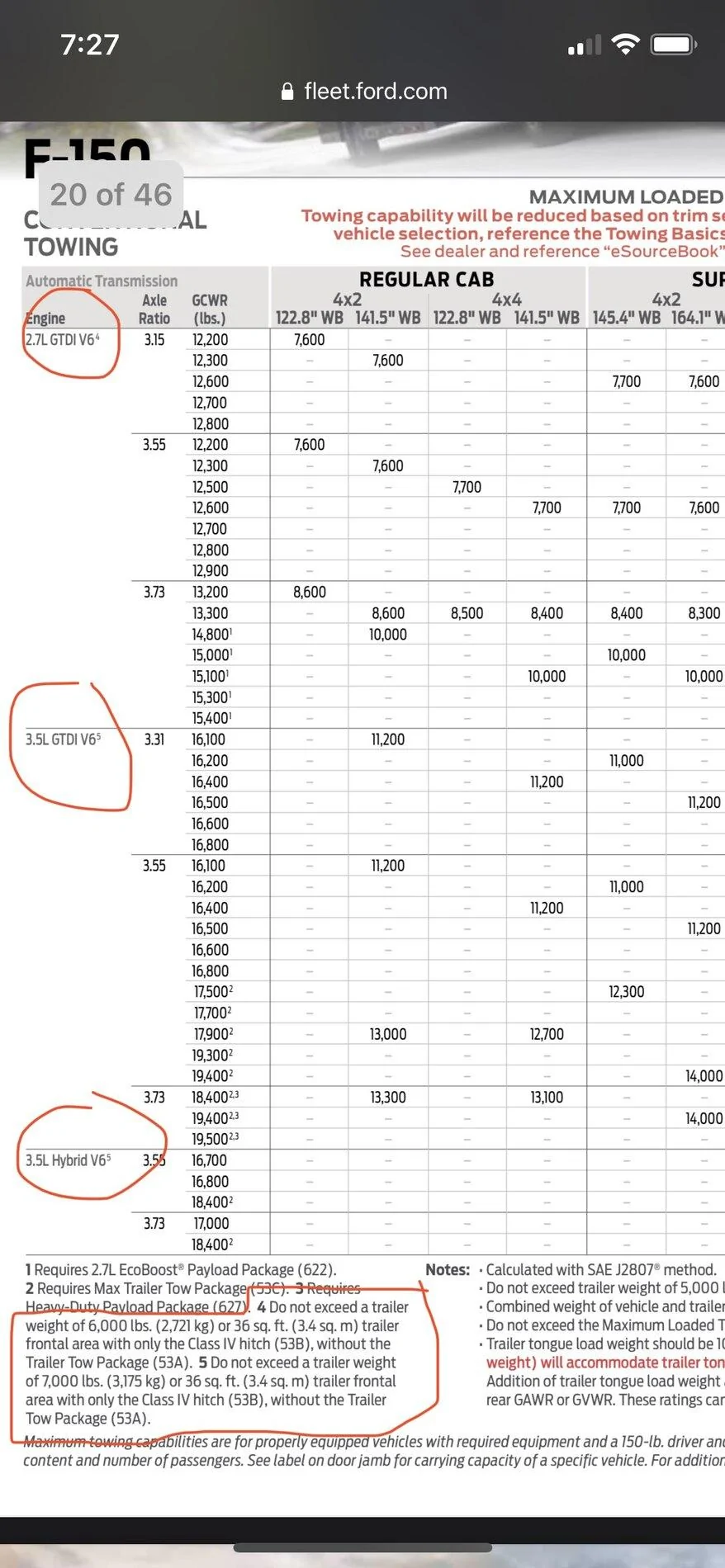

@solarity

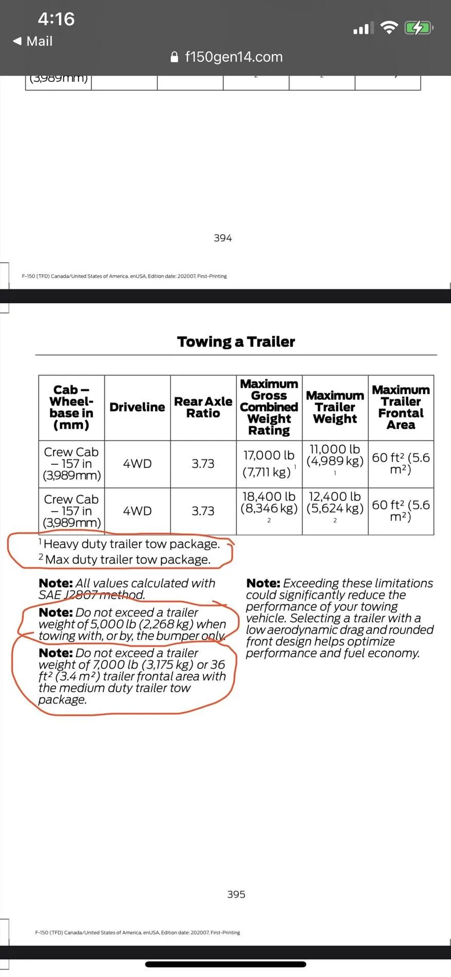

I found this in my user manual. I see 11k being the lowest.
Ford F-150 Lightning Towing Specs Consolidated Document - Bumper vs. Class IV vs. Tow vs. Max Tow - UPDATED DOC v4 4990198B-A992-408C-B13F-351241D0EE66
Next page it continues and gives you this: medium duty is a class IV hitch, heavy duty is “trailer tow package” and max duty is “max trailer tow package”
With the powerboost, it’s 5,000 on the bumper, 7,000 with class IV hitch, then your tow/max tow as noted based on your configuration.
Ford F-150 Lightning Towing Specs Consolidated Document - Bumper vs. Class IV vs. Tow vs. Max Tow - UPDATED DOC v4 44C8E26D-84E2-45AF-BCE6-6095AB0475B7

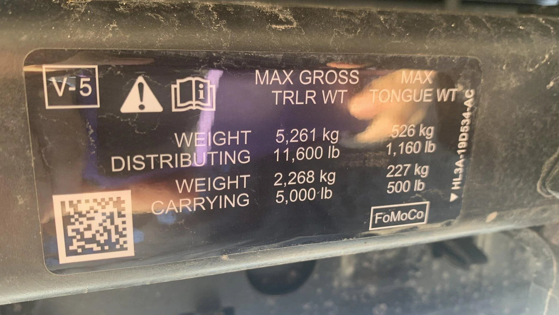

Hi, I’ve been following this thread and agree the dealerships do not have a good idea of what the tow rating of the V6 powerboost Hybrid 3.5L actually is. What has my curiosity is why label the bumper 11,600. (See photo attached) if it’s 7,000 max according to footnote (5) of the 2021 F150 towing guide, why isn’t that stated anywhere on the sticker (see pics) door (see pic), hitch? Very odd marketing scheme, especially when the salesman don’t know either. It’s a slight misrepresentation of facts.

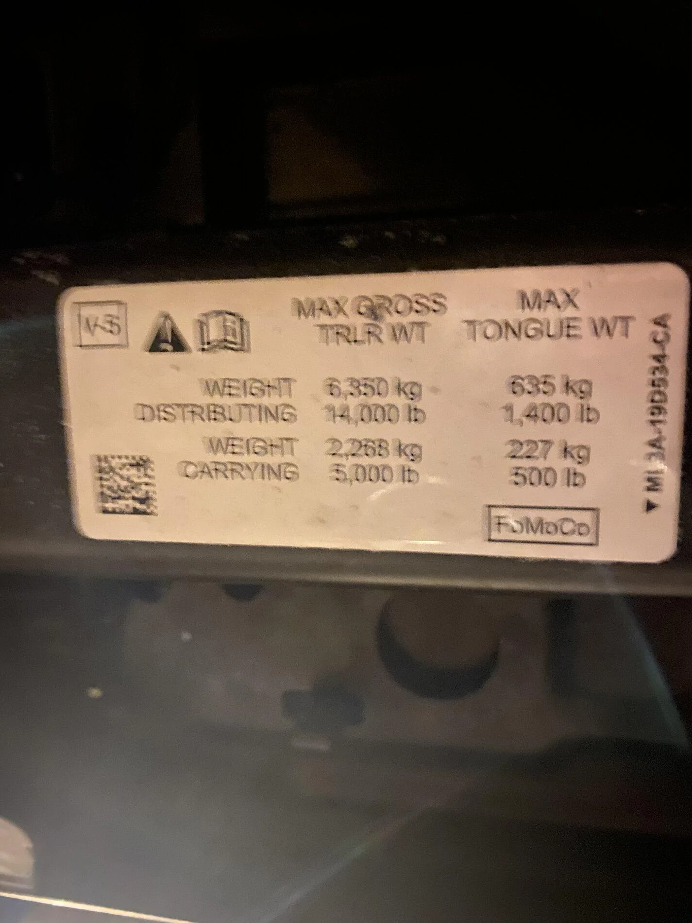

It’s a “weakest link” thing. The hitch can take that’s but you don’t have the stabilizer bar up front for the truck to be rated to that amount. Mine says 14,000 but my truck is rated for 12,400lbs.
