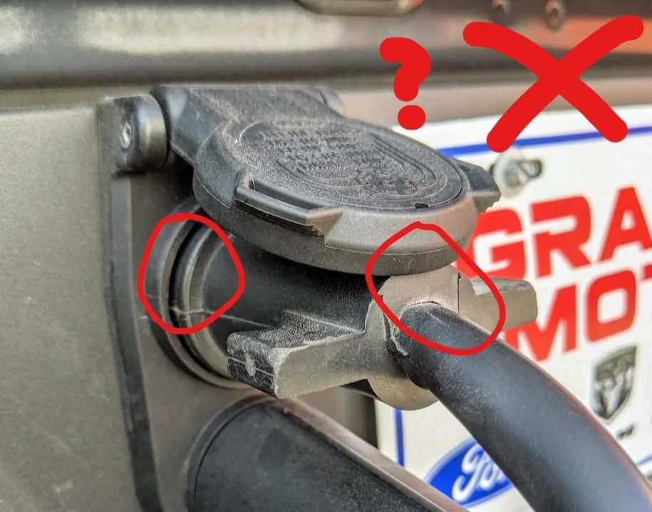

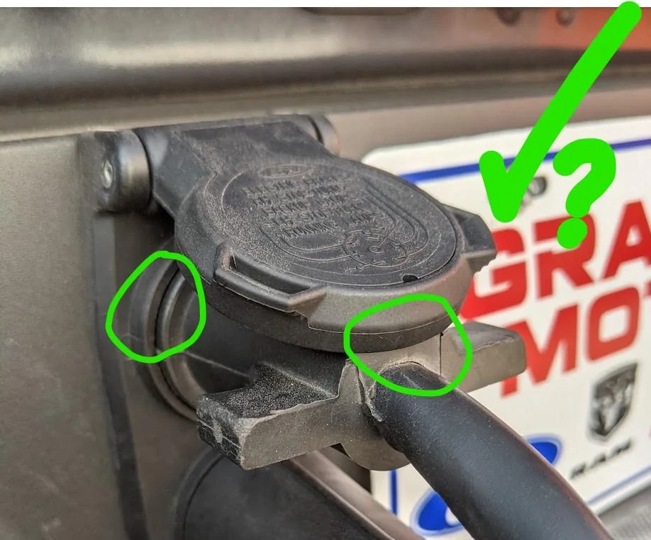

So, I went back to the trailer to check again today (prior to heading to dealer on Monday) and now the trailer brakes seem to be working whether the trailer is plugged in when truck is off/on etc. I couldn't make the problem appear ....
I did notice something - there isn't much "feel" in whether the connector pins are engaged with the plug at all and in fact it's possible to insert the trailer plug into the truck connector and engage the locking "latch" without the connector really being fully plugged in - it will still have some play which I would assume mean the truck-side male connector pins are not fully inserted into the trailer-side female plug. To fully connect the trailer plug requires some force and wiggling the plug!
I've attached some pictures below which show what I mean .... notice the different positions of the locking "latch" lid on the end of the trailer plug and also the difference in gap between trailer plug and truck connector.
Anyone else have this same thing? If your trailer brakes don't work, try *really* pushing the connector home so that it's solidly connected? I've never had this problem before on any truck/trailer combo. Seems to me like the dimensions on the truck-side connector and the "latch" may be poorly designed - they allow the plug to feel like its inserted, and the latch to engage without the truck-side pins being fully captured by the trailer-side?
