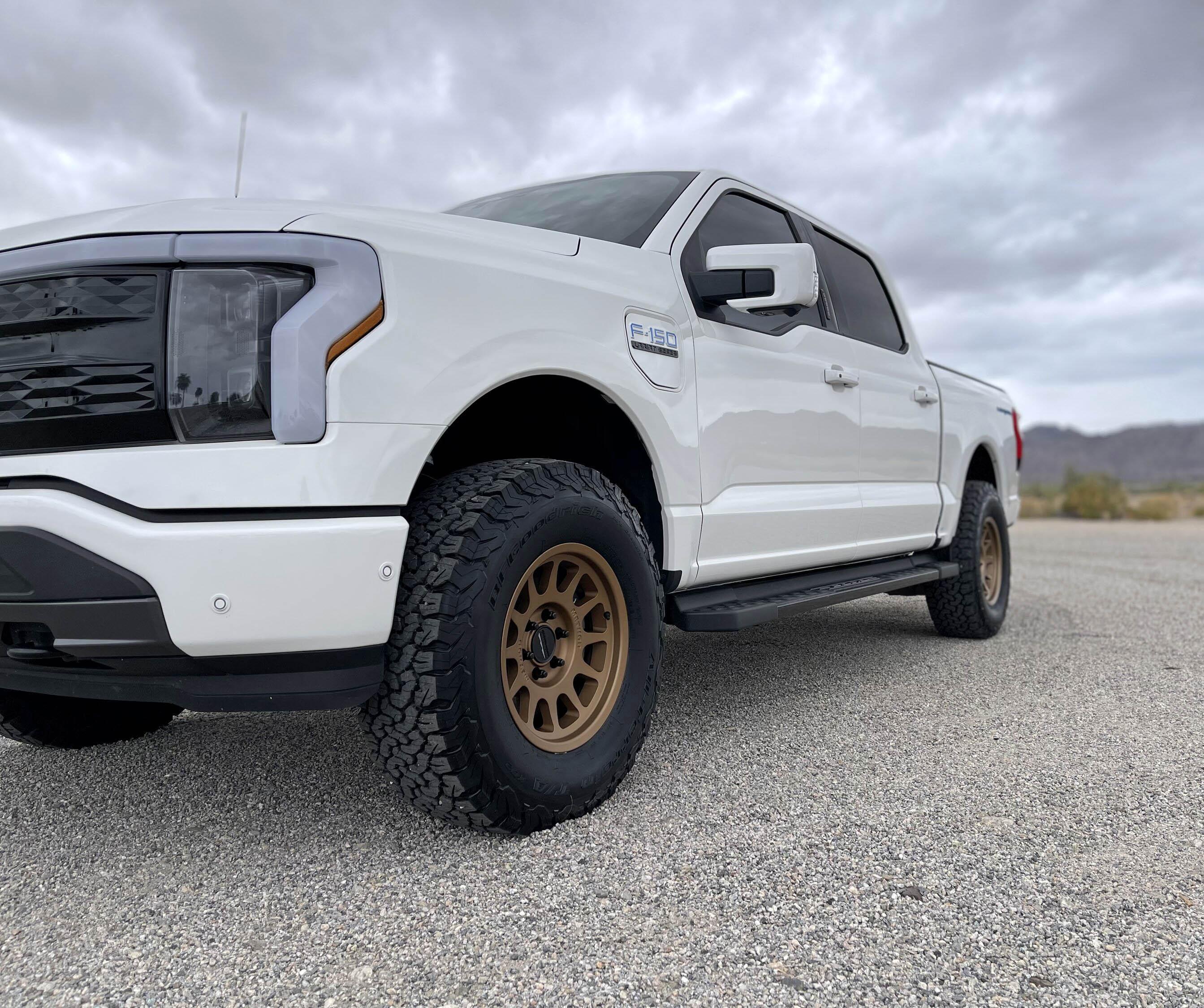

Biggest thing I did to make install easy was not to mess
With the upper control arms. I removed the lower control arms AFTER MARKING THE LOCATION OF THE LOWER CONTROL ARM BOLTS. Then knocked out the tie rod ends to free up some space to wiggle out the suspension components. It was pretty easy to ease them out and back in. Note* the install of the. Stage 3 spacer will result in the coils to be rotated 180* which is by design I was told by the folks at stage 3. installing the lower control arm bolts to the marked location resulted in almost perfect alignment. Almost but a realignment is highly recommended.
I just installed the spacer on the driver side, then couldn’t get the forward lower control arm bolt in the same spot, and after looking at the video again I seen that they added a note in the description saying to swap the driver side with the passenger side so the two bottom bolts and bushing on the strut does not tear or wear too bad, this seems that it should also help with the geometry…. tomorrow i’m undoing what I did on the driver side and swapping the struts from side to side. in the comments of the video from stage 3, people were agreeing that they had bushing issues only 5 months later. tomorrow is a new day lol
Oh wow. Don’t know how I missed that. I didn’t have too much trouble getting the LCA bolts to their factory position but I guess I may be swapping them out as well. Thanks for the info??

what PSI are you running on your new setup? I installed mine and have ~42 PSI now but seems like range may be worser than I anticipated, using a calculator It came up with 36 minimum but at that PSI the tire is lumpy where it meets the ground and looks under inflated
AZT9
AZT9
Feb 6, 2022
607
1,004
Peoria, AZ
I’m actually running 60psi. The tires are max rated to 90 impacting ride a little but it has helped with those highly inefficient treads (damn they are great tires tho)
