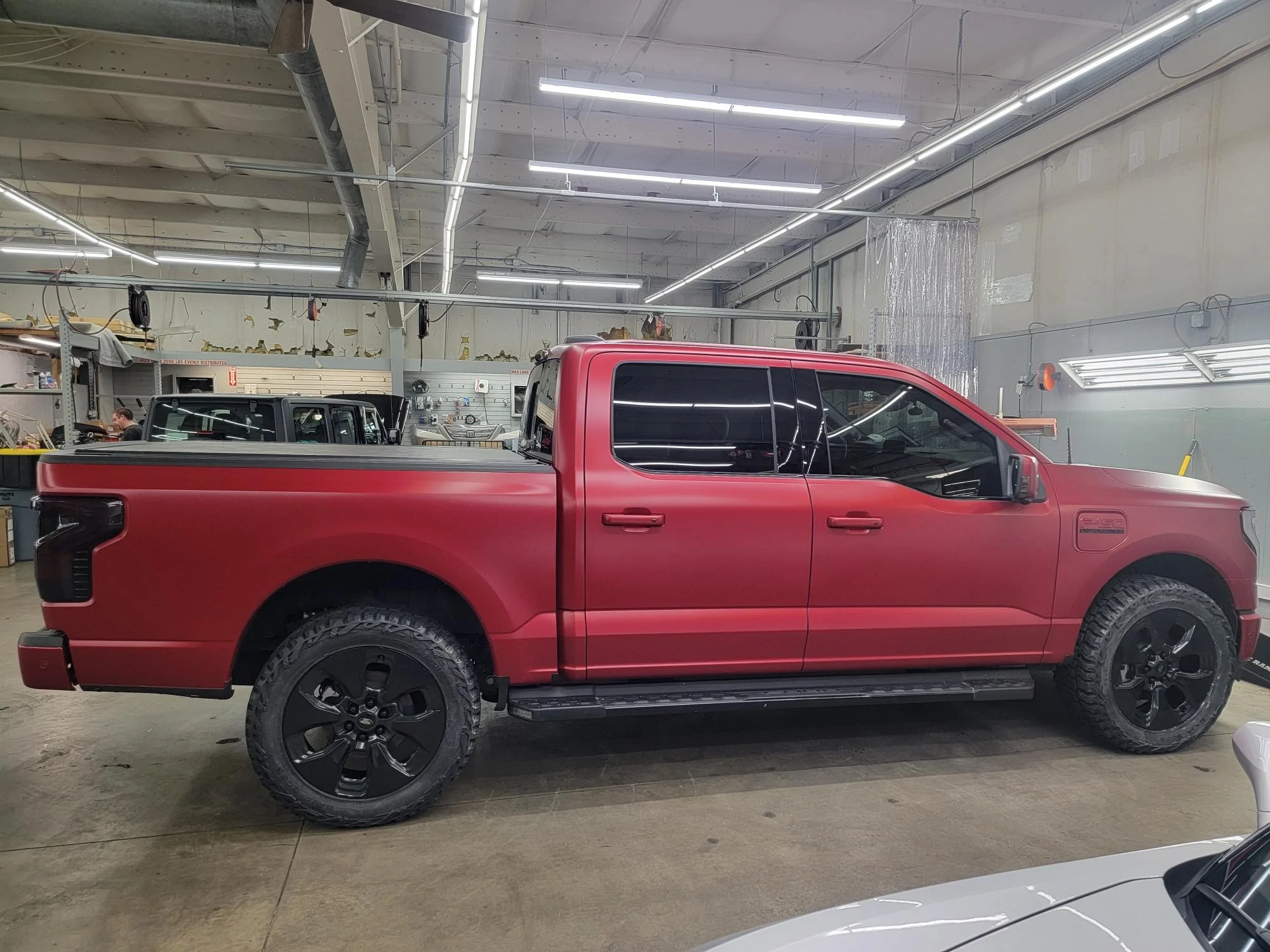

Are those factory offset wheels or did you add a spacer?

You can change the tire size in Forscan if you use it. Then it will be exact. I’m doing the same lift and put larger tires and well - should have it back next week! The tires are already on but waiting for the lift…
I don't have for scan, unfortunately.

he says no rubbing. I did
35" on my old '21 PowerBoost, had no rubbing.
yeah there is some people reporting no rubbing on 35s but I decided to go the safer bet and go a bit smaller. For two reasons rubbing and range not sure the difference in range if I went even bigger than what I have.

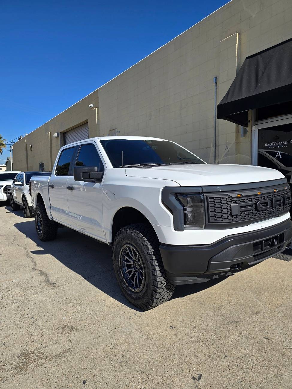

fluiddynamics
Oct 3, 2024
'24 Lightning Pro ; '23 Mach-E GT Performance ; '22 Maverick Hybrid
Construction
It's all about offset.... I have a 3" lift with +1mm offset and same tire size, and I had to trim the lower plastic, and a bit of the backside of the bumper, and just a bit on the crash bars too... Nothing dramatic, but definitely rubs with a different offset
