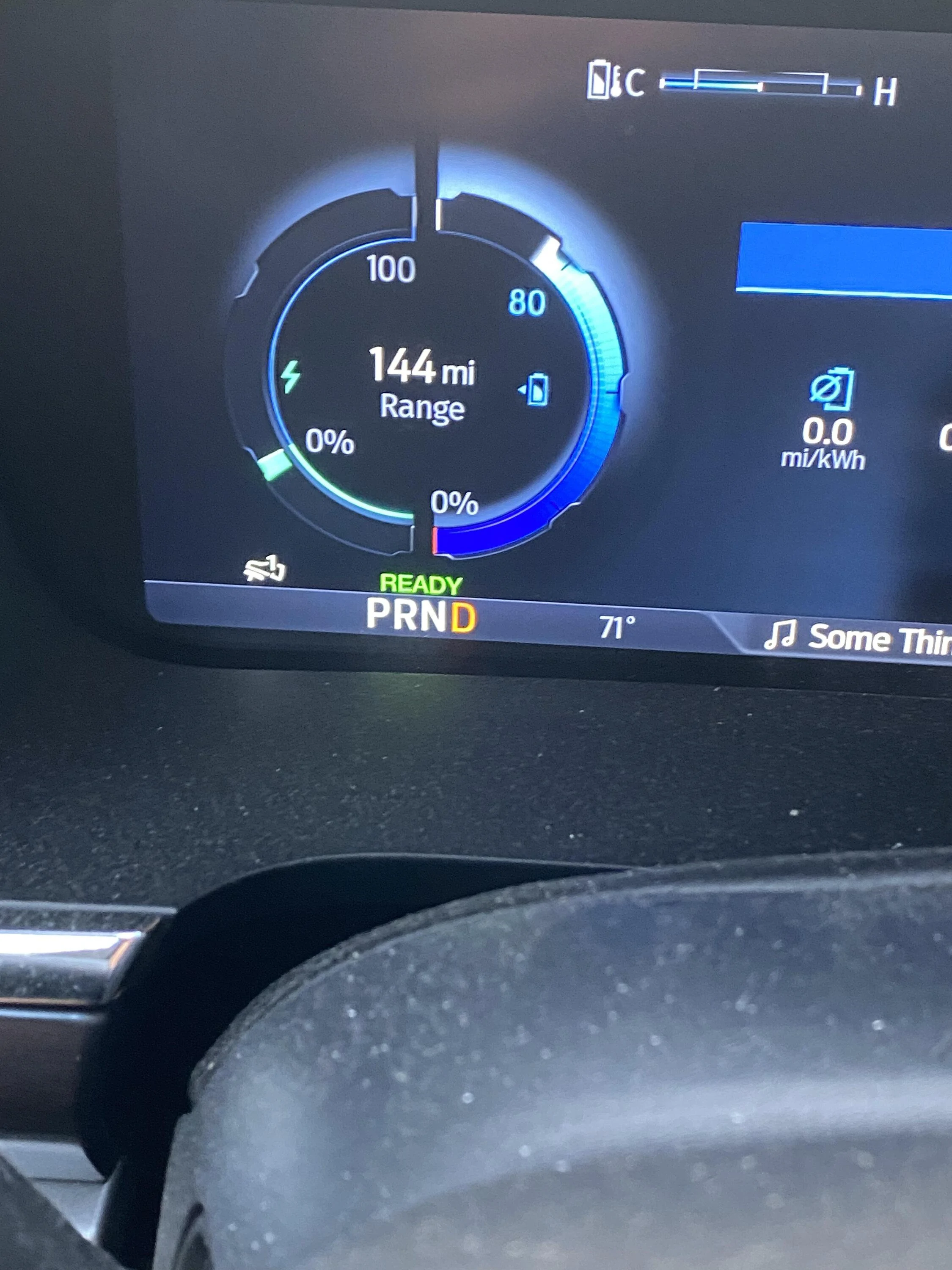

Hi all,
I'm having some issues with the truck as of late. At first the last few days when I would drive it and turn it back on, I'd see something like 10 less miles of range after sitting for an hour. So I'd get to my destination with like 80 miles, turn it back on, and the range shows as 70ish miles. I thought it was weird but figured who knows maybe just a little issue that would work itself out. Last night, I left it on the charger to charge to 80% and I woke up today and unplugged it from the charger and its showing 80% as 140 miles of range??. I only ever charge the car to 80%, I've charged it past that at lvl 3 chargers maybe 5 times over the course of its life. Has anyone experienced anything similar? Will be taking it in to the dealer but I wanted to see if there's another way to get an idea of battery capacity from my end before I do. Thank you!
Also I live in North East USA so the temperature is like 80 degrees F outside so its not a temp related thing.
My truck did essentially the same thing a couple weeks ago. Once I reset my driving history all was good in the world of mileage guessing.
