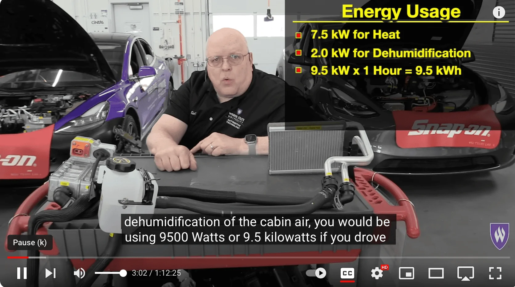

The Lightning uses a PTC heater that takes a very hard knock on the range/battery during cold weather. WeberAuto on YT showed how inefficient these type of heaters are. If you run with your heat on high and also need the A/C for dehumidification, it can use up to 9.5 kW/hr. If the Lightning gets 2.4 miles/kWH, that's about 23 miles of range loss an hour. In your case, ~10 miles of range loss an hour using the heat set at 65F. It would take 3 hours for your trip driving 56mph, so you lost ~30 miles of range using heat. You are getting the stated range for your truck if you averaged 2.1 miles/per kWH.
Ford F-150 Lightning Range issues..... 2023 Ford Lightning Pro SR Screenshot 2024-02-05 at 3.11.32 PM
