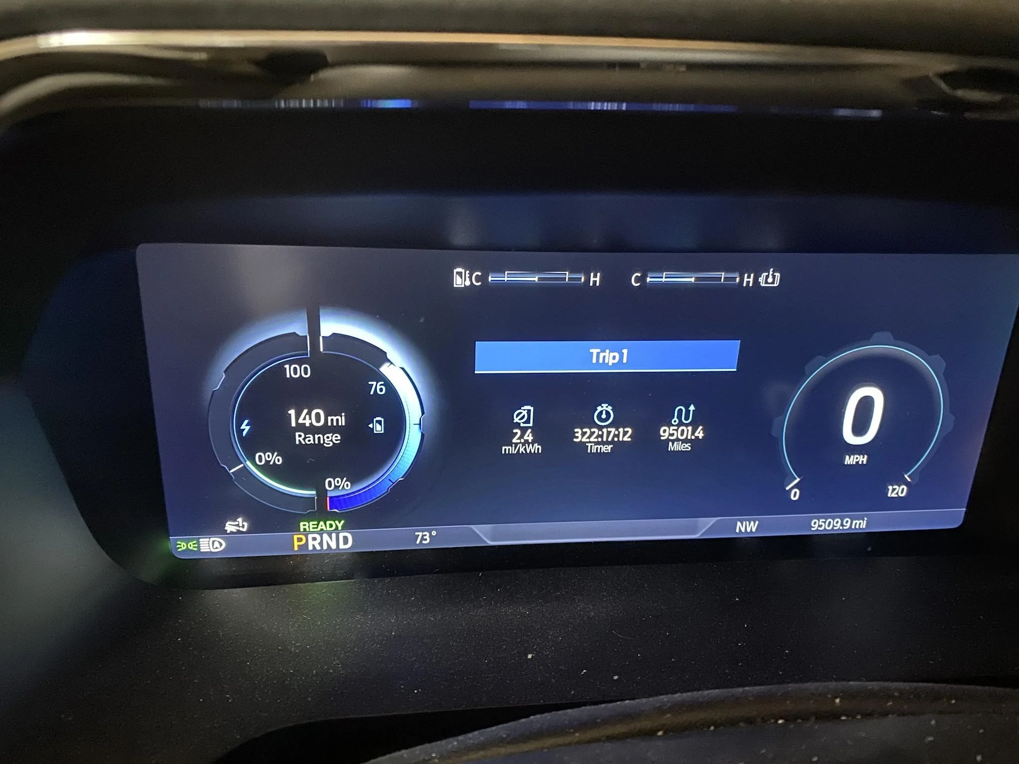

Hi all,
I'm having some issues with the truck as of late. At first the last few days when I would drive it and turn it back on, I'd see something like 10 less miles of range after sitting for an hour. So I'd get to my destination with like 80 miles, turn it back on, and the range shows as 70ish miles. I thought it was weird but figured who knows maybe just a little issue that would work itself out. Last night, I left it on the charger to charge to 80% and I woke up today and unplugged it from the charger and its showing 80% as 140 miles of range??. I only ever charge the car to 80%, I've charged it past that at lvl 3 chargers maybe 5 times over the course of its life. Has anyone experienced anything similar? Will be taking it in to the dealer but I wanted to see if there's another way to get an idea of battery capacity from my end before I do. Thank you!
Also I live in North East USA so the temperature is like 80 degrees F outside so its not a temp related thing.
Since you have the SR battery pack (~100kWh), and the software update that shows numeric SOC fulltime, simply multiply displayed SOC x 2, and that’s your range (reasonable approximation). If you’re planning to drive mostly 75mph, subtract 10% from that range. If you’re planning to drive mostly below 50mph, add 10% to that range. Easy mental arithmetic.
No GOM needed. Range is determined from SOC, and I bet you can do that better than the GOM.

Have you recorded what your consumed percentage was on a few trips? As somebody else mentioned, because it's an SR, the math is really easy to check. Write down battery percent at beginning of trip, then divide miles driven by battery percent consumed at the end. You should get something better than 2 for most trips. If not, then something might be wrong.

This is what it looks like over the full 9500 miles. It's been fine up until like two weeks ago so I'm wondering what lead to the huge discrepency

No trailer profile, never towed anything with the truck. It's been super accurate in the past with giving me a range of like 190-200 when at 80% and so I'm not sure why the drop all of a sudden. Nothing has changed about my driving or anything but yesterday I ended up at 10 miles on the GOM even though I should've been closer to the 50 mile range based on distance driven.
Even if you've never towed, you might double check if there's an active trailer selected.
Aside from that, I would suggest charging it up to 100% one time to see if that triggers some recalibration. That has worked for me in the past.
It may show low than expected range but at least you got the update to show your % of battery..... I still haven't got that update 😂
3,814
4,922
So you show 2.4 MPK for life. What’s your MPK now?

He's already done that. I've been thinking about this. Try selecting the default trailer. See if the GOM changes then select no trailer.
I keep coming back to the trailer thing because that is what the GOM does when you select a trailer.

Your lifetime efficiency doesn't tell us anything about recent behavior. Even just looking at the "Current Trip" view would be more useful. I'd still recommend trying my suggestion to calculate miles per reported battery percentage. The only other DIY thing that would be useful would be to buy or find somebody with the scan tool that can report battery health.
