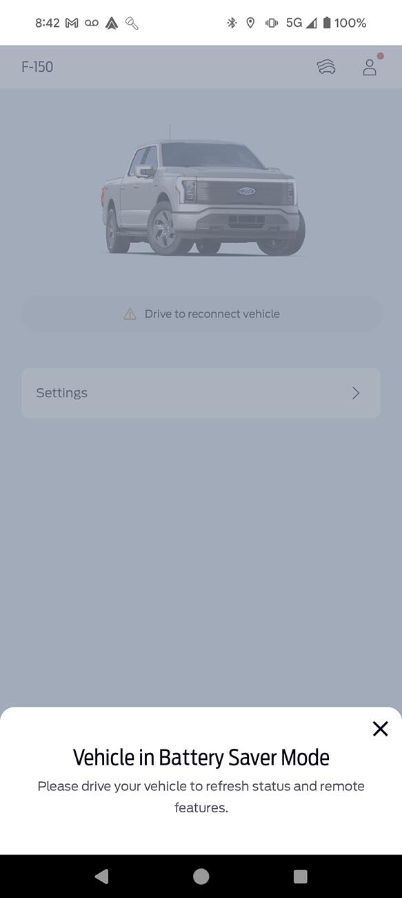

So, after trickle charging overnight, truck turned on and drove fine this morning! A small glitch regarding the app (pic attached) that resolved itself pretty quick. Drove home and plugged Er in.
The whole thing is still odd to me...

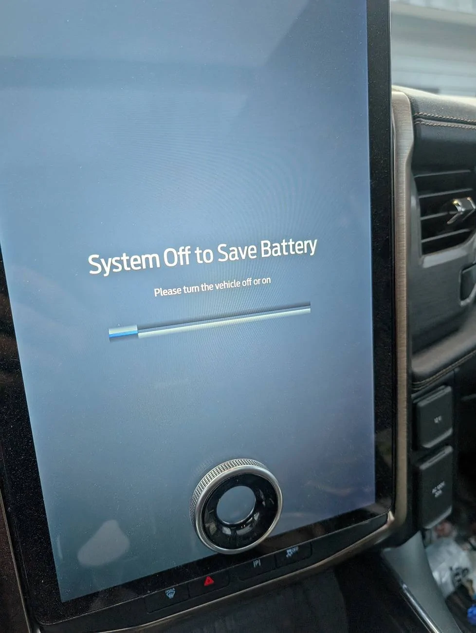

Charged for a few hours and out at work. Made a stop and main screen indicates "system off to save power".
Still no error alerts on dash screen on app.
I'm guessing the 12v battery is not in great condition?

Curious of the DC/DC inverter is not performing to specifications!?
