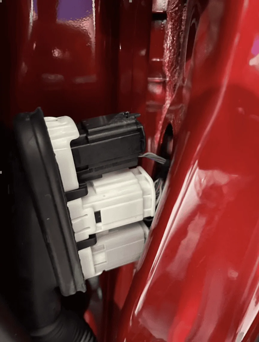

It looks like we have resolved the issue. Ford sent someone to the dealership today to take a look at the truck. It turns out one of the connectors in the driver side front door was not fully seated ; this is why the truck was not reliably getting confirmation the door was closed.
The truck is coming home today after which I am going to run it through it's paces for a while.
@rtk11226 you might want to have them take a look at the connectors here if your truck has more fits.

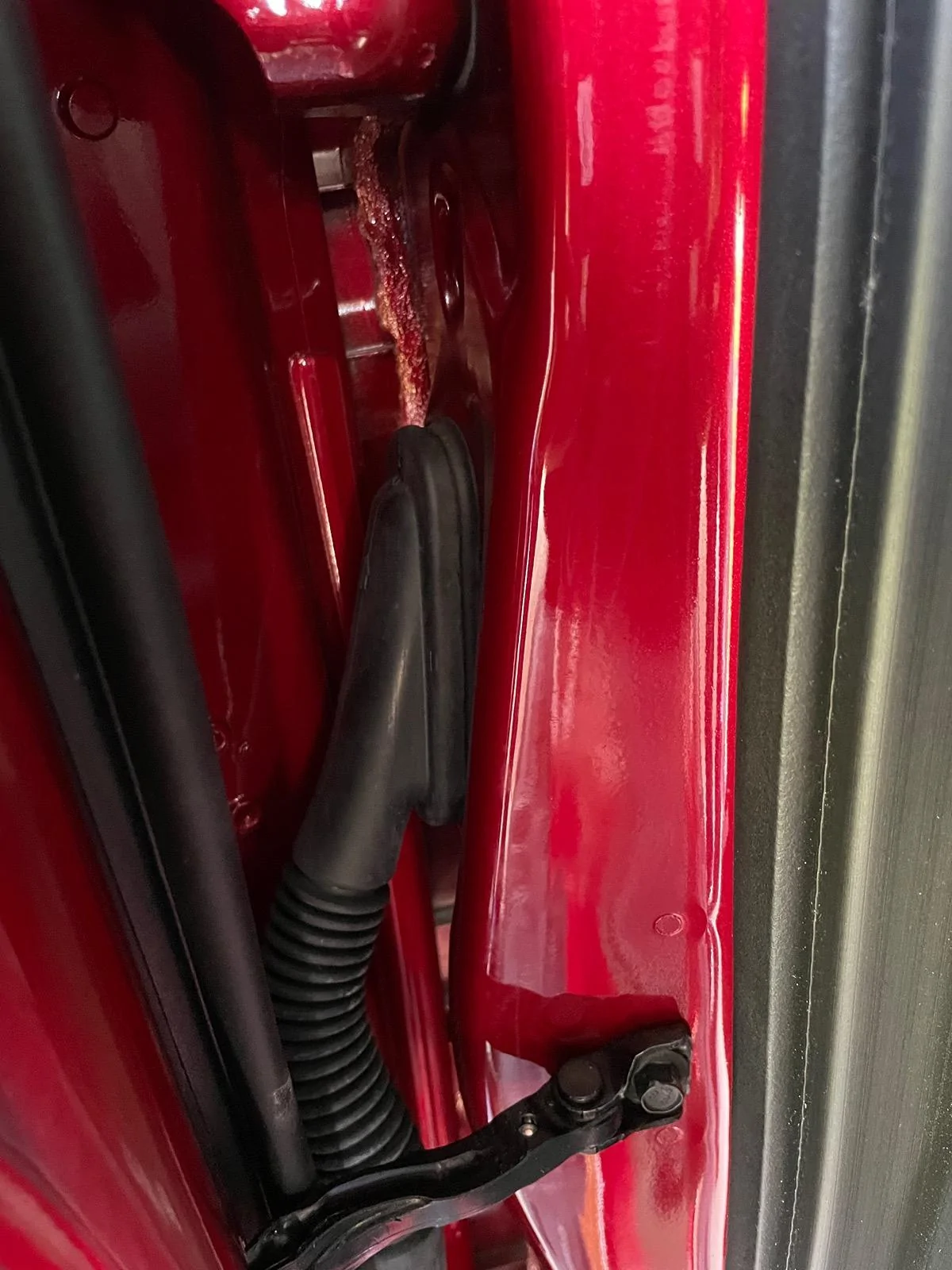

I found it curious that the rubber conduit in the driver door sits the way it does after the repair though. I'll get a picture in a little while but basically in the picture in my last post the flare at the end of the rubber sits somewhat firmly against the metal. It seems like there's a potential opportunity for water ingress there.
Can someone take a picture of their truck in that area and share? I hope they didn't accidentally skip an assembly step again.

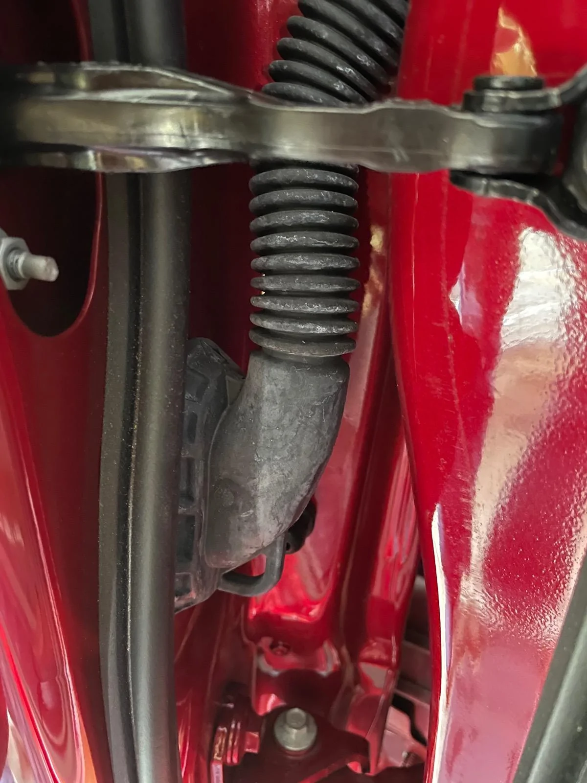

Seems the rubber fittings are tightly inserted at both ends of the conduit. They are not just sitting up against the metal.
Edit: Iā€™ll try again to get a good photo.

Ford F-150 Lightning Uncommanded Parking Brake Activation IMG_1994
Ford F-150 Lightning Uncommanded Parking Brake Activation IMG_1995

That's what mine looks like also. Excellent, thank you @The Weatherman
