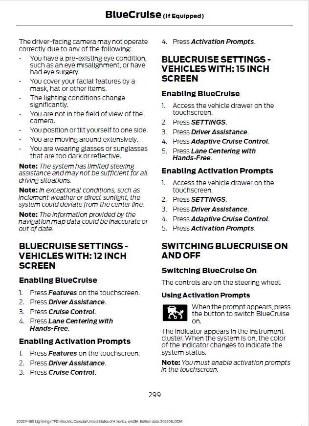

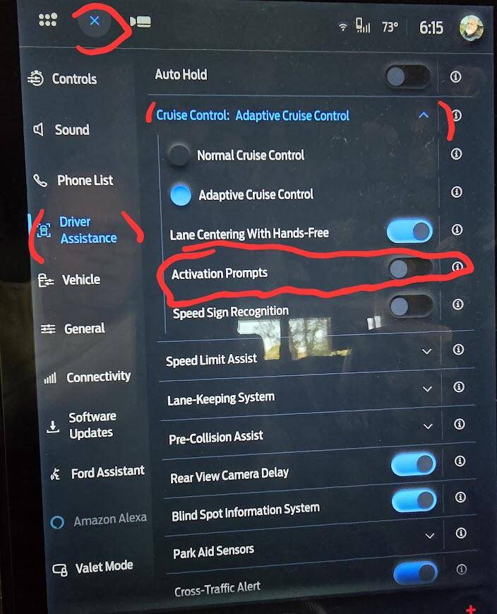

Yes there is a way, dig into the menus.
Ford F-150 Lightning Turn off BlueCruise pop up 1745878716884-jl

Ford F-150 Lightning Turn off BlueCruise pop up 1745879118241-vl
191
14,309
15,553
I had mine off as you show in the menus @TaxmanHog ... still constantly got the prompt to activate it after getting updated to 1.4
That would be a BUG which .... for those who are experiencing it, should file a FEEDBACK report in SYNC.

One other thing comes to mind, make sure the correct driver profile is loaded, if by chance the default / generic profile loads instead of your personalized version, possibly this selection might be affected, I haven't confirmed this theory.
